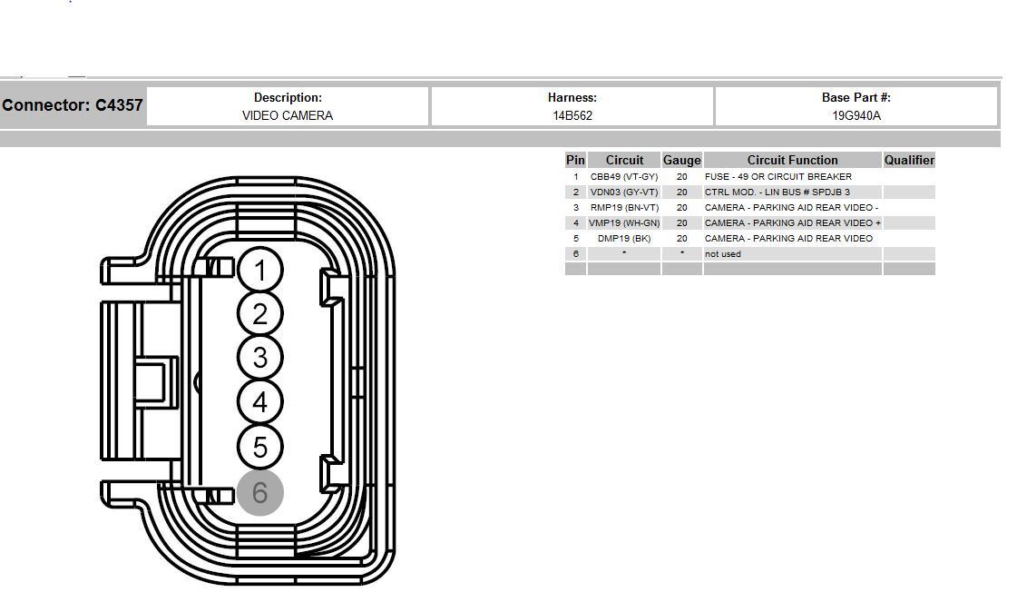

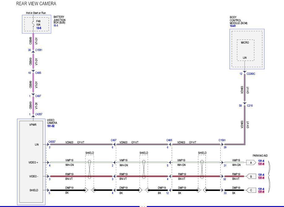

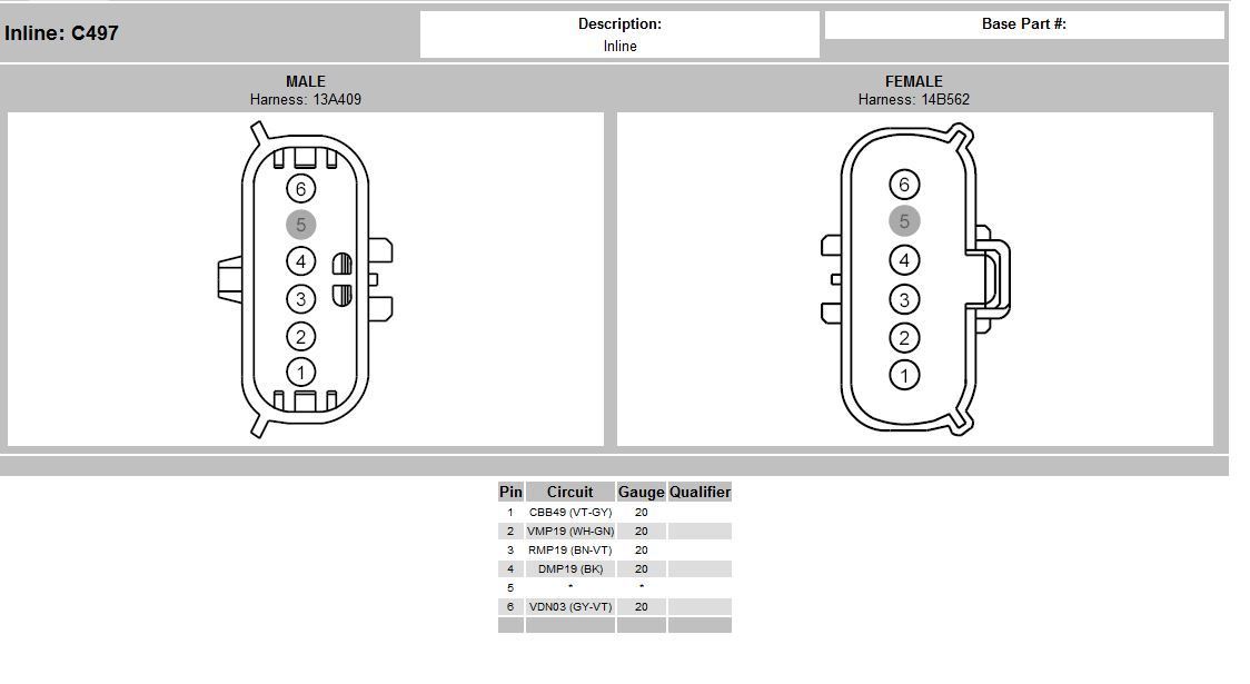

I recently had my tailgate stolen from my 2013 F250 King Ranch. I found and purchased a tailgate; however, it was came off of a 2012 F250. The camera location and harness are not the same. I have purchased all the components for this except the correct harness, DC3Z 14A412-A. The tailgate is painted and installed upon my truck.
I have had no luck finding this harness. Upon contacting Ford to try to get the connectors so I could build my own. They pointed me to a connector 9U2Z-14S411-NA which they claim is the connector coming from my truck. I haven't been able to verify this nor get anything from the camera itself. EC3Z-19G490-A
My question is: Where can one purchase the original DC3Z 14A412-A harness? If I can't purchase this anymore, what component do I need to purchase to build my own harness to fit this truck?

The camera has a new part number - GC3Z-19G490-B
the tailgate harness is FC3Z-14A412-A
Check White Bear Lake online
https://parts.autonationfordwhitebea...OC1kaWVzZWw%3D
