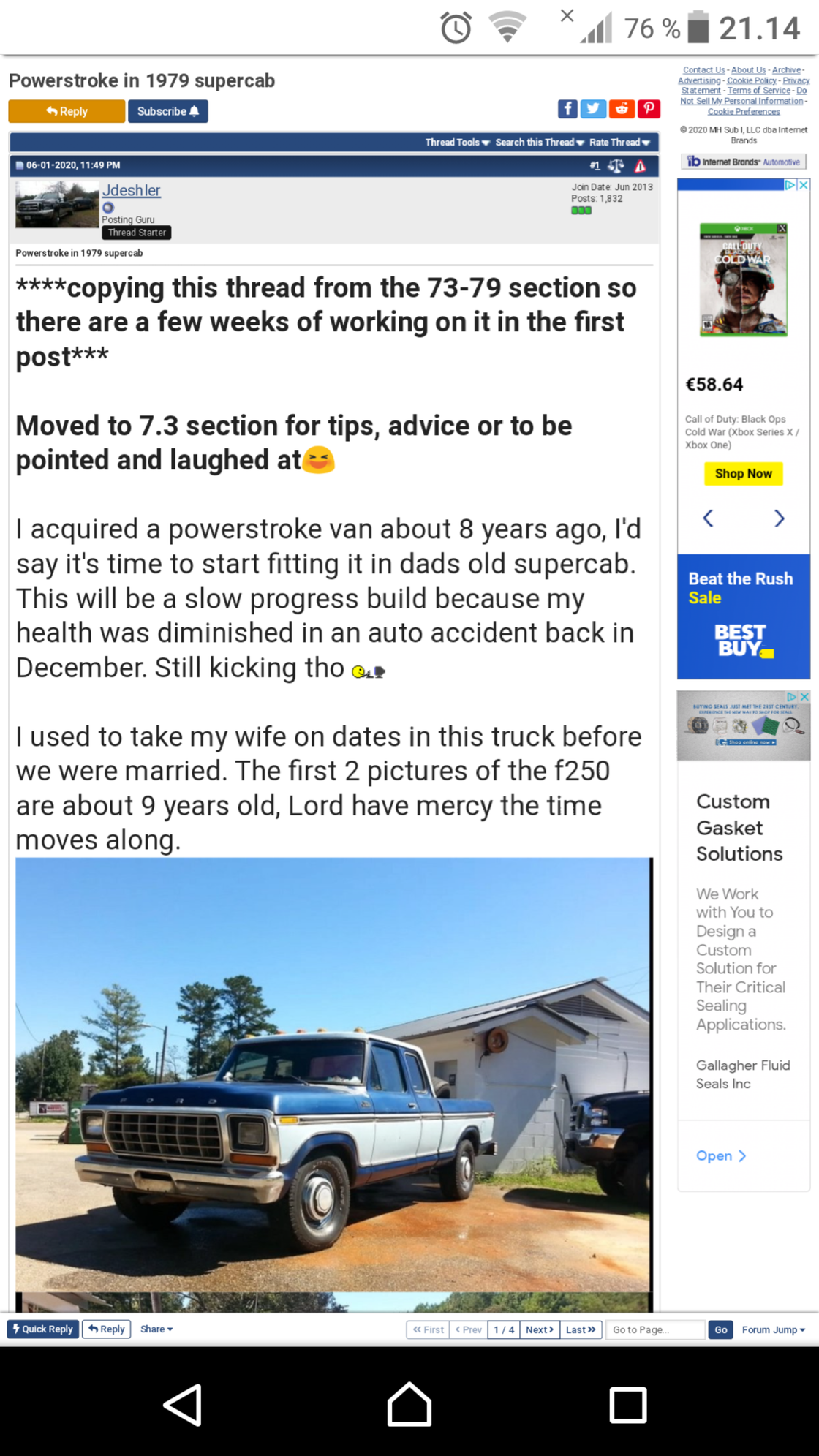

User Jdeshler is swapping 7.3 PSD in to 1979 around here..
