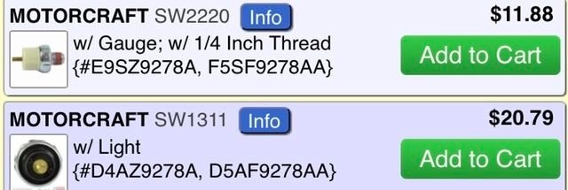

Oh, and the oil pressure is jumping in the wrong direction because i replaced the sensor for one used for a warning light

I take it the parts guy gave you the wrong part. There is a difference
