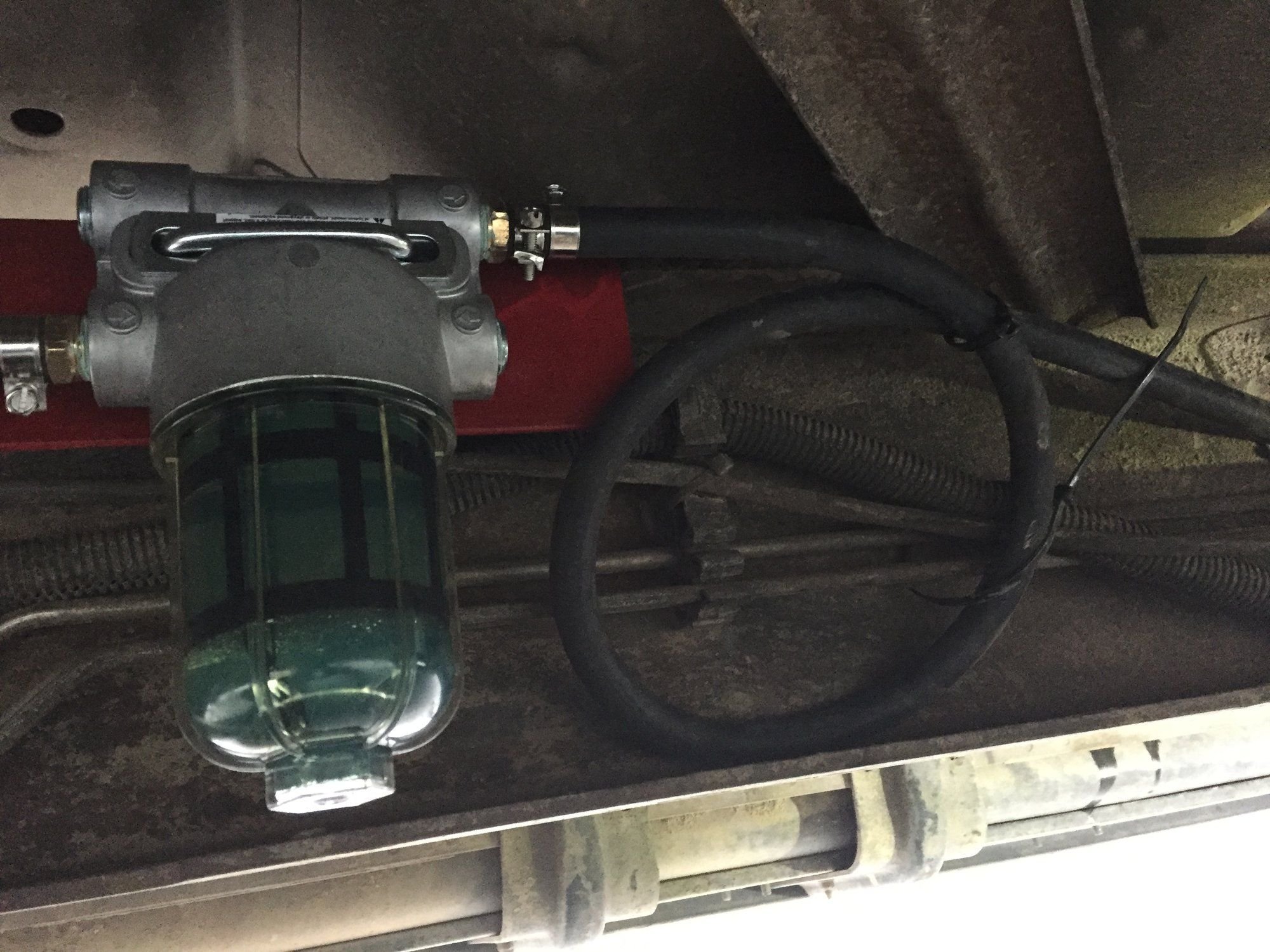

The video explains the mods. The pics below show the Racor filter I installed in place of the in tank screens. If you have any other questions about that just let me know. Sounds like, fingers crossed, you still have a crap ton of air in the system... until you get some miles on the injectors I would drive the truck. At least at that point we can eliminate Air as being the problem...
The bracket I made for the Racor filter
