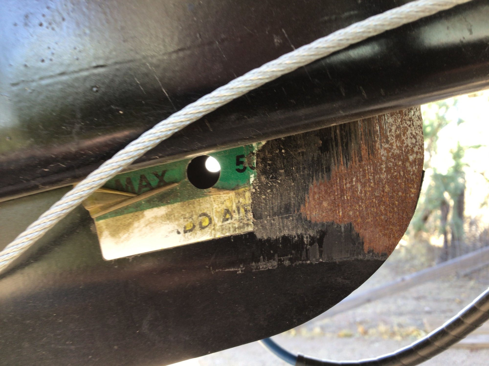

Center up the green indicator with the edge of the outer part
EZ.
And when the sticker wears away, just use center of the little hole.
