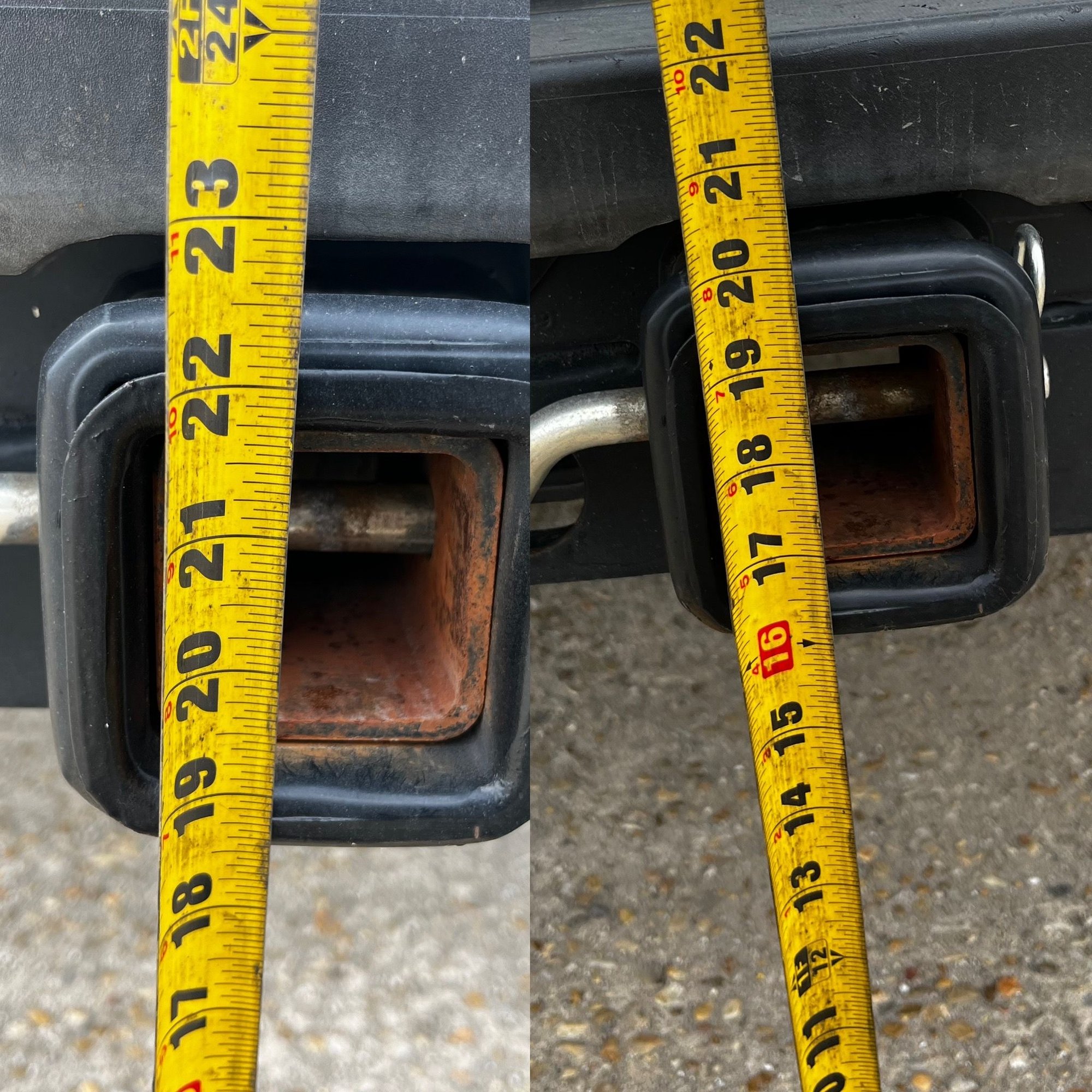

Poor mans reverse level.
I finally got the time to reverse leveled my truck today. I did it the cheapest way I could 😅.
I work at a machine shop and machined me some 1” long heavy duty stainless washers with a 5/8 through hole to take up the extra length I would now have on the U bolts. I also have an Air Lift set of helper bags.
The whole process (short version):
All I had to do was loosen all the bolts to the helper bags. Remove the U bolt nuts and slide out my 2” blocks. Slide on my heavy duty washers and reinstall the nuts and tighten everything back up. The Air Lift kit has a radius cut out on the bottom of the bag pedestal that normally rests on the 2” block tang that matches the radius of the axle tube.
Now for the detailed version for anybody interested:
After blocking up the truck loosen all the helper bag bolts. Put a jack under the rear diff and completely removed the U bolt nuts. Lower the whole axle with the jack under the diff until you can slide out the 2” blocks. Lift the rear axle back up after removing the blocks until you can slide the lower plate for the U bolts back on. Slide on the heavy duty washers and start the U bolt nuts. Lift the axle up close to the bottom of the leaf springs. Use another jack under the front of the diff to get the correct angle for the **** on the bottom of the leaf springs to drop back into the location hole on axle mount. Tighten up the U bolt nuts to the torque spec (90ft lbs from what I have read) no lubrication in the threads. Tighten vertical bolts on the airbag mounts first to make sure they seat on the axle tube correctly. Tighten the U bolts that hold the airbag mount against the leaf springs and drop the truck back down.
