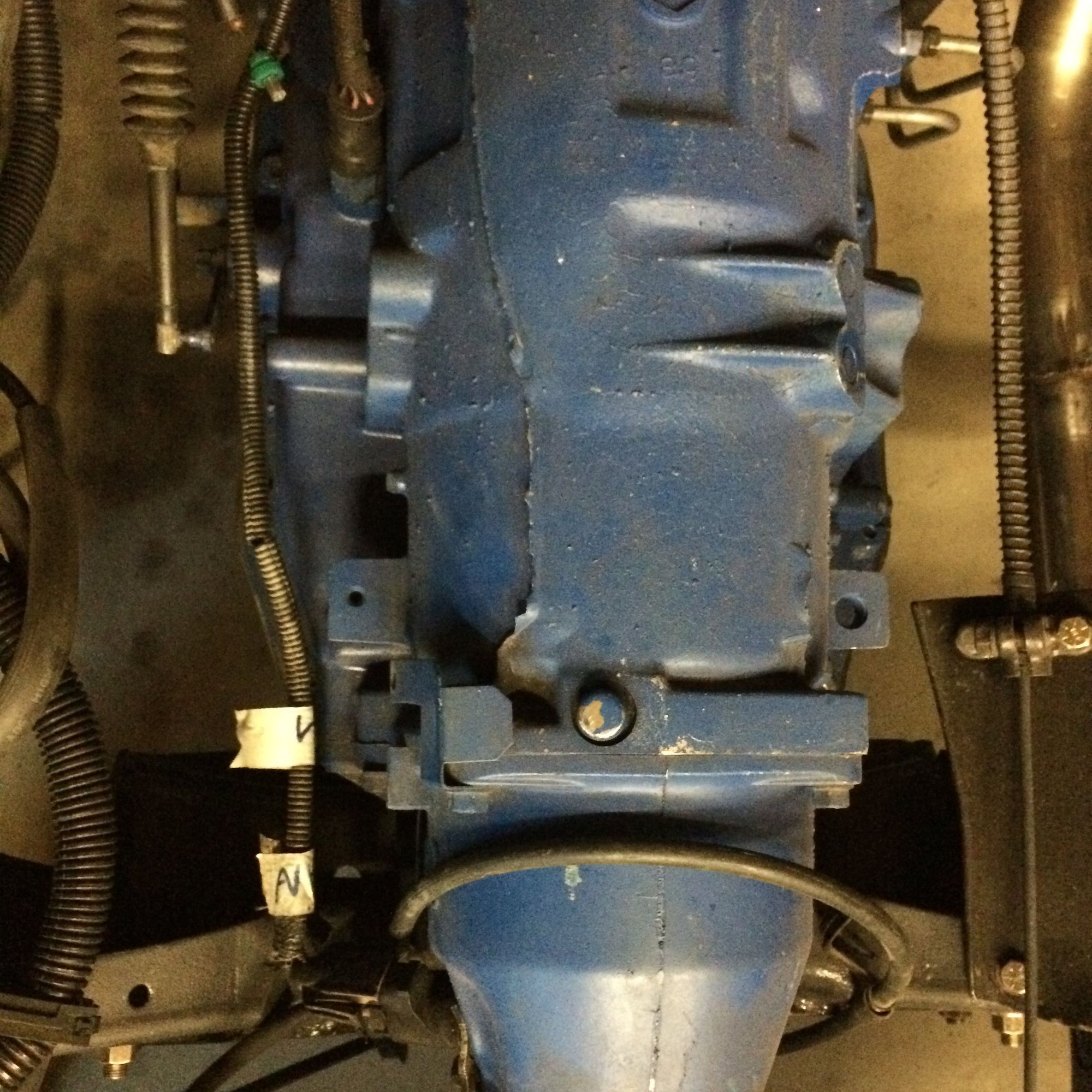

Hey Roy,
It's been a while since we upgraded our AOD.... I really liked the information
from Baumann Electronic Controls... They recommend the AODE transmissions
for most applications now.
We bought a 2 inch Kevlar Overdrive Band for our's along with an upgraded
clutch pack.

Hey Roy
i'm not sure what our AOD came from... We got it from a shop.
There are (3) different flavors of AOD - You want the one with the 2 inch overdrive band.
Getting the pressure right on that cable is tricky. I'd be careful there.
Ben in Austin
1950 F1 (351W/AOD)
