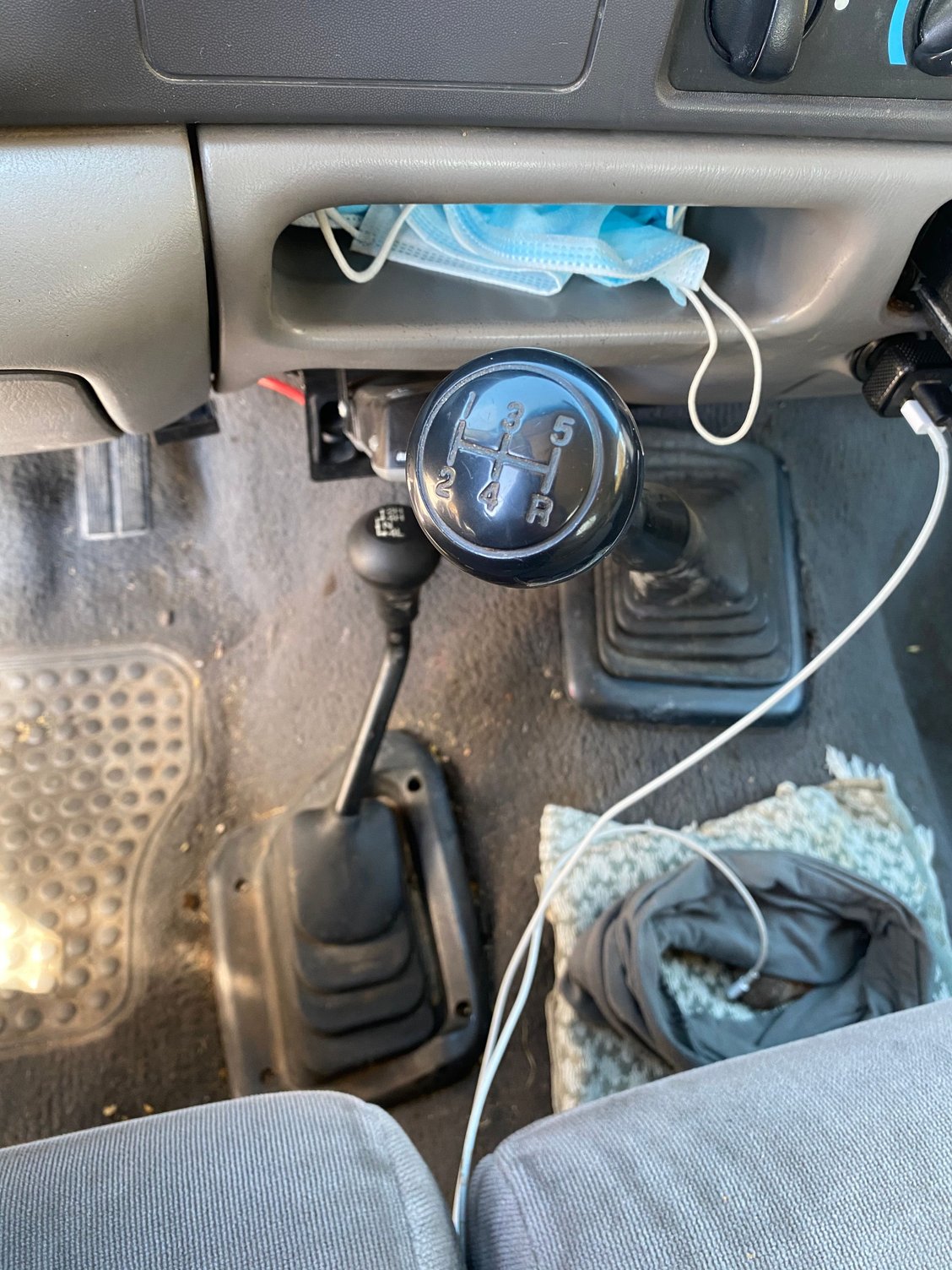

Superduty never came with zf5.
the zf6's shifter labeled L then 1-5 caused the confusion.

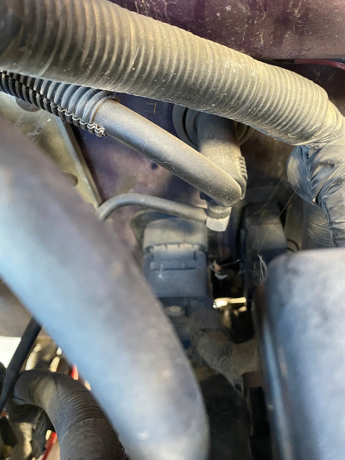

if they swapped a zf5 in, I would start by posting pictures of the clutch hydraulics you have then compare to what the zf6 trucks have.

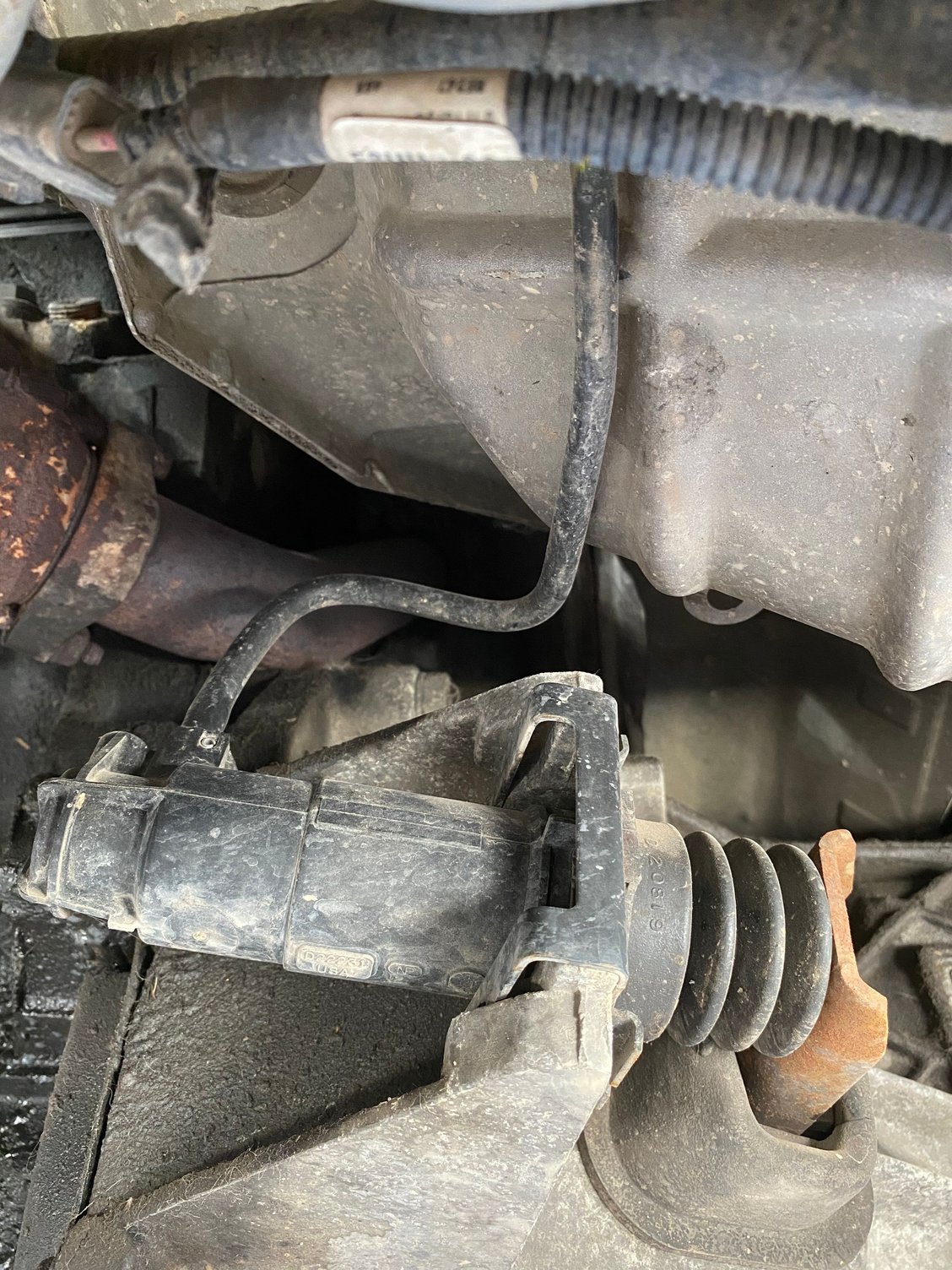

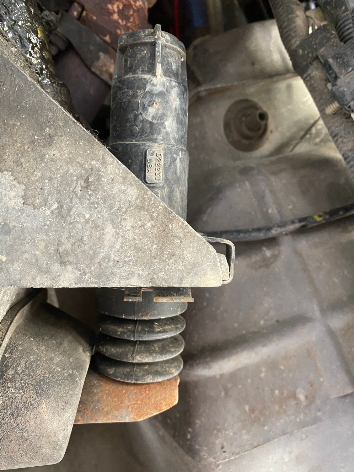

Thanks Ipzd. Here’s some pics. Hope this helps let me know if I need to take more.

That is, in fact a 5-speed based on the slave cylinder and bellhousing bracket.
Wow....
The 6-speeds were not "internal" though. They were also external but locked into the bellhousing from behind and pushed forward on the clutch fork instead of pivoting.

Thanks for the help everyone. The reservoir is attached to a hose and mounted up on the firewall.
comparing on rock auto it looks like I have the ZF6 master and a ZF5 slave. That said I could probably piece one together I just hate the thought trying to bleed it.

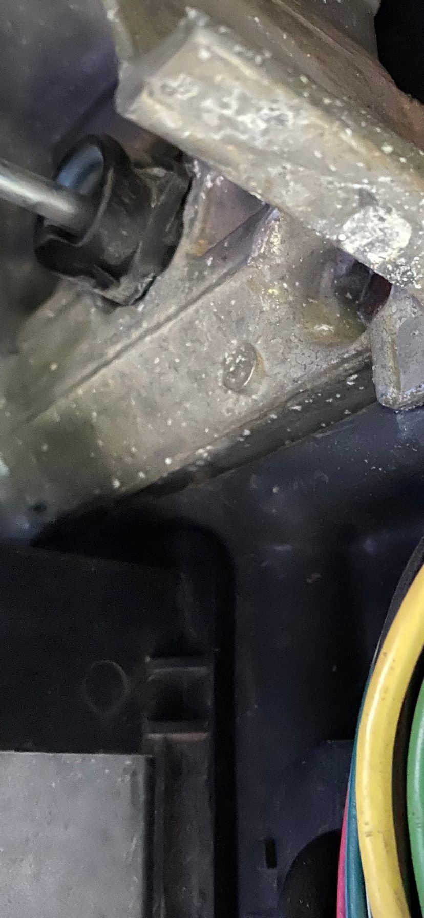

This is how the master attaches to the fire wall..

Does it twist lock for the slave as well?

Look at the last picture in post #3. No.
