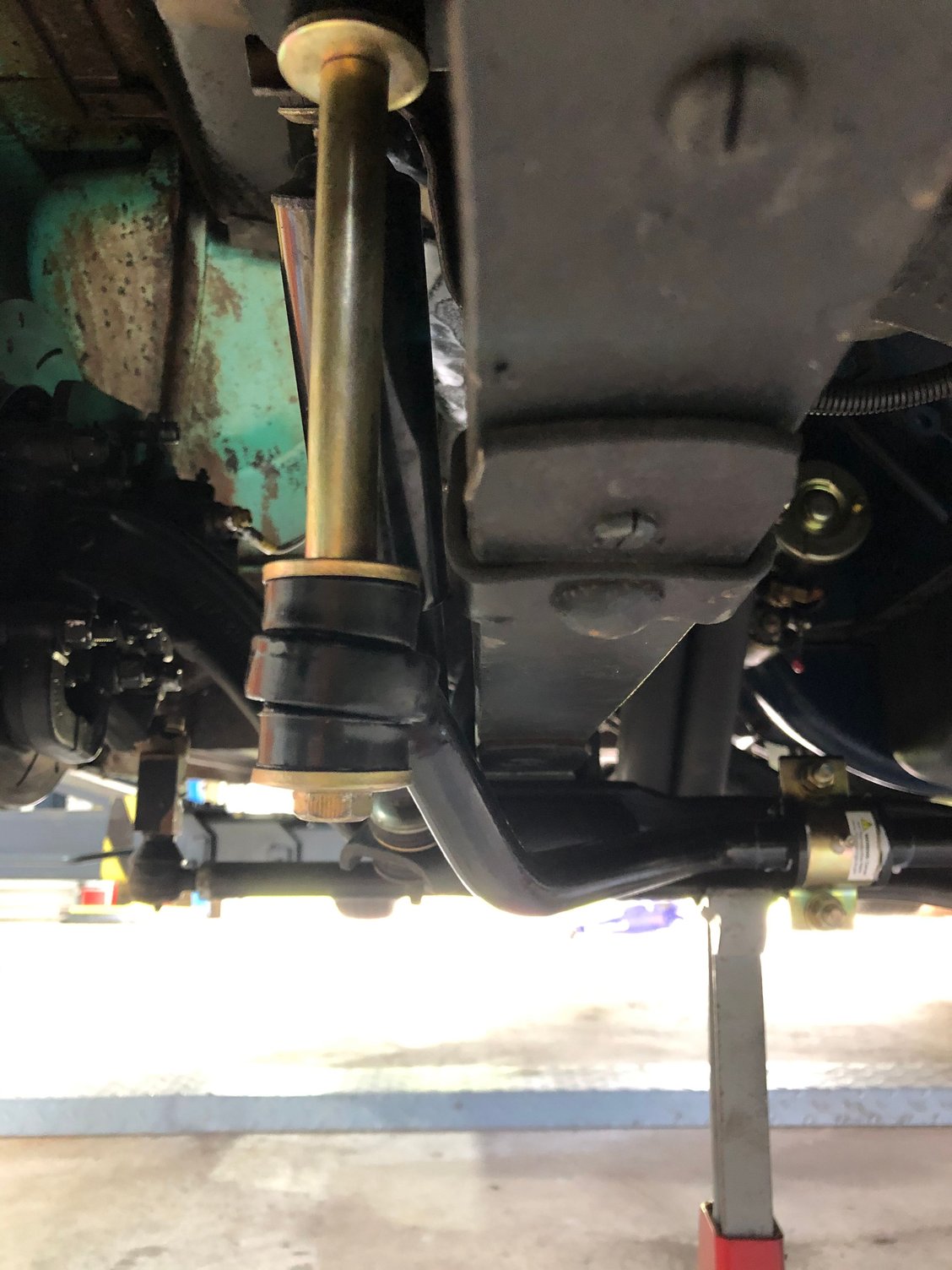

I received my CPP sway bar today and installed it in the Front of my truck. I’ll cut straight to the point....
The truck drove and handled better in every single way!!!!! It was really a huge improvement and I’m stoked! The truck drove straighter, cornered smoother, held its line on the bends, held a nice straight line at highway speeds and just made me feel a lot more confident and comfortable driving the truck!!!! I also noticed that under heavy braking it stayed in a straight line rather than slightly veering to one side. I gave the truck a good work out and pushed it hard into corners on some windy highway roads and also narrow rough roads. My double adjustable Viking shocks are still in the post so I am expecting even more improvements once I fit and tune them!
on a side note- I installed 4deg caster wedges (3 inch dropped axle) last week and it also improved drivability, but I did have to get new spring pack/axle locating bolds made. See pics at bottom of post. Total caster is now +5 deg.
A few comments on the install-

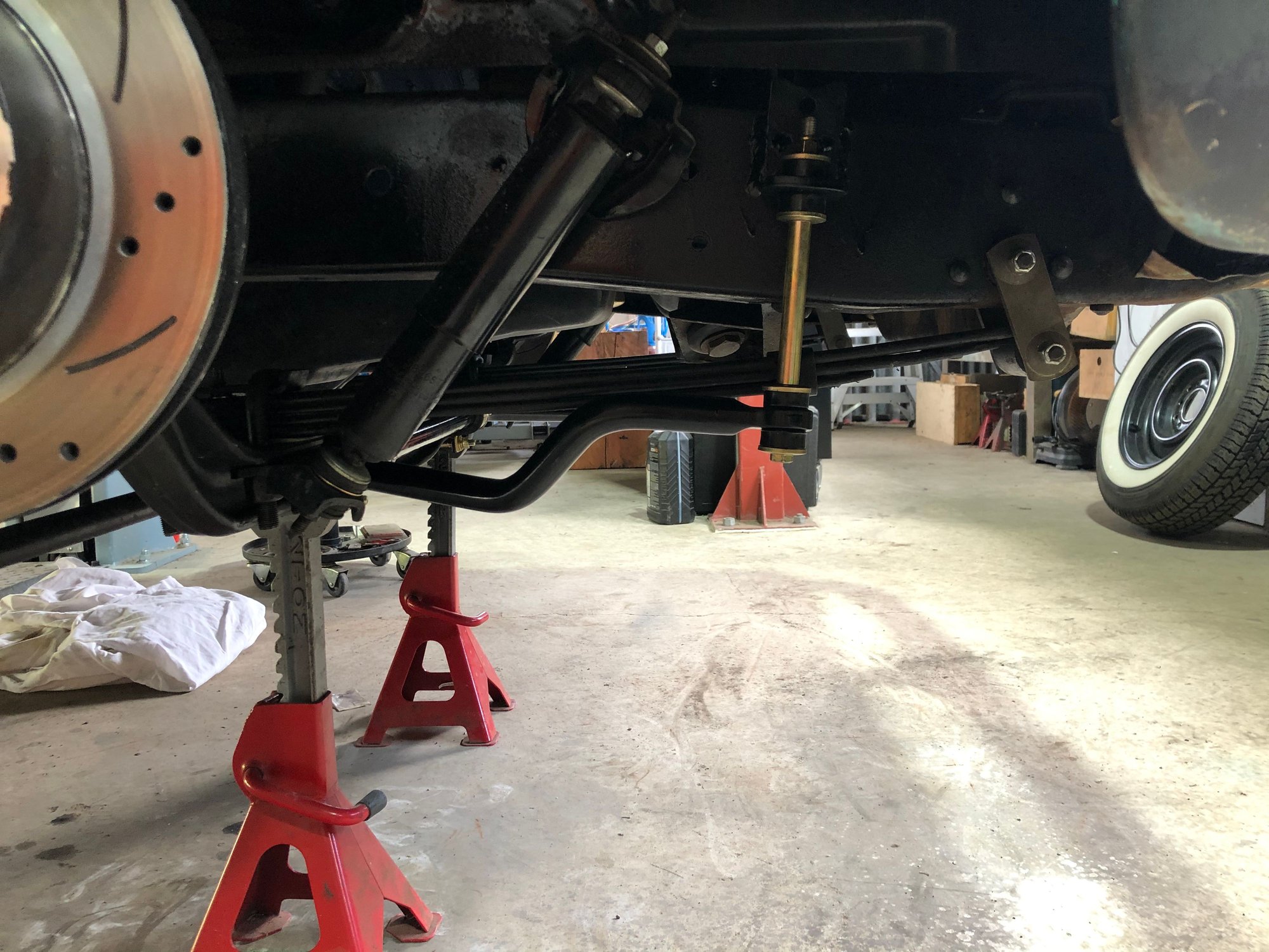

This sway bar is for 55-59 Chevy and 53-56 F100. Since the 56 and 59 f100 share the same 34 inch frame width and similar spring set up, I figured that it should work. The sway bar could be 1” wider overall as there wasn’t enough clearance between the sway bar ends and the leaf springs and also the link ends and leaf springs. Because there wasn’t enough clearance between the sway bar ends and the leaf springs I had to install the bar ends -7 down. The instructions are pretty much useless.
On my truck with a 3” dropped axle and 2 leaf removed, the link end brackets landed right on one of the chassis crossmembers which made it difficult to drill and bolt so I just welded them on.
This install worked ok for me but I would advise anyone to do their research when looking for a suitable sway bar. This probably wouldn’t work on a stock truck.
I would like to see a 56 install to see how the clearances look.

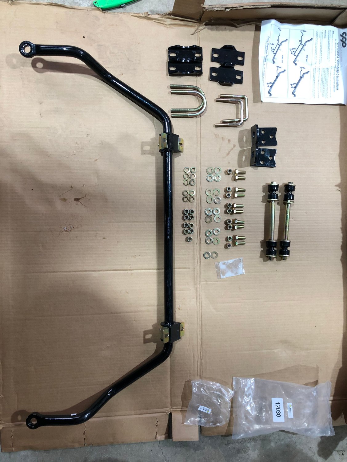

Plenty of gear supplied and they provide what looks like silicone grease to lube the sway bar bushings- there are also grease nipples for future maintenance greasing.
CPP provide axle u bolts for both I beam and round tubular axles

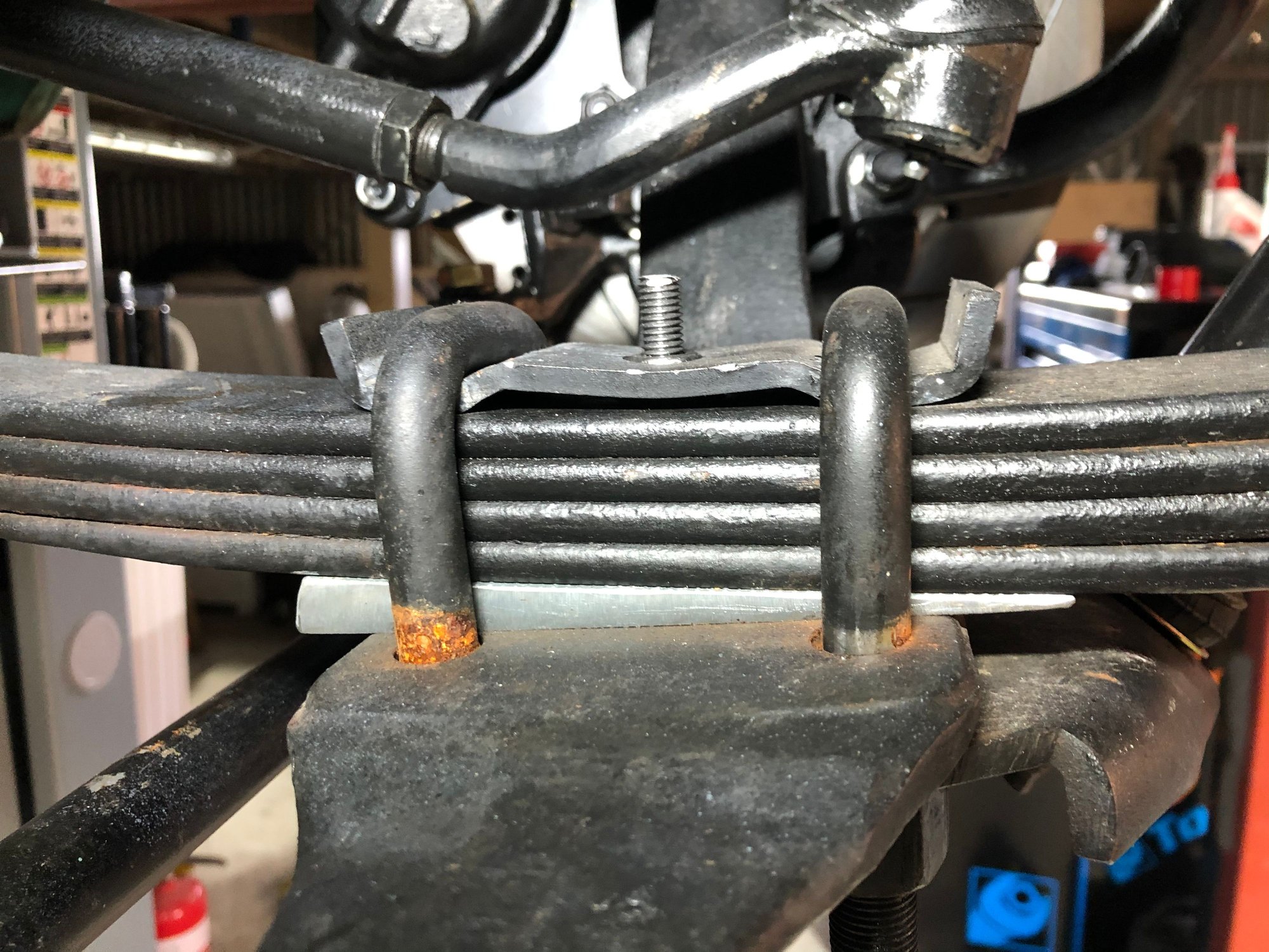

bolted up to the I beam axle
about 1/4 inch clearance between spring and bar end. Would be a lot better if there was an additional 1/2 inch clearance
same 1/4 inch clearance between link end and spring. You can see the bar end is angled in slightly.
Drivers side same clearance.
bar ends are -7 down when at ride height. This was a compromise to keep the clearances around the springs
all bolted up and ready for the test drive

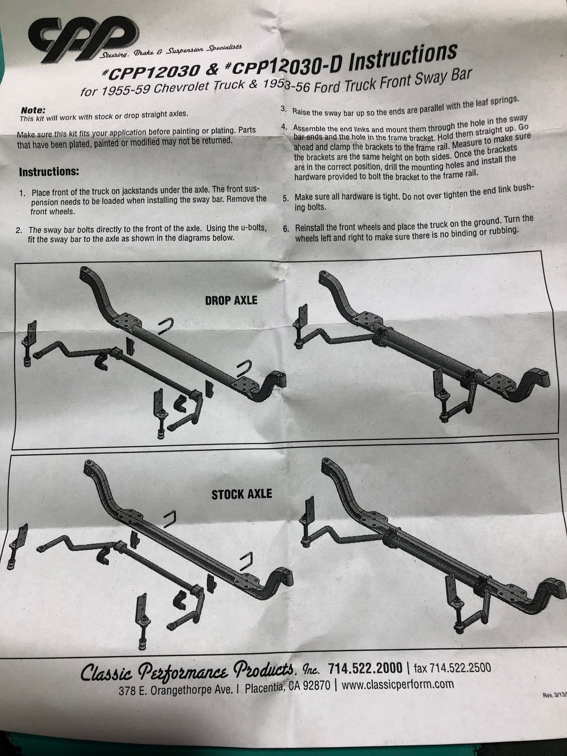

Instruction
Note on instructions says- will work with dropped axles.

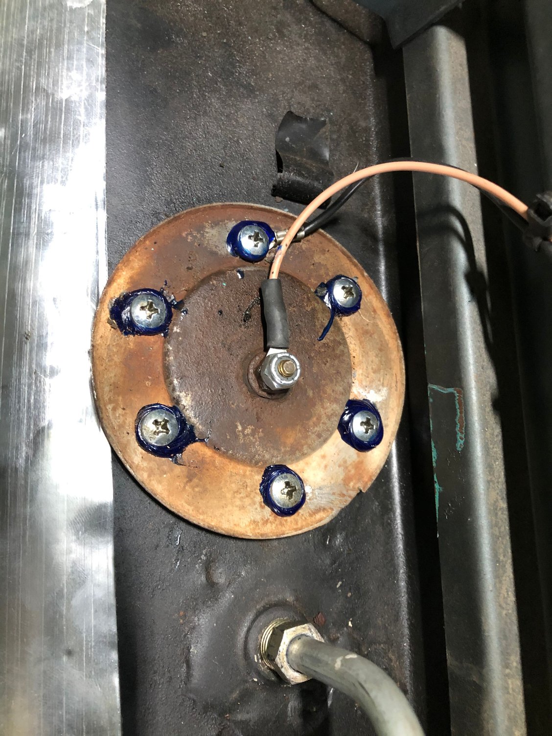

last but not least- fuel has been leaking out of the gas sender screw holes and fuming me out so I used some permatex fuel resistant gasket dressing. Worked like a charm! Got some good progress today😁
