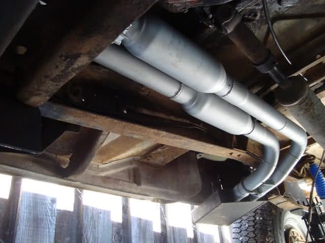

Maybe this will help?
Headers and cross member interference...no problem.

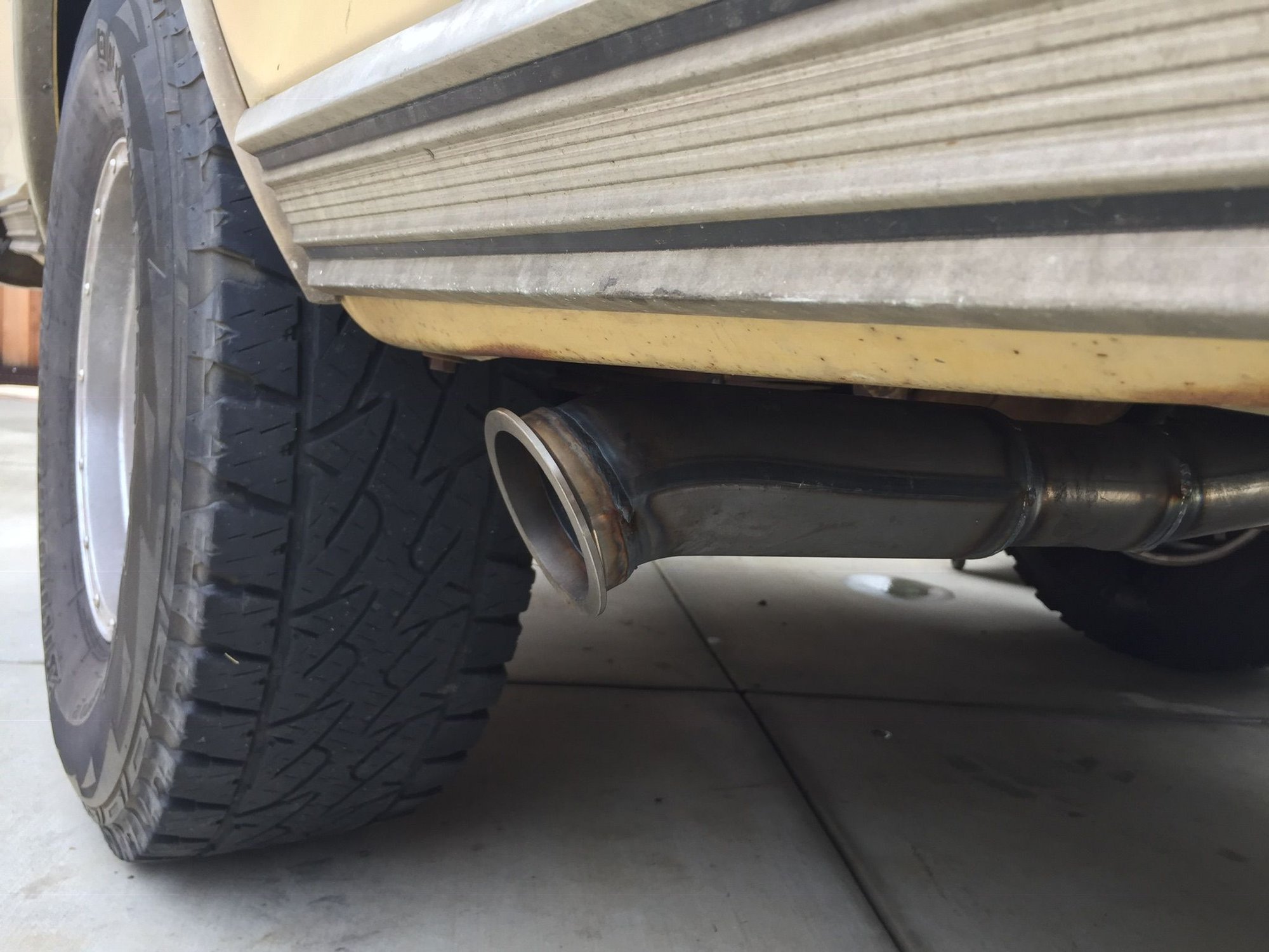

A view from the outside? Here is a clean set up.

yes like that thank you hoping it will lokk good on lowered truck

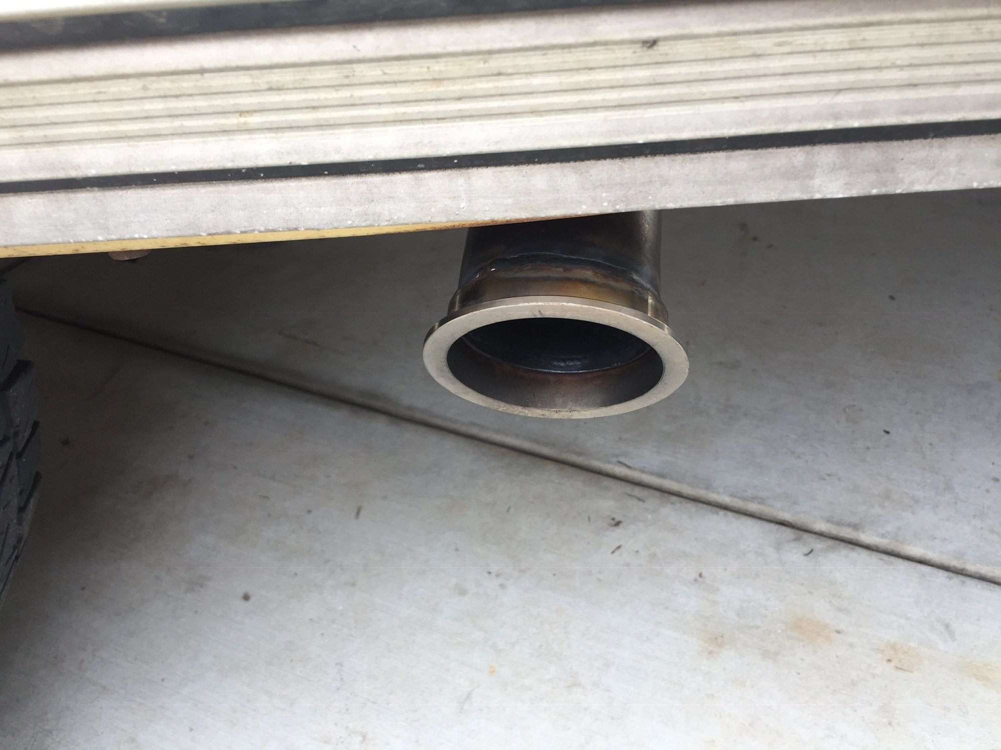

I have a 1973F 100 long bed
with a 302 with hedman headers, 2 1/2 inch exhaust with a crossover with Porter steel packs. Went 2.5” to 3” transitions and a stainless v band end.

I like it a lot, has kind of the old-school sound doesn’t sound like the flow masters everyone else has anymore. It has a little bit of rasp when you really get on it and it’s mellow to drive around. The V bands is just something that we do on a lot of exhaust with the desert racing I’m involved with, that way in case you get a flat tire it protects the end of the tailpipe and doesn’t crush it. The exhaust I had black ceramic coated and left the tips stainless. Please don’t mind the squeaky belt lol.
