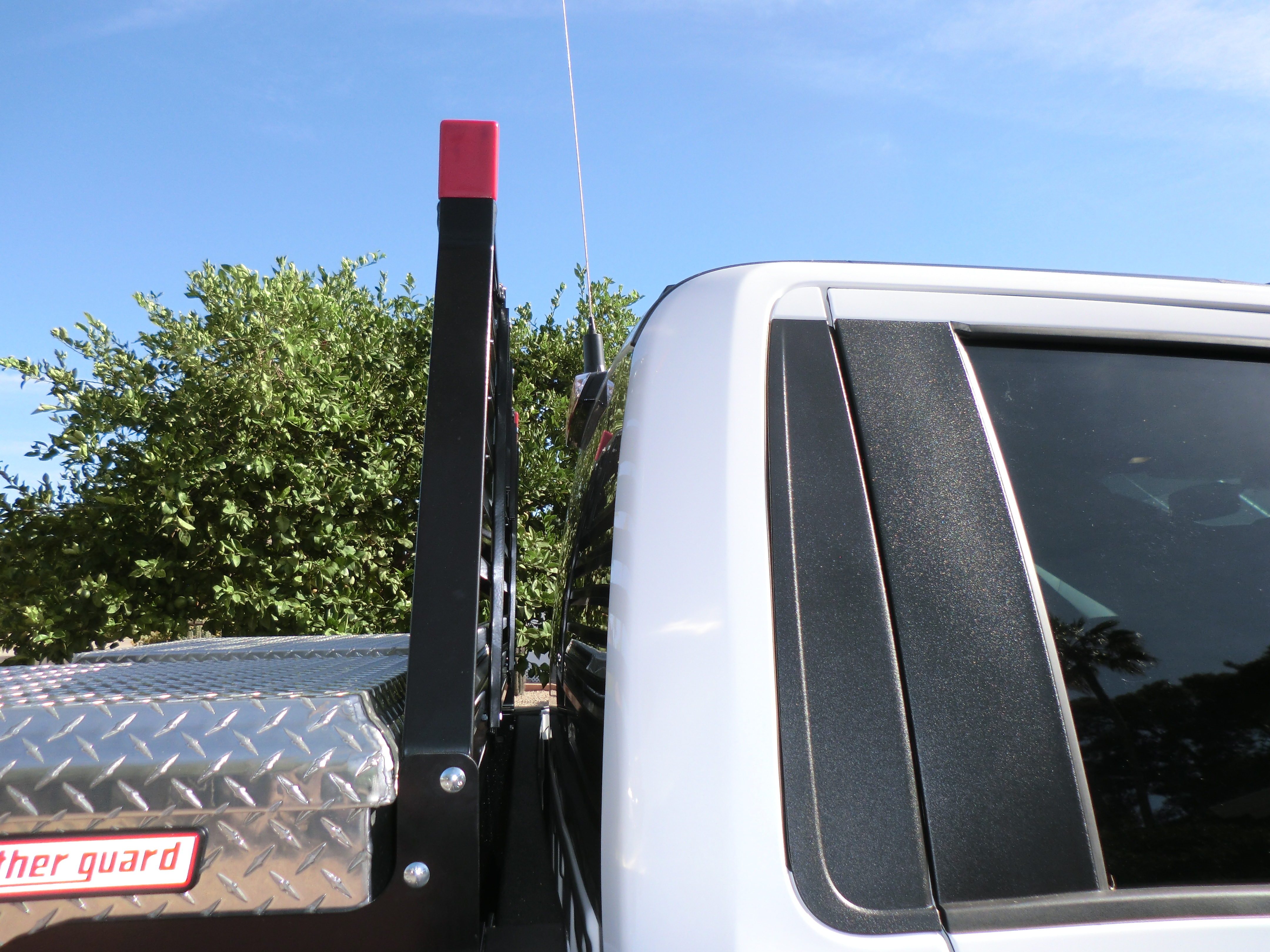

Originally Posted by LMychajluk
https://bulletproofdiesel.com/collec...-duty-90201129
If you're planning on using an antenna that doesn't have the NMO mount, you'll need the adapter.
I actually bought this for my F150, and was going to install it for ham radio before Covid, but never got around to it. Now I'm trading into an SD, but the part # seems to be the same, so maybe I'll put it on my F350 at some point.
I'm glad I pulled the trigger
Attachment 281083
Attachment 280448
