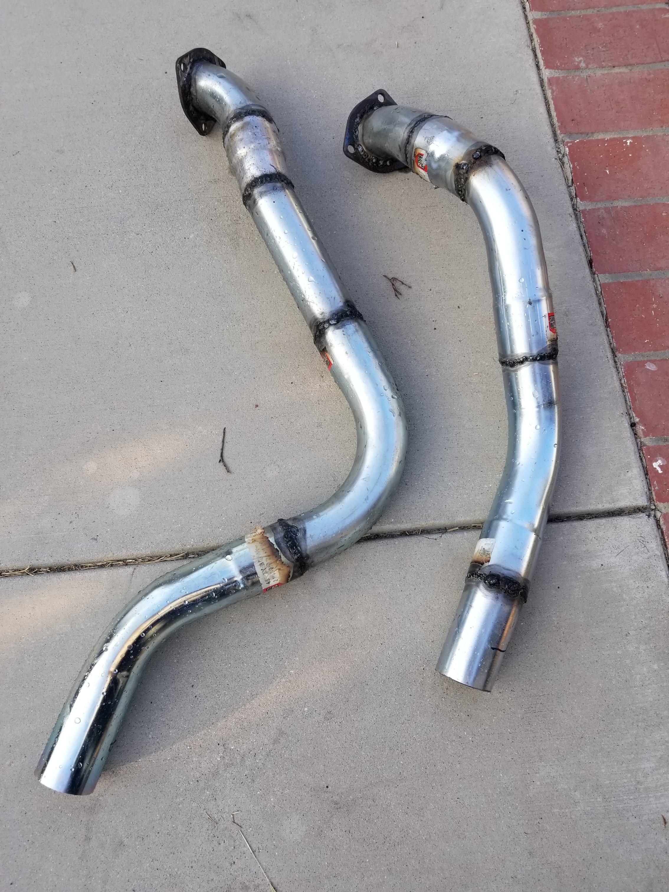

Hey guys. I just finished building a custom exhaust set up. I run a hp 300/4.9 inline six, so both collectors for the header(s) dump on the passenger side of the engine. What I found is that getting the collector flanges to seal is a bear. I can't get a seal. I've tried the aluminum gaskets, Remflex, copper, and single and multiple material gaskets. I can't get a seal.
I want to install a Walker ball and socket set on the header, but space is tight. I have angles right at the flange to clear frame and motor mount. Here is what I want to install: https://www.summitracing.com/parts/wlk-41723
Here you can see the angles needed at the collector flanges: Attachment 278123
Any suggestions?

Have you tried the gaskets WITH a thin coat of high temp RTV on both sides and a through set time?

I used aluminum gaskets w/ copper RTV on both sides. They sealed up but I'm with you, ball & sockets are much better. The next time I have occasion to remove my headers, I'll cut off the flange and weld on ball & socket.

No, not yet. I may try it. Thanks, that could work. I was actually considering taking two of these and machining down the thickness to about 1/4", and clamping them in the collectors. https://www.summitracing.com/parts/dte-9013-2 I know that is a bit extreme and unconventional, but after spending a week making up the pipes, only to have the collectors leak, I'm a bit out of patience, and the thought of having to pull carb, intake, and headers to mod them and weld on ball and socket joints just doesn't thrill me at the moment. Thanks for the reply.

Are both mating flanges relatively flat? Is the exhaust system mounted tightly? Any movement in the exhaust system is going to act like a big lever twisting at those joints. When I lost my rear exhaust mount on my old Camaro, the header flange gasket was leaking in a couple days from that swinging pipe. I'd bolt them up without attaching the rest of the exhaust then add a tie bar to connect both headpipes somewhere under the flanges and I'd add another solid mount to the block there to take some pressure off them. Maybe even a short piece of flex pipe between them and the rest of the exhaust to isolate any movement. If they stay tight and don't move around they should stay sealed.

Good point, Speedfreak. The pipe have three secure hangers. They (the pipes) are stable.

The collectors sealed this time around. I believe the problem of not sealing on the previous pipes was caused by bolting the collectors together with bolts smaller in diameter than the holes allowed. That meant that the collectors, during the tacking together a system and aligning it all, may have moved, or get misaligned. This time, however, I made sure to eliminate that possibility by using the proper bolts. What a pleasure to start the truck and hear a subdued exhaust sound w/o that tick tick of a leak. Thanks, guys.
