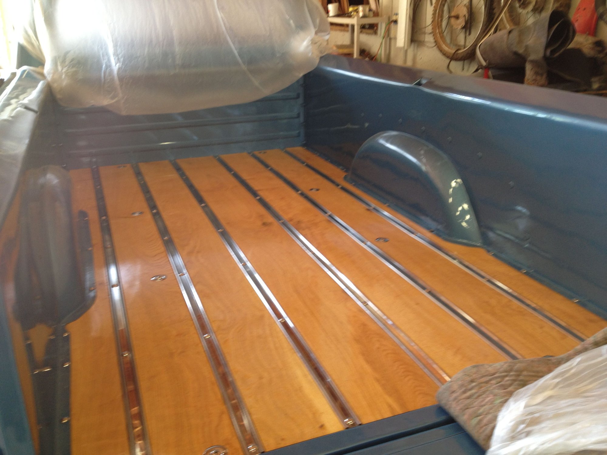

Old Oct 25, 2020 | 09:45 AM
schoo's Avatar
schoo
Joined: Mar 2012
Posts: 4,392
Likes: 44
From: placer county usa?
Pic of some wider boards these are California black oak with the widest board over 9” wide
i used lumber that was harvested many years ago and cut relief grooves in the back sides with long screws into the edges too prevent checking
