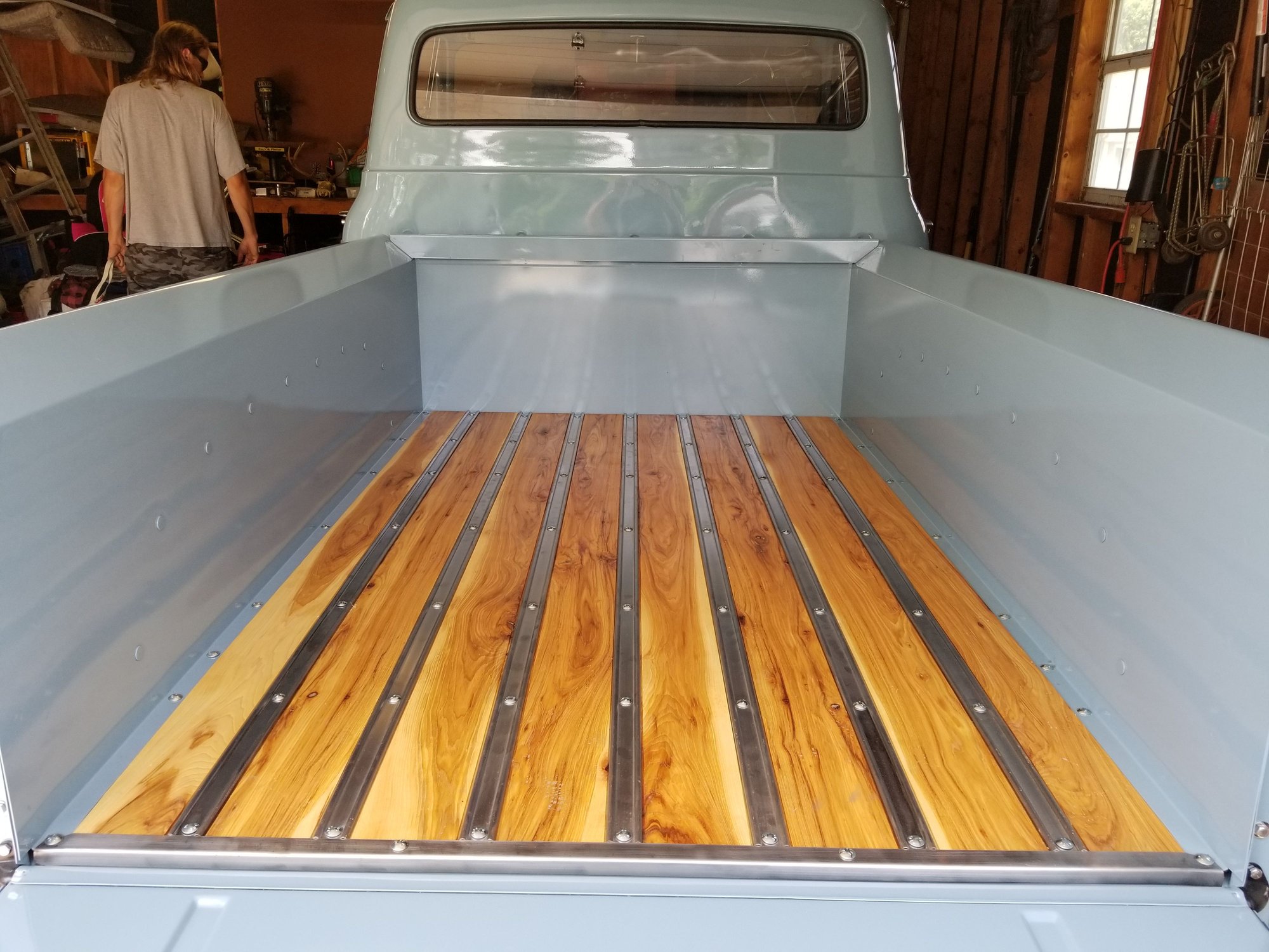

I got lucky on my bed wood. My dad had cut down a large hickory tree on our property and he had a friend mill it into rough sawn lumber. It had been sitting in a shed for a few years and was good and dry. Brought several pieces home with me and planed them smooth. I used pure tung oil on them till they wouldn't hold any more. turned out real nice.
I have to agree, hickory is a pretty wood in the bed. You have to be careful with the router as the corners like to splinter, but it really shows itself with a light stain. Nice job on that bed.

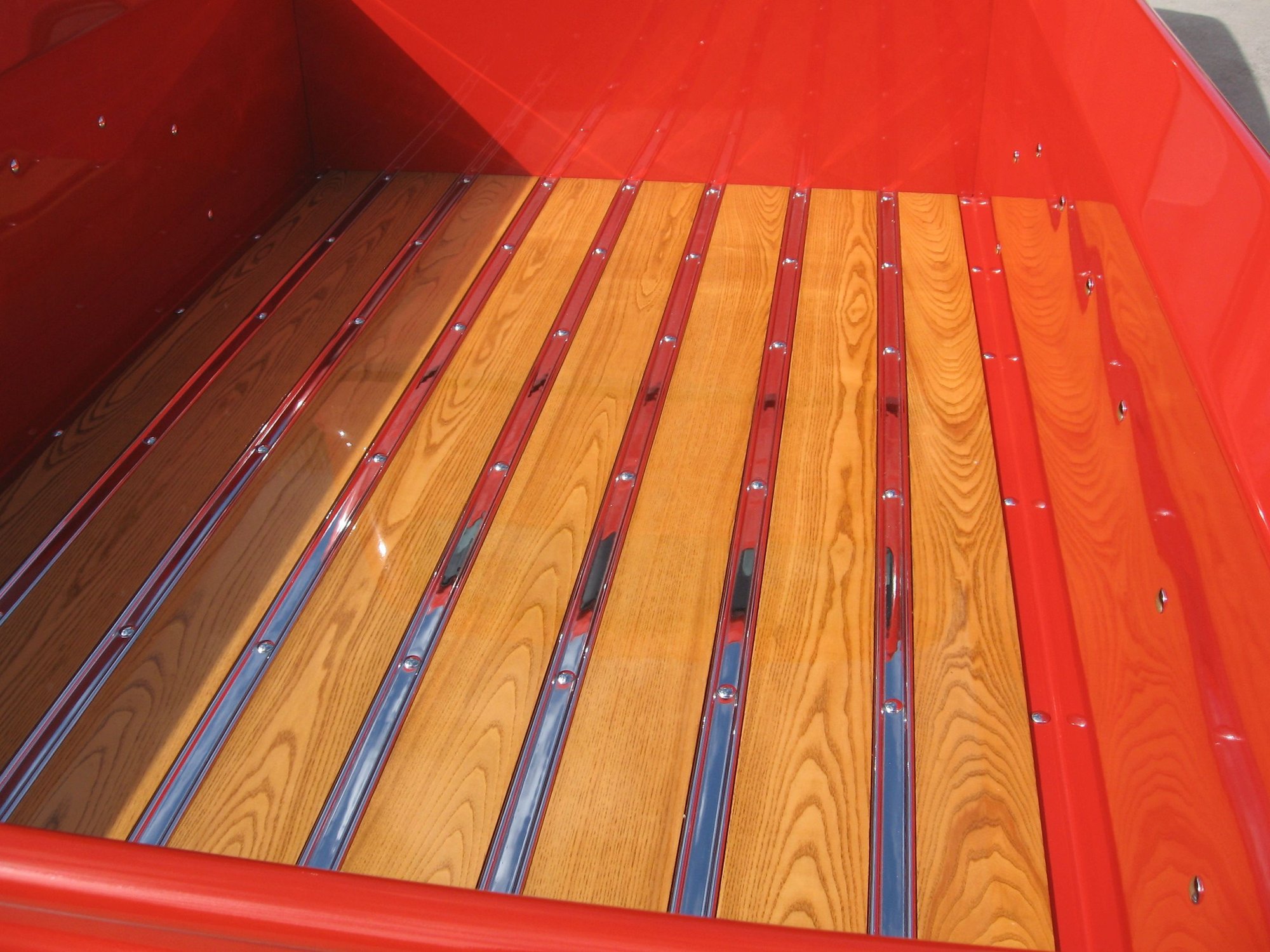

Custom bed boards
Ash w/ 16 hrs. of block sanding . .2 coats of sealer & 8 coats of Alphatic Urethane .
