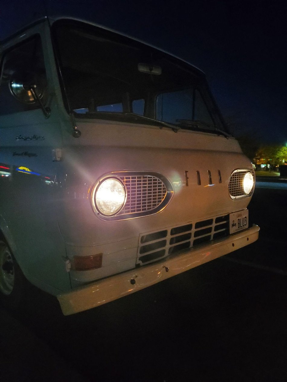

My poor little Blue got in a fender bender tonight and now needs a new front bumper. I wondered if anyone on here knows where I might be able to find a replacement? I will probably need the bumper brackets as well just to be safe. It is a 1963 Ford Econoline.

If you want the same, get a 1961-1964 front bumper. If you want thicker Steele and a bumper that is not as wide (does not stick out as far past sides of truck) then get a 1965-1967 bumper. To use the 1965-1967 bumper, you must use 1965-1967 bumper brackets. The holes in the frame for 1961-1967 are the same.

The 1961-1964 bumpers are thin steel. You should be able to remove it and beat it in shape with a big hammer.

I wondered about maybe fixing the bumper, but it might be beyond my skillset. I might start searching for a good metal worker along with my search for a bumper and see what pans out first. At least the bumper did what it is designed for and helped to prevent further damage to vehicle and people inside!
