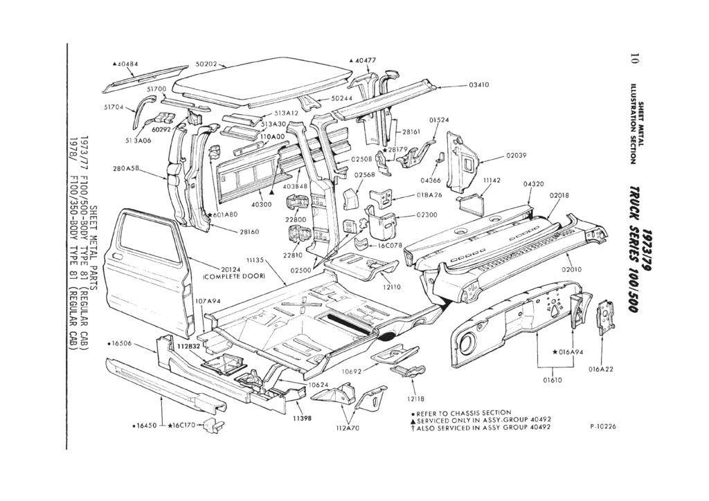

Who sells the best panels like this? What the heck are they called?

I have never seen that part specific reproduced. I would call it a "cowl bucket". #02300

Cowl bucket is the right name for them, I have looked everywhere for them also the side kick panels just below and directly behind the cowl bucket. The interior panel above the rear window too. The illustration you posted has them all, I just wish they could be found reproduced.

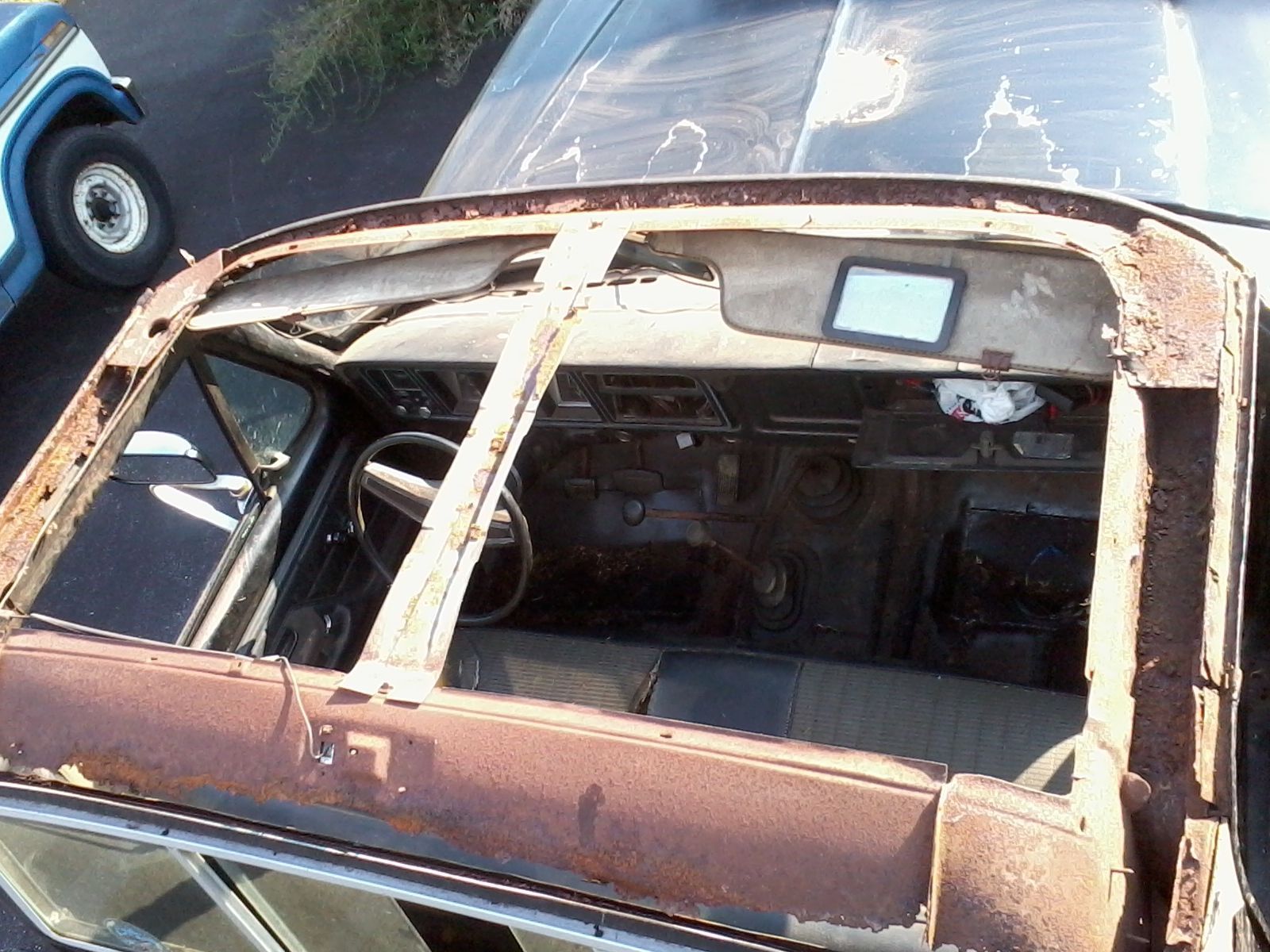

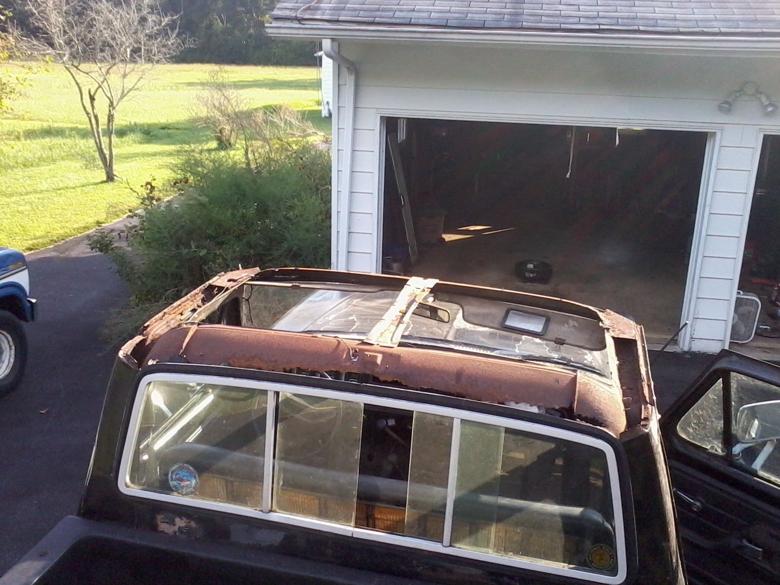

Are you dealing with some rust issues? Here....don't feel so bad now.
Old Oct 23, 2020 | 09:44 AM
76f100ss351c's Avatar
76f100ss351c
Joined: Oct 2020
Posts: 26
I tried to PM you back but I guess I haven't been a member long enough. That's the way my headliner panel looks, roof had a bunch of drilled holes that leaked and ruined that panel, I didn't know the roof panel would come off without taking the rear window out, but I haven't got that far yet. Where or who would you think I could sell a 78 f250 4x4 with a pile of nos parts. I hated to start posting stuff separately or just post I have a truck load of parts I don't want people on here thinking that's all I'm after is to make a quick buck, all I want is to have the parts to build my truck, and ask for advice on my build or help someone with theirs. I've waited 25 years to get started building it. I bought the f250 2 weeks ago and it came with a ton of stuff and took me nearly 30 years to finally buy it. It's all Nos Ford the body parts is mainly what I wanted, but was hoping some other things could be used also, like I suspected the 78 is a lot more different than my 76. Thanks for any advice or information..

Roof panel will only come off without disturbing the windows if there is significant rust out. With a complete intact roof, you're supposed to remove the windshield and backlite, so you can get to the roof spot welds on the pinch-weld where the window seal is retained to the cab.
Mine rusted out in the front, so I replaced the cab. But it was badly enough rusted that I was able to remove my windshield, with the seal intact, with very little trouble.

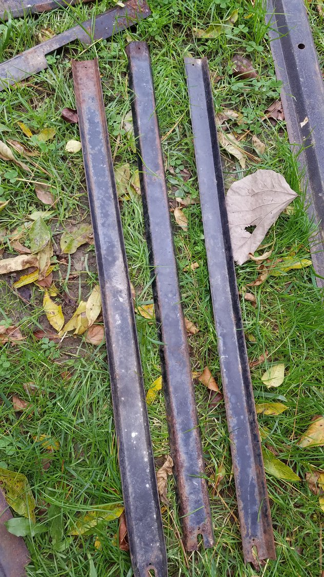

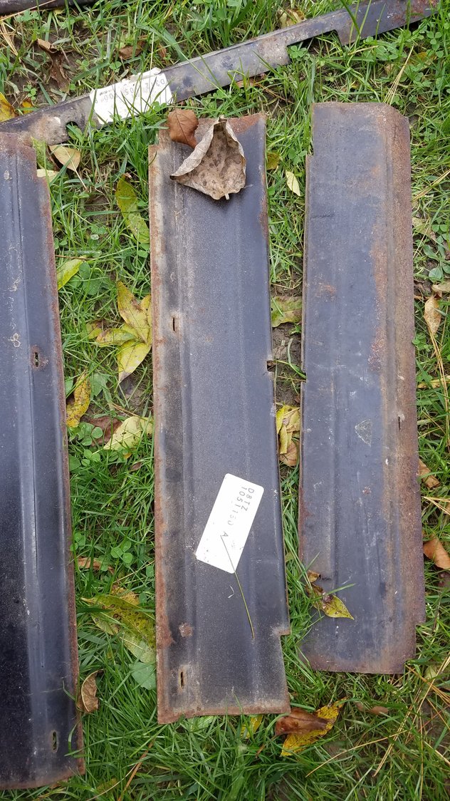

Thanks for the info pics and illustrations, that's a big help. My roof is solid just has a bunch of holes drilled all over it. I have most nos panels to build a new body, the cowl buckets, and kick panels rear panel over the rear window I do need , I have nearly every cab part. I have some pieces I don't know where they go yet. See pics..0
Old Oct 23, 2020 | 11:11 AM
76f100ss351c
Joined: Oct 2020
Posts: 26
I just found out where the pieces in 2nd pic go they are the center section above the door.

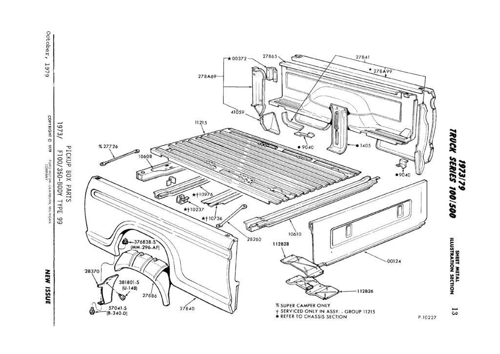

Well then here is another one for you.
Old Oct 23, 2020 | 01:11 PM
76f100ss351c
Joined: Oct 2020
Posts: 26
Ok thank you again, that may come in handy later on, I'm keeping my old bed for reference when it comes to cutting the new sides and floor down to short bed length it will be much easier putting it together.
