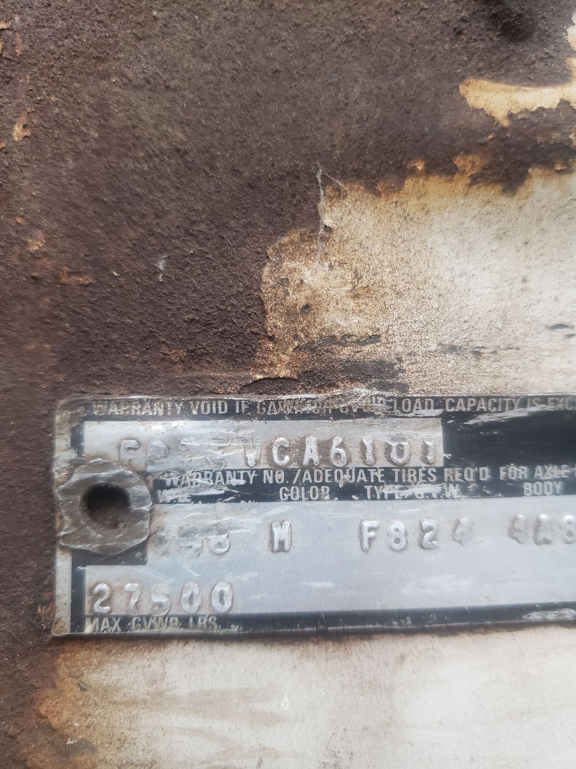

F800 von tag
Wondering if anyone can help read this tag. It’s on a 1978 f800. My best guess is F82FVCA6101

What does the title say?
F82 = F800 gas
F = 391 4V XD FT V8
V = Kentucky Truck Plant
CA6101 = 1978 series number
**8 = wheelbase (not legible)
M = White
F824 = F800 gas, 27,500 GVWR
4A8 = Standard cab, and upholstry code, which I do not have.
27500 = 27,500lbs GVWR
Can't see your other codes.
