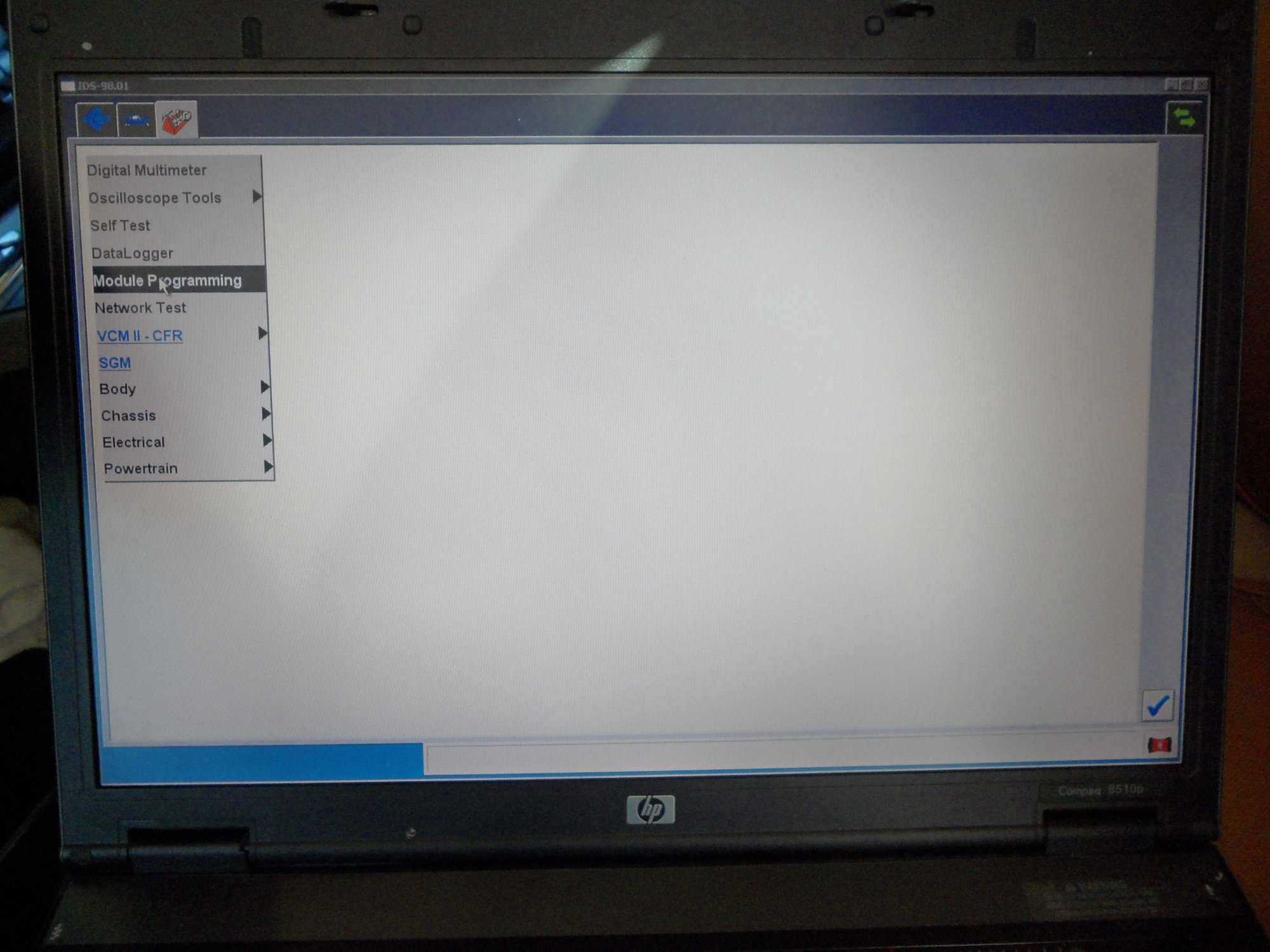

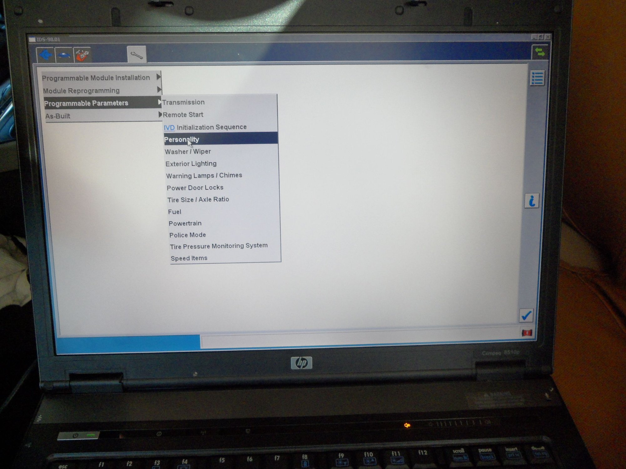

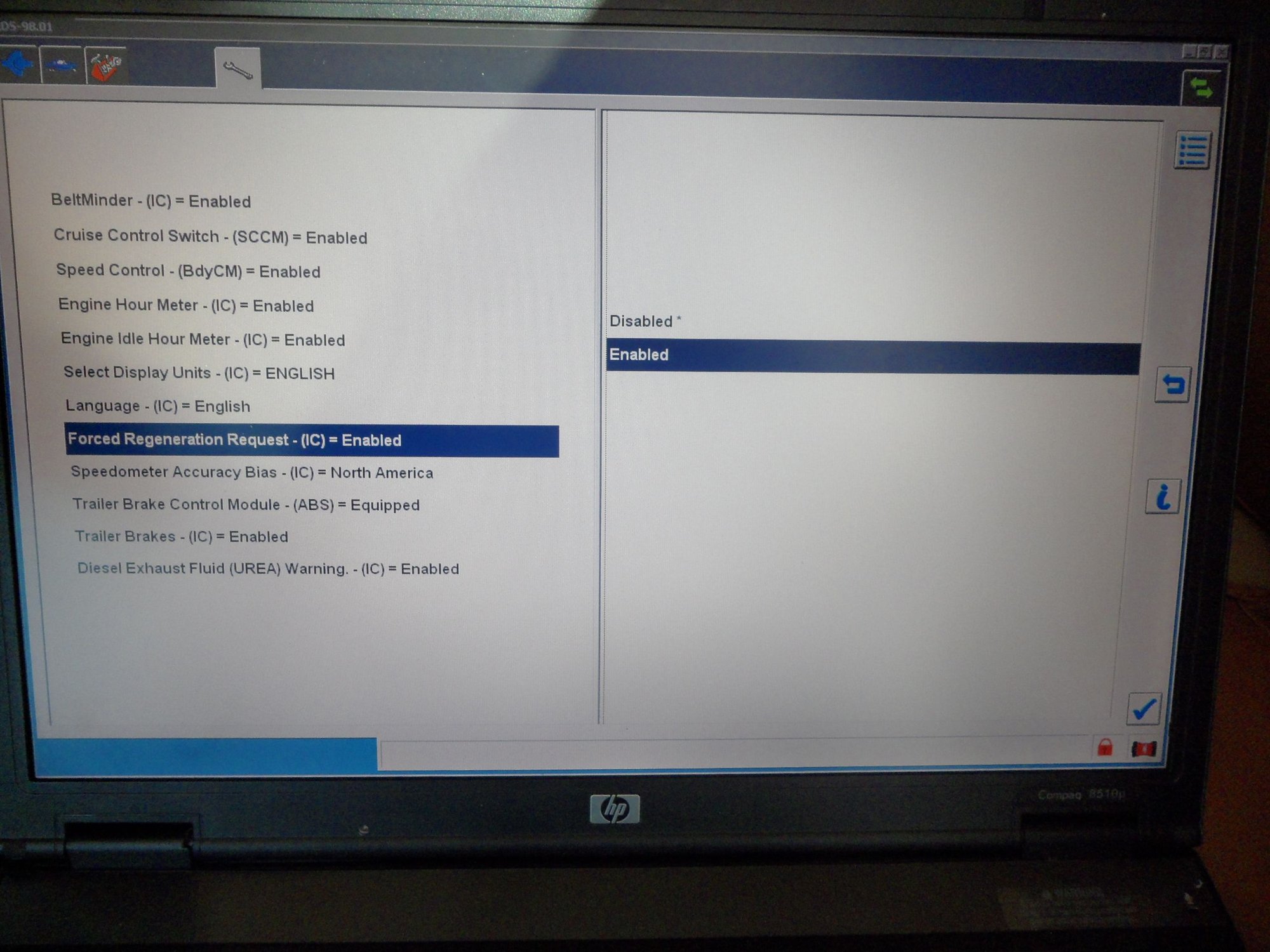

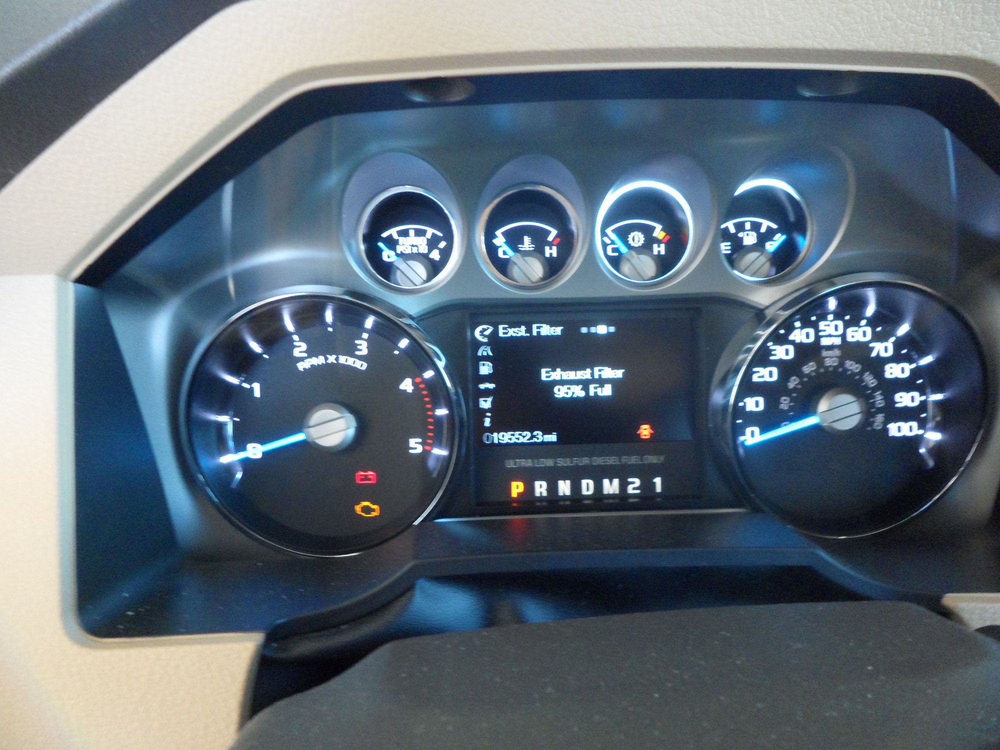

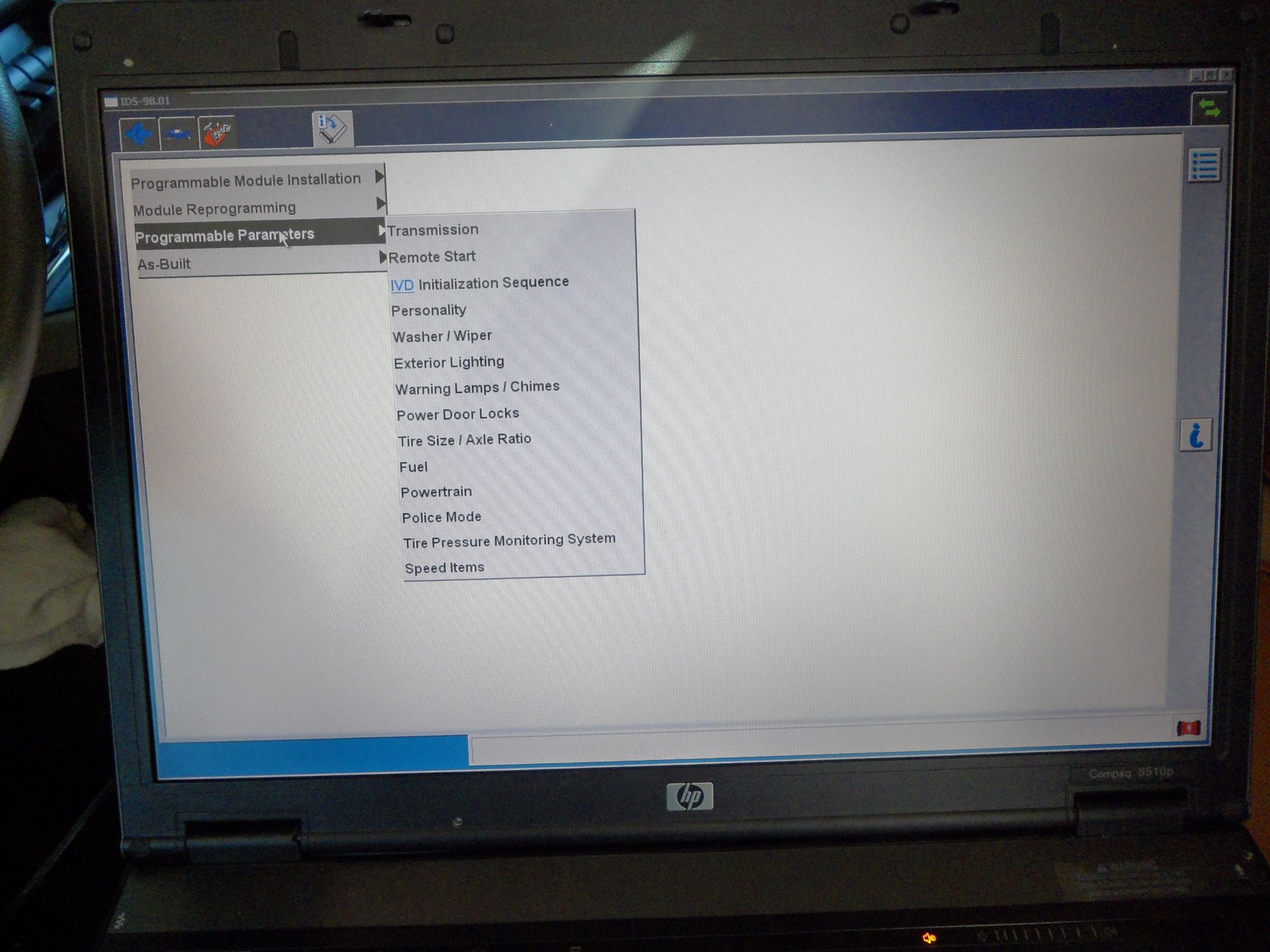

This is how I turned it on for my 2015 using IDS. Not sure what will show on the non-digital center display.

Just stroking, does the screen stay enabled after IDS disconnected, and available for daily driving info? or is it only available for observation while the IDS is connected and manual/forced region is occurring? The tech at Yuba City Geweke Ford enabled, per your prompts, but the screen was not there after IDS disconnect...please advise, thanks.
It stays enabled if done correctly.

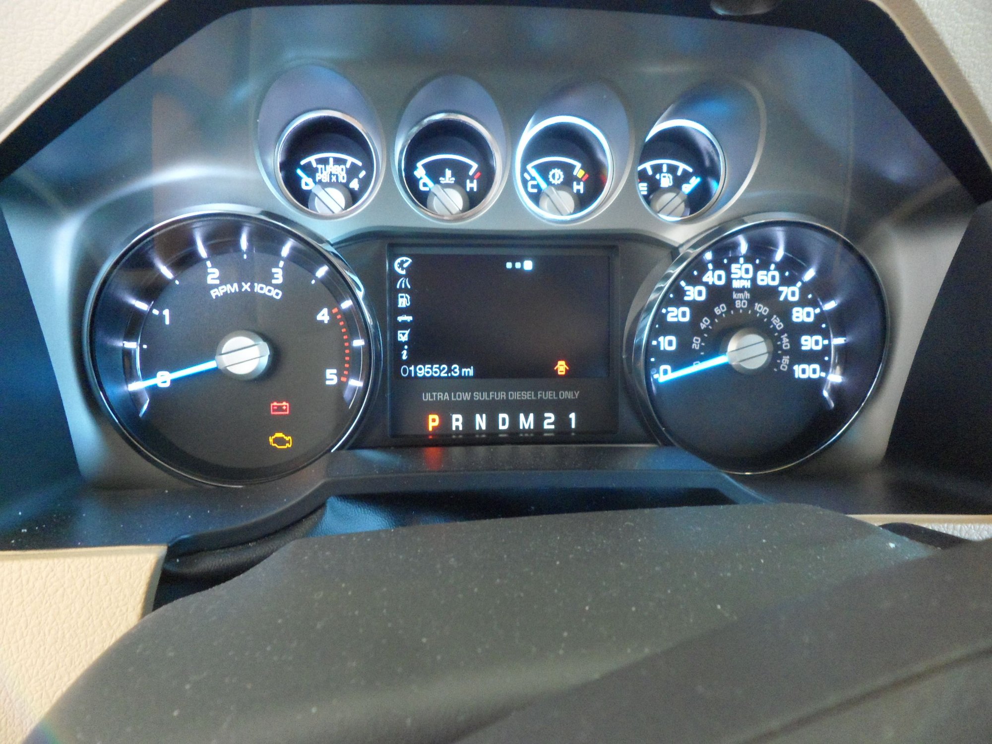

When in the top menu page grouping, do you have 4 dots in the top center of the display or 3?
​This indicates the number of pages available, and should be 4 if the dpf % screen is enabled.

mjs2011, I have 3 total, first page shows oil temp & trans temp, second page shows compass and the third page is empty.

Sounds like the tech did something wrong then. I'm not familiar with IDS so not sure if it's possible he forgot to apply changes or what may have happened. I'd ask him to try again. The steps JustStrokin shared above should work for a permanent dpf % screen.

If you follow the photos I posted, the screen stays enabled.
