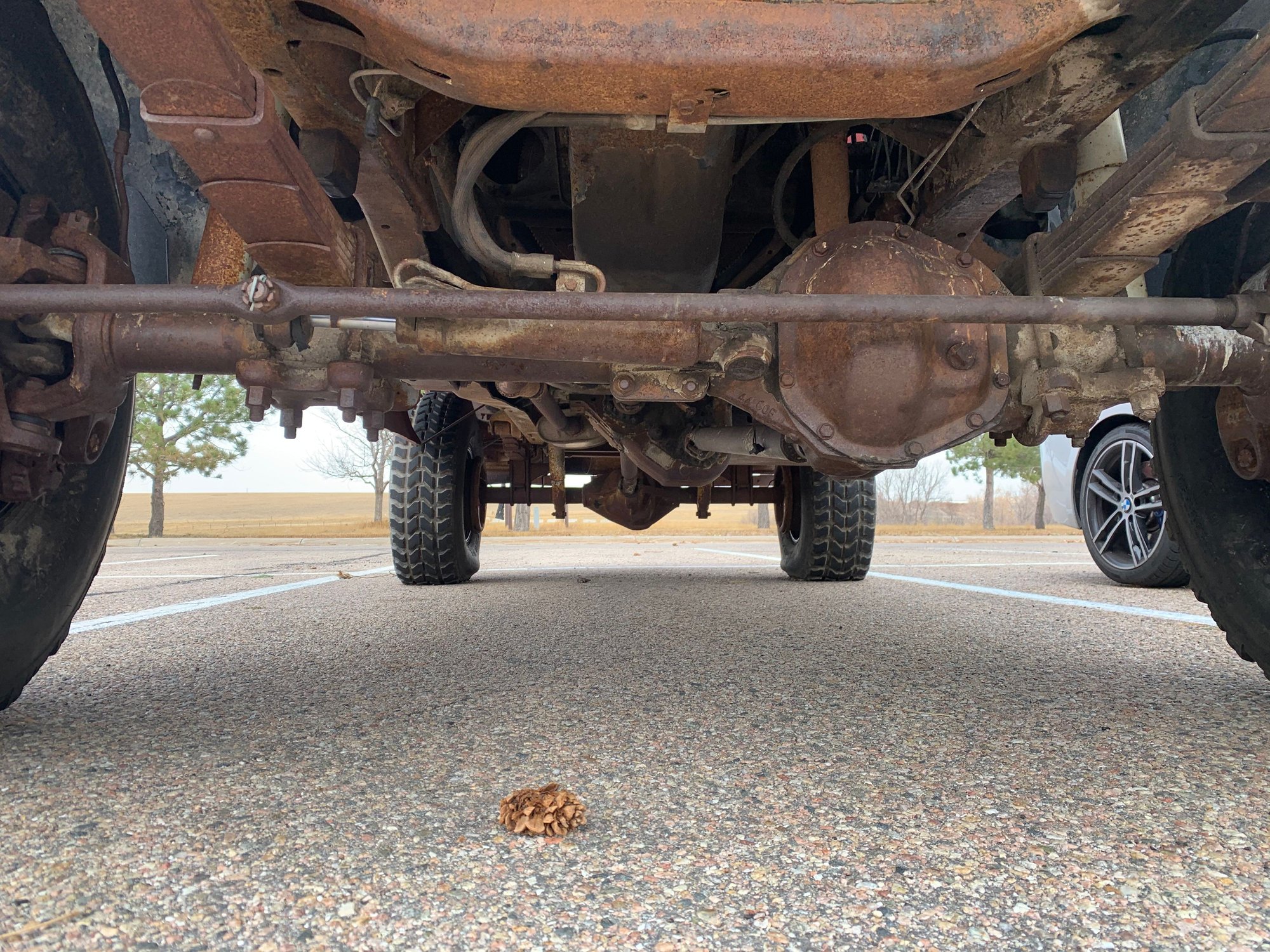

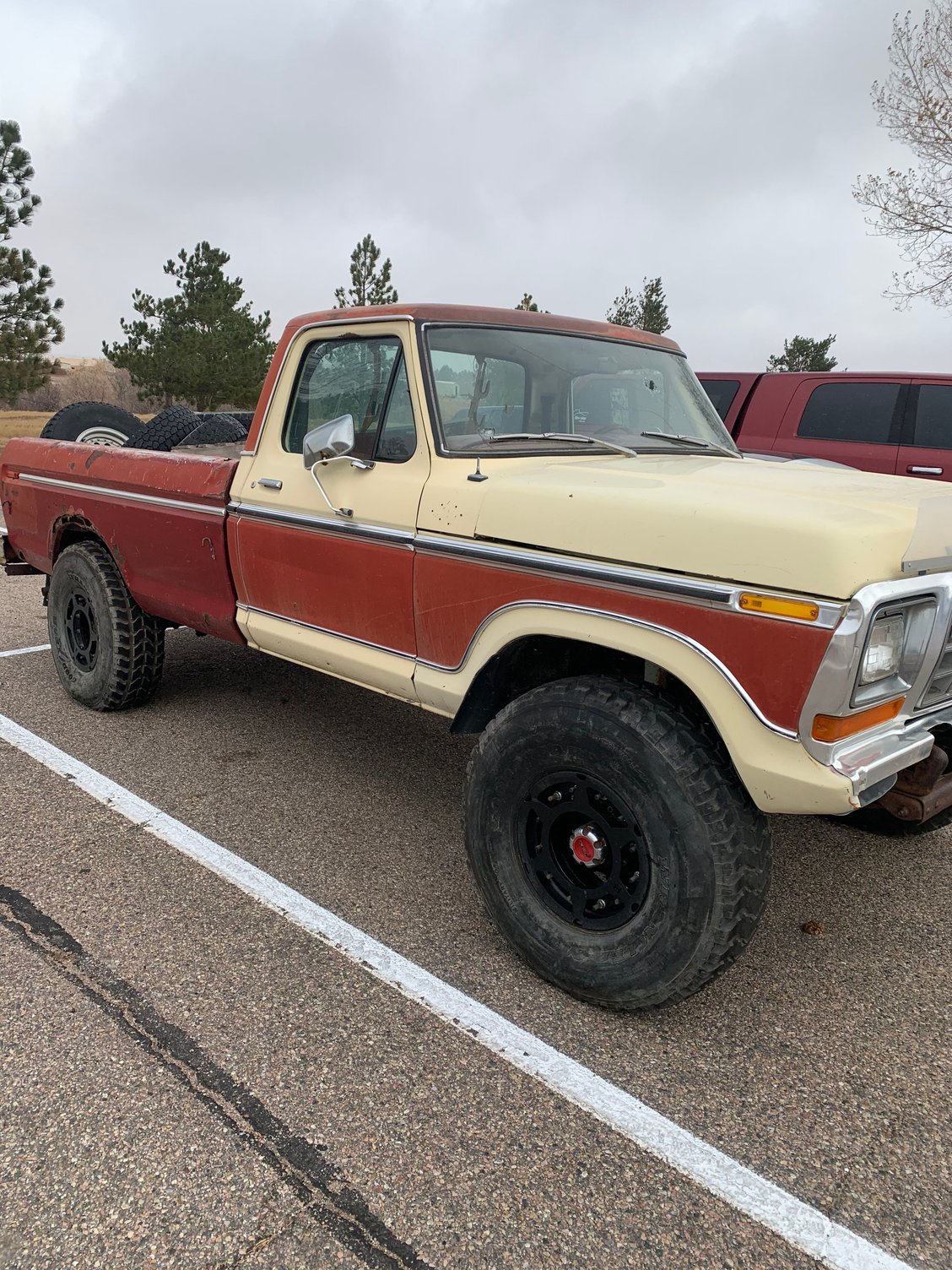

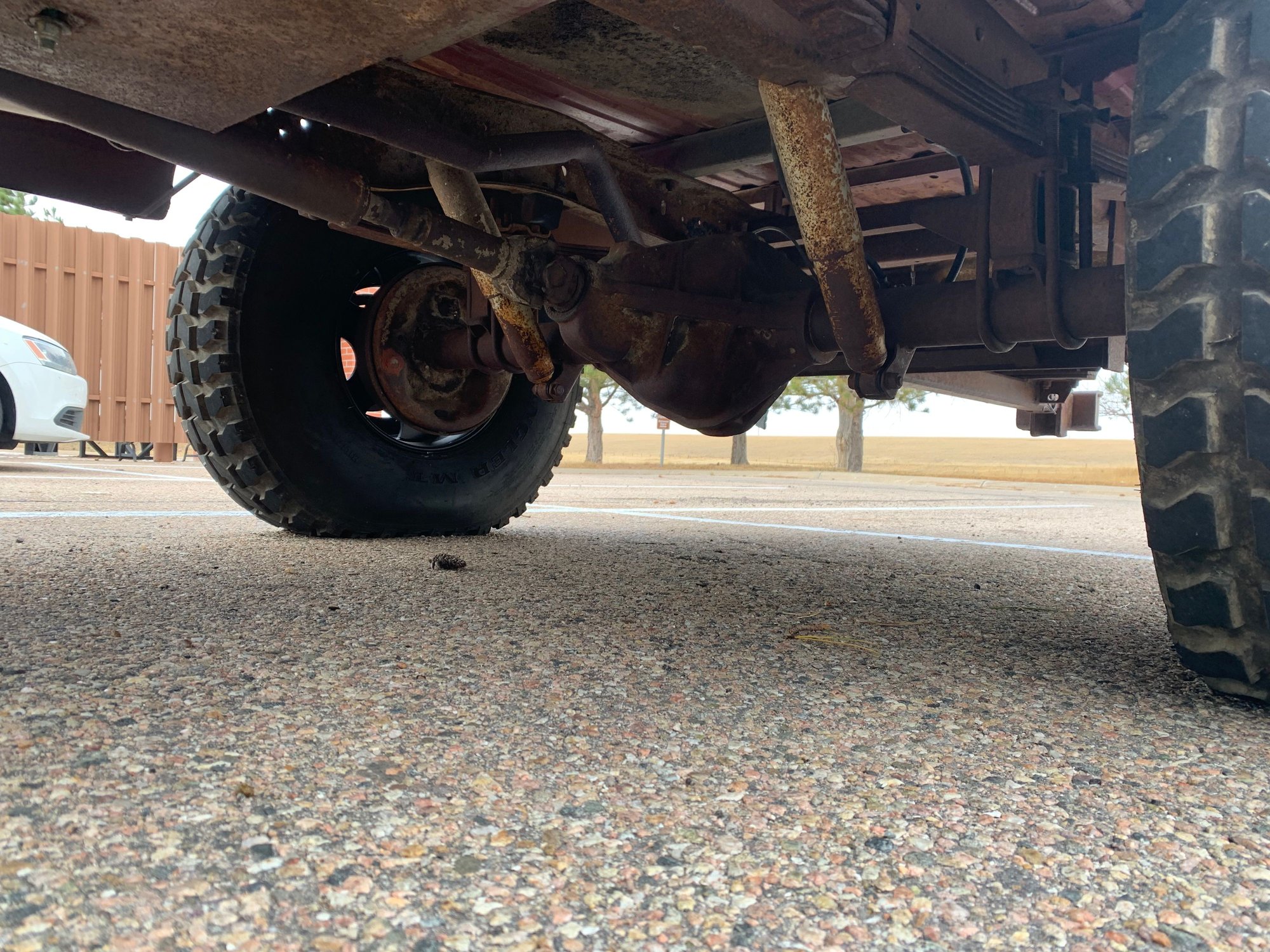

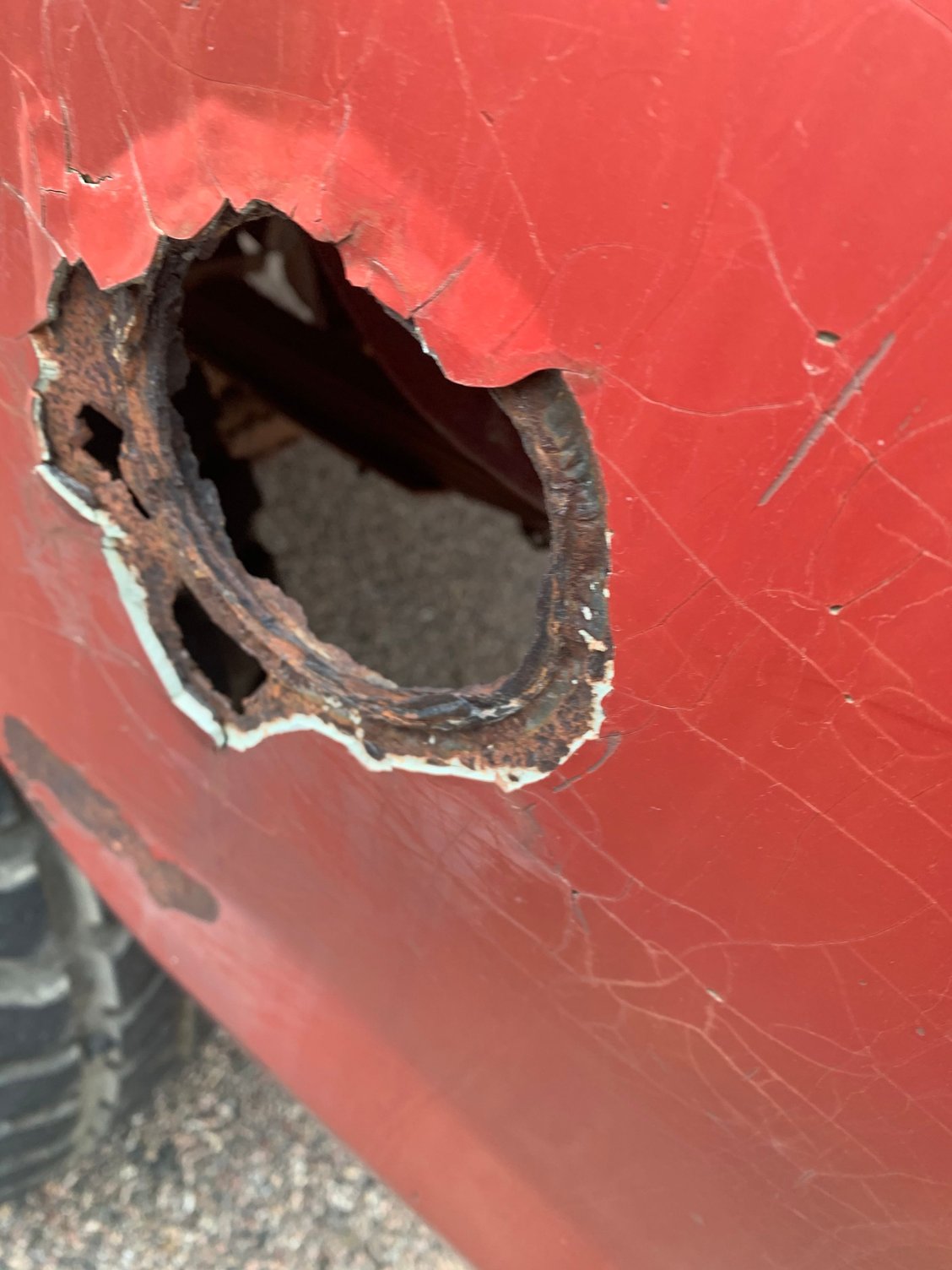

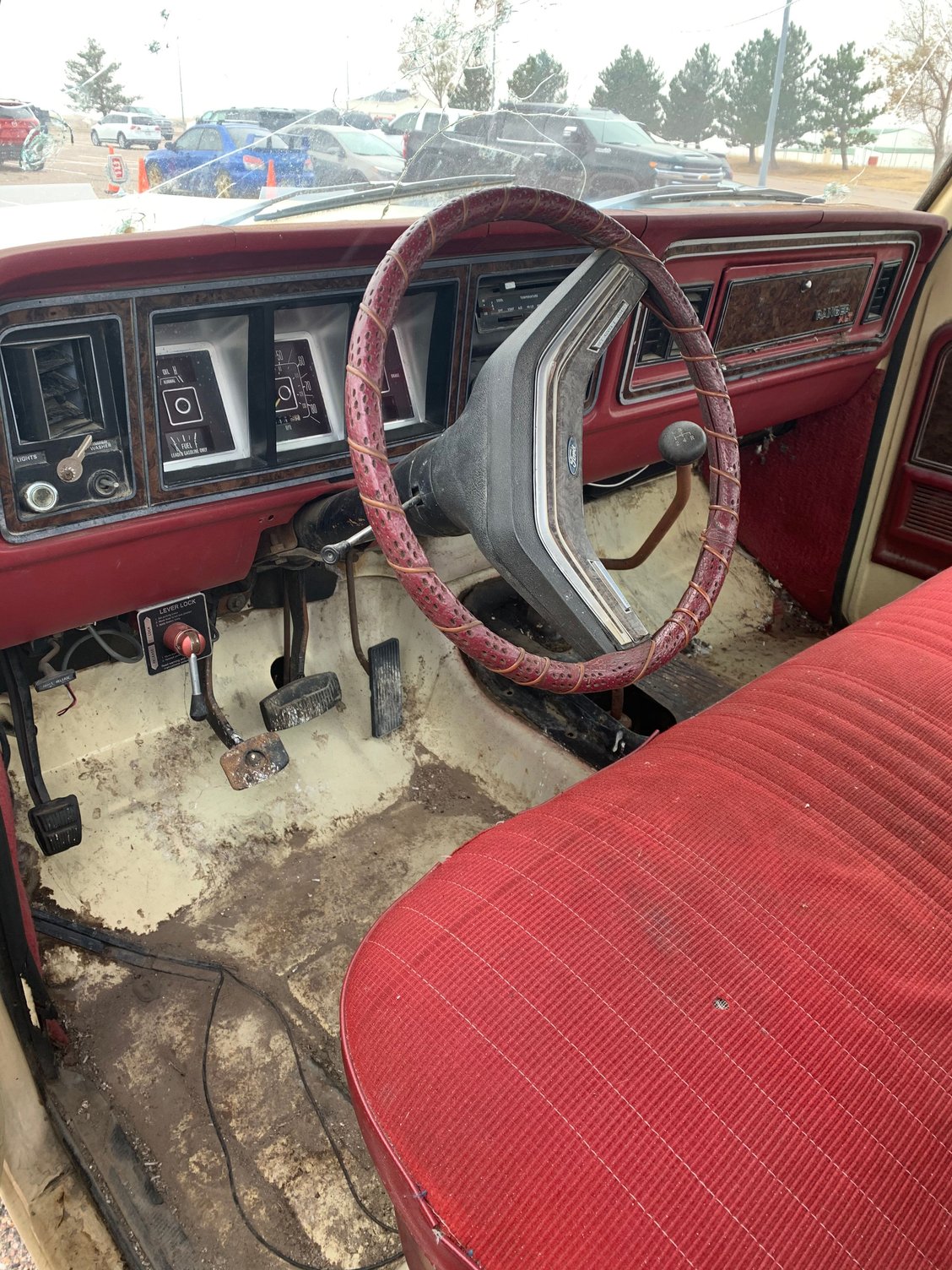

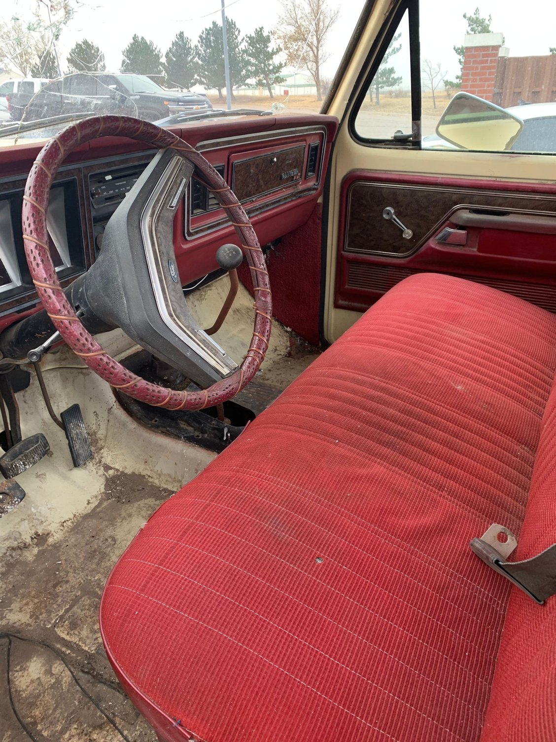

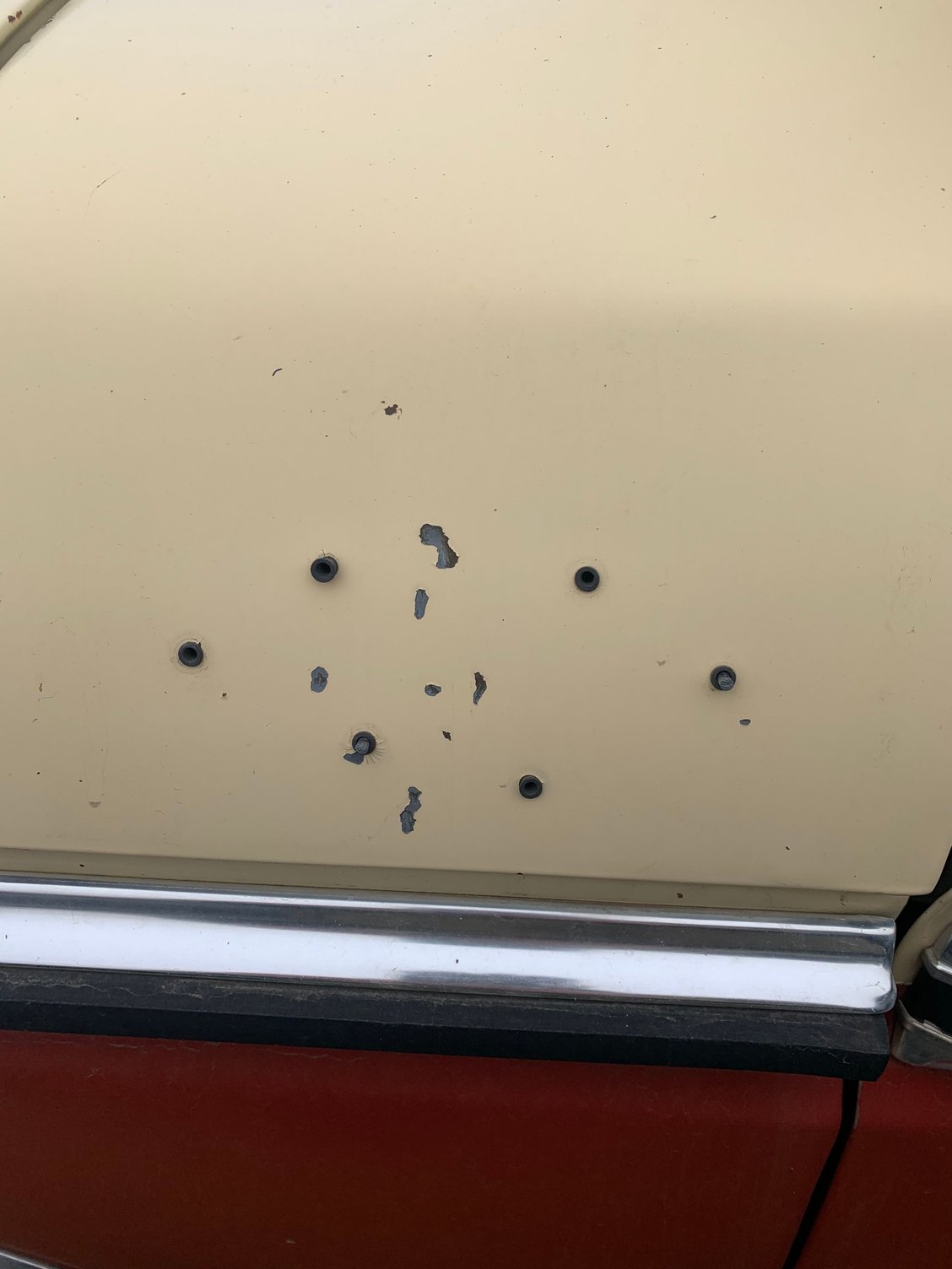

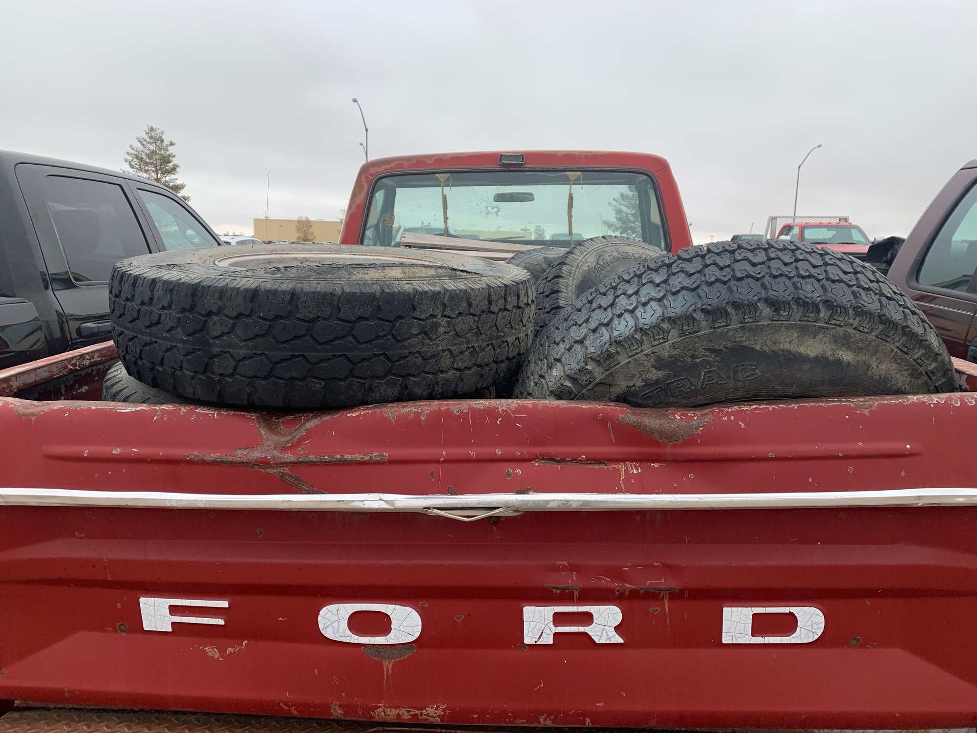

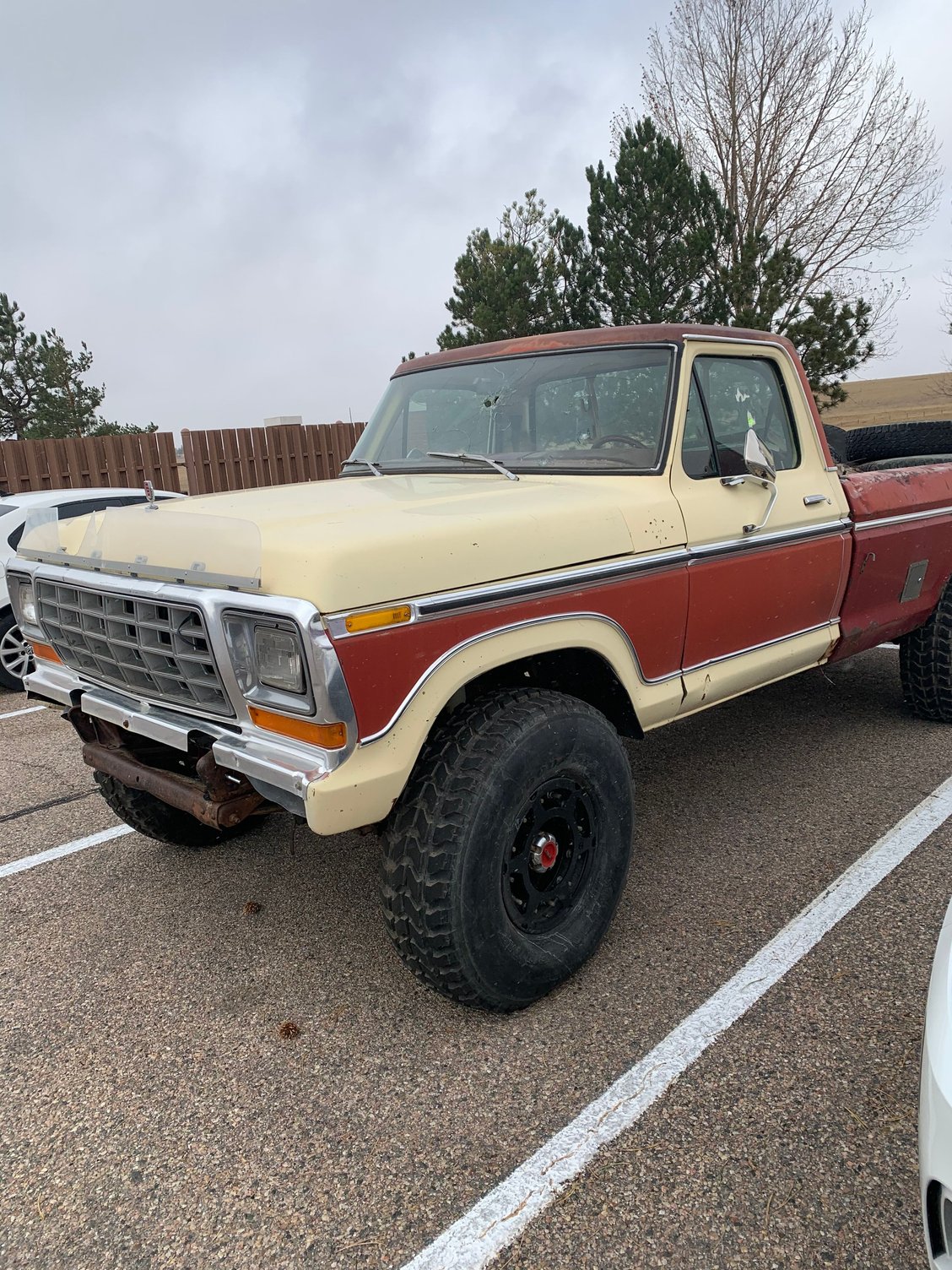

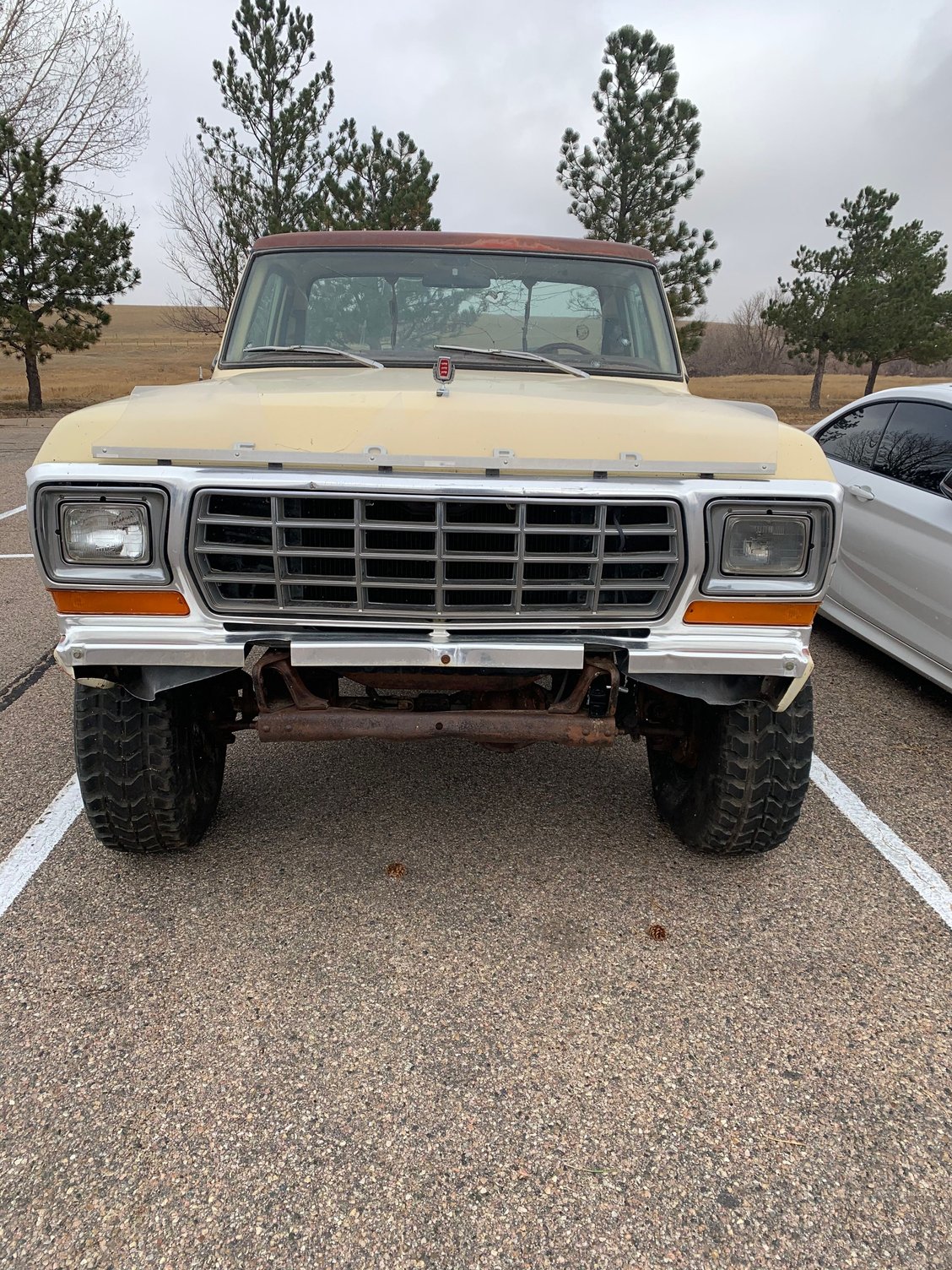

Here’s some more pictures to help everyone who requested to see more. The VIN and the Title both claim it’s a 1979.

I take it the title matches the VIN on your warranty tag, (the metal tag on the drivers door) and on the Certification Label (the decal on the cab door jamb which faces the warranty tag)?
Next you need to check your frame rail VIN stamping. It's on the top of the passenger side frame rail, basically under the alternator. You might have to do some scrubbing to find/see/read it, but it should be there. There is also another stamping farther back, under the passenger side floor pan.
I wonder if it had a frame swap with engine, or if someone just installed the FE by itself.
The bed might tell a story too. Does it have "Custom" badges, or signs of having had them, below the rear marker lights? If so, the bed is from a '76 or older.
Does it have a fuel door behind the driver side rear wheel? Is there an actual door, or is there just a gas cap? The midship fuel door visible in the picture is from the aftermarket.
'76 is also the last year for the exposed gas cap as well.

Looks like someone did a cab swap to me.
Old Oct 22, 2020 | 02:27 PM
ford390gashog's Avatar
ford390gashog
Joined: Jan 2004
Posts: 26,007
Likes: 575
From: Brentwood,CA
So just like I thought. Its a highboy that somebody body swapped. The bed is correct the cab not so much. Whoever installed the rear driveshaft backwards was on a good one that day.

Yes the title matches the VIN on the driver side door’s little metal plate. No custom badges that i see although there was a missing badge of some form on both sides in front of the doors (see pictures). As for the fuel door behind the driver side rear wheel, there’s only a whole were something COULD go.

OK, that hole looks to be from an exposed gas cap. I wonder if your bed is original to that frame. I also wonder what the frame's VIN is.
The missing badges on your cowl would say F100/150/250/350 on top, and Custom, or whatever trim level, below. That badge scheme started in '77.
'76 and earlier trucks say F100/150/250/350 on the front fender behind the wheel, and the trim level is denoted at the rear of the bed there, under the side marker light.
Old Oct 22, 2020 | 07:36 PM
yardbird's Avatar
yardbird
Joined: Dec 2003
Posts: 3,774
Likes: 860
From: Foothills of NC
That's a 1979 Ranger XLT cab. Probably a F100/F150. If you could post the vin, at least most of it, the vin could be decoded as to if it is a 100/150 cab. You really need to find the frame vin to know what you really have.
