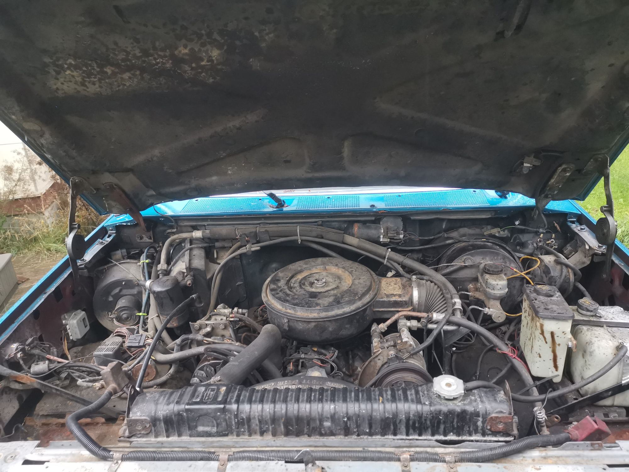

first off I hope that is not the Turbo'ed 7.3 you are speaking of. because someone Stole yer Turbo....
that 5 speed Tranny should be giving you some pretty good mileage 3.5 mpg is extremely bad ...are you sure it is not Leaking the fuel out ?
I think the first thing would be to at least do a Compression Test .... cylinder leak down test would tell you more.. but just a simple compression test should give you an Idea of the overall condition.

Haha my bad, that pic is actually hiding it perfectly behind the top cover.

I'm still not sure about a Turbo with an OEM NA air cleaner
but if you have one sitting back there maybe that is leaking... I do see the Glow Plug Controller is relocated to the fender well so that makes that a lot easier to test than when mounted on the back of the engine. But the CDR is not relocated.

I also didn't know that the Glow Plug controller was located in a different spot. It's for sure been a huge help diagnosing, I think I'd lose it a bit if it was mounted that far back lol. I'll also attach one of the few pics I have of the turbo in the back. Definitely makes no sense to me as it goes from a nasty short cold intake that's above the manifold, to the intake bowl, down and back up to a rubber corner tube, then to the turbo. I'm really hoping on fixing that too soon lol.

Can you take a few pictures with your phone back where your turbo is connected?

Isn't that a CTS? (Canadian Turbo Systems)
I could have thought they were the ones that used the oem air cleaner..there was also one more oddball company out there that I'm trying to think of..
Definitely interesting and I would love to see more pictures of this!
Edit found this video: https://youtu.be/YAhKHR5F5xE
