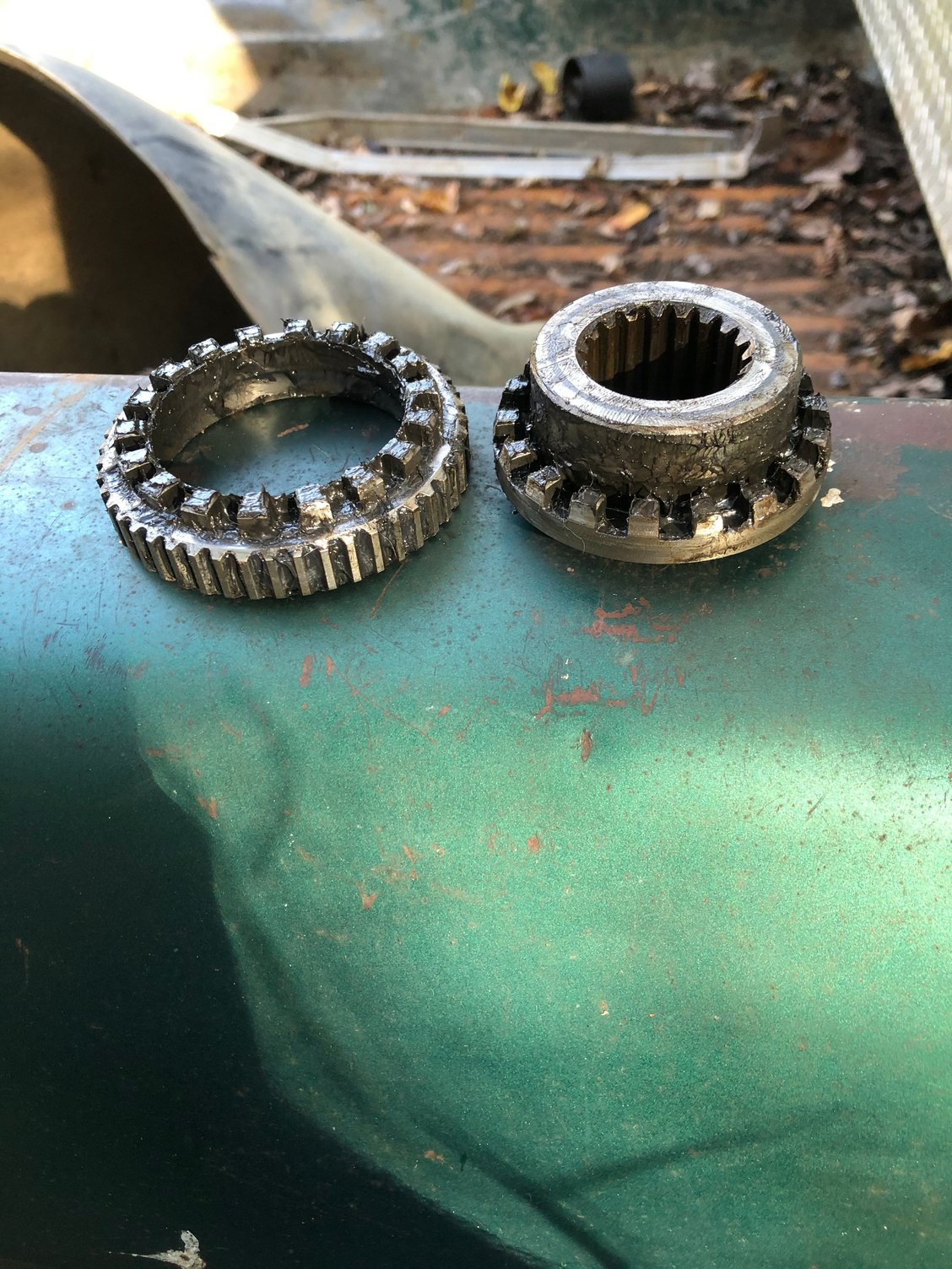

Just out of curiosity these are the correct hubs for a 1978 f150?

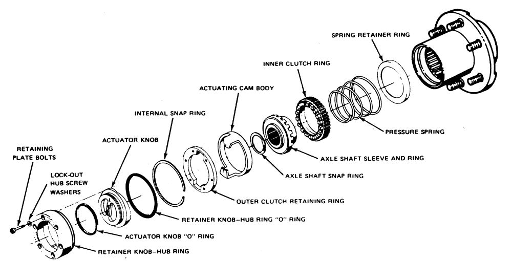

Those parts are from a internal type hubs. And I do believe when you put them on, the instructions tell you to put the hub in "lock" for installation. Just for installation of the Retaining ****-Hub Ring. Your pic is the Inner Clutch Ring on the left, and the Axle Shaft Sleeve and Ring on the right. Some times yiou have to push that in a bit to get the Axle Shaft Snap Ring on. Also make sure you Spring Retaining Ring is installed properly. That pic does not show the lip it has to hold the Pressure Spring centered. Internal below.

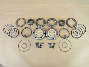

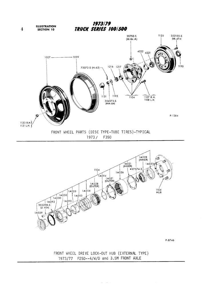

So I looked in the parts that I had from taking the hubs off and the truck had two different style hubs on it. One was like the internal gear style and the snap ring would not go on but the other is different and the snap ring works. Would this be the right hub then?
By the way this is just an image I found of the hubs

I do know this for sure, my 79 F250 has the internal type lock in/outs. And on my 79 parts Bronco...same as a F150 D44, it had the external type. In that pic you posted it is missing both the "spring retaining rings". That is the 1st piece to go in the hub (with a specific direction of the lip facing out) when reinstalling.

Yes those are the correct style Spicer hubs. there is a large and a standard version used on f250's but the 1/2 tons all used the standard size until sometime in 1977. there were 2 different gear types used on the open face Spicer hubs but as long as all the correct components are used for each design they will function fine.
Sometime in 1977 through 1979 used the internal, or Warn style spicer hub.
I believe the two styles will both fit in place of each other , I've seen it done anyway and I don't think it took any modifications. both styles require a snap ring on the axle.
The 1978 model would have the newer style hub. though as stated the older style hubs should work and are actually stronger.
79&79 is correct there should be a lipped washer on the inside that's not in that picture.
