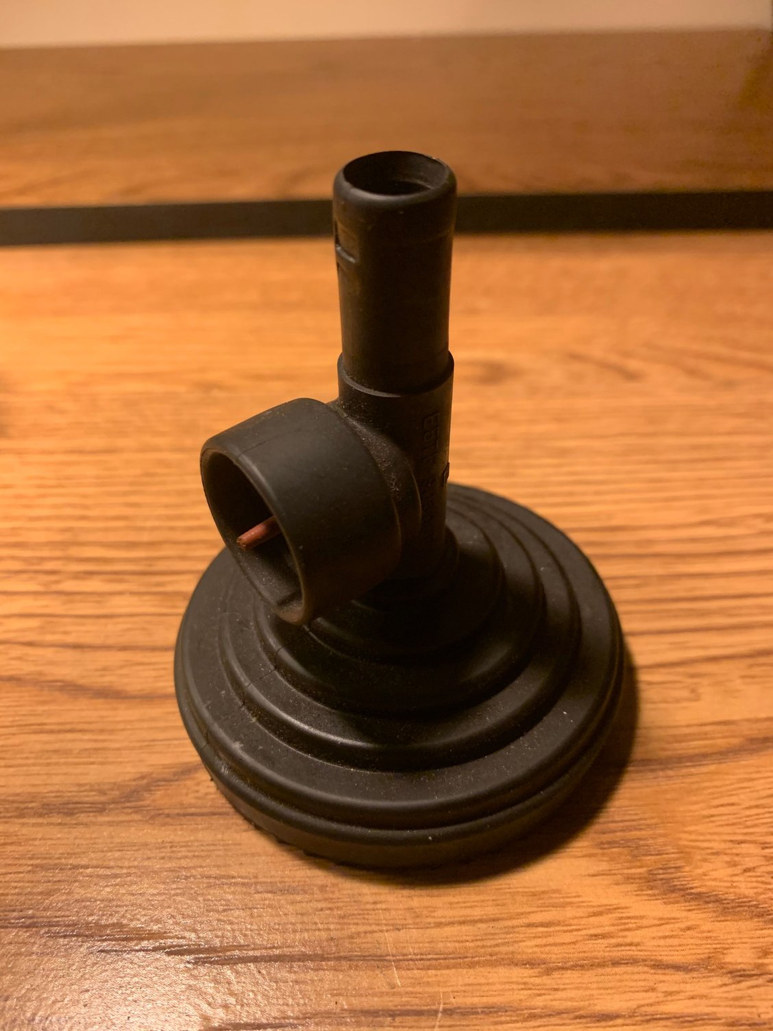

You mean the quick disconnects that are on the end of the hoses that connect the top of the pickup?
There are these. There are these.
I converted to AN fittings.

You mean the quick disconnects that are on the end of the hoses that connect the top of the pickup? There are these. I converted to AN fittings.
nice that's just what i was thinking about, changing them out to a better connector,those things are just a PITA!
