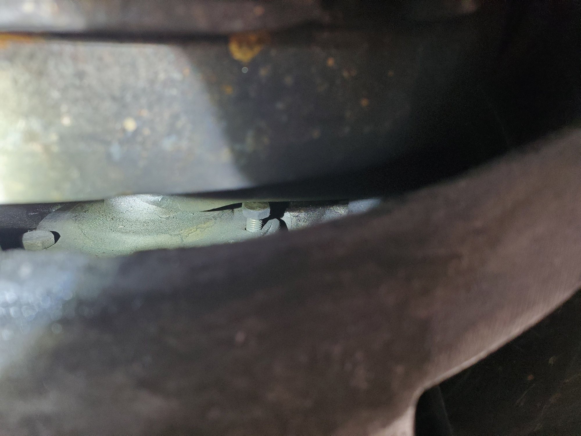

Howdy folks. I decided to pop the clutch cover off to see what kind of magic was under there. I also wanted to clean it out since I recently did efuel.
I'm curious about the clutch identify and also condition. I'm not familiar with them.
Is this the factory dual mass flywheel and clutch everyone's throwing away?
Also, I know I'm cursed, but how Fd does this make me:
Wanting to look at new injectors this winter or spring and was checking to see if i still had a stock clutch or not.

It looks like a dual mass to me, unfortunately for you.

Where is that loose bolt?

Guessing is one of the bolts on the snout of the trans where the TOB rides. Hard to tell from angle.
Clutch assembly does not look like my South Bend kit. I understand there are two single mass styles, Valeo I think is one and Luk other maybe? Been a while. SB uses the Luk style flywheel.
Anyway, you have a larger turbo kit with IC and would probably really awaken with larger injectors. Lots of guys run the typical 160/0 with the 13" SMF kit from Luk with success towing and such. They should be in the 340-360rwhp area I would gather. Past that, unsure if the friction material could hold up.

It is on the front of the trans behind the clutch. looks to be a front bearing retainer bolt. Not way to really get to it.
