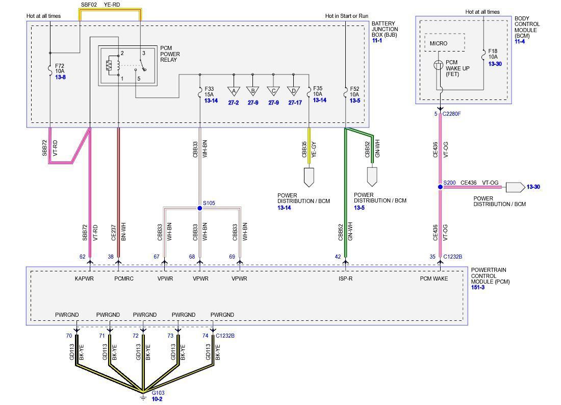

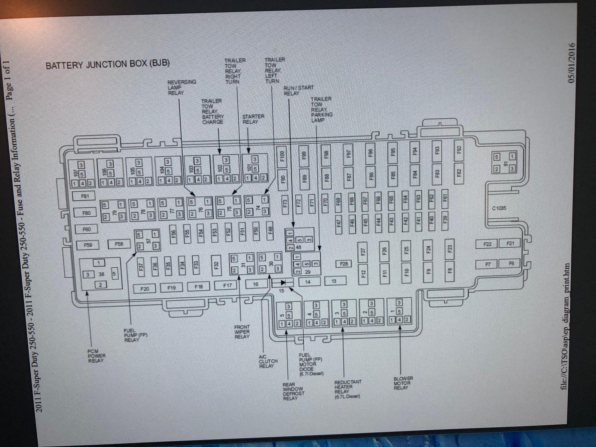

First of all I want to thank everyone ahead of time for contributing to the forum. Current Status No Crank No Start Glow plug light is not on, check engine light was not on but now is consistently. Warnings, Advance Trak, Trailer Brake Module, TPMS. I have attempted to pull codes SCT returns general errors. So far I have established their is no power to row fuses that includes #52 for PCM. Start Relay does have power, I have pulled Distribution, cleaned and checked wiring to include up to radiator. Checked harness at Parking Brake, removed PCM connectors and cleaned. Batteries are at 12.44V, jumped starter with signal wire connection next to battery and I am now at a loss where to go next. I thought based on wiring diagram the fuse bank that includes #52 was fed by start relay.

Is fuse 52 in the BCM or BJB?

BCM drivers side

Fuse 52 should be hot at all times.

Just not sure which way I should track the short. PCM relay is hot, chased harness towards radiator I did not see any breaks. Pulled positive cable and attached test light between it and positive terminal with a steady glow. So I have a short some where, I left light on a pulled all inside fuses no change.

Without means of finding the other DTC's easily, I would suggest looking to see why the ECM/PCM is not powering up? The U codes are communication errors. With no power on fuse 52, I suspect your PCM is not being powered up to communicate with the various modules on the truck. I would try to find out why fuse 52 has no power and then go from there.

@orion250 I appreciate the information, I actually found the issue and fixed. It was a bad connector on the Run/Start Relay. The logic behind manufacturers electrical systems does not make sense sometimes.
