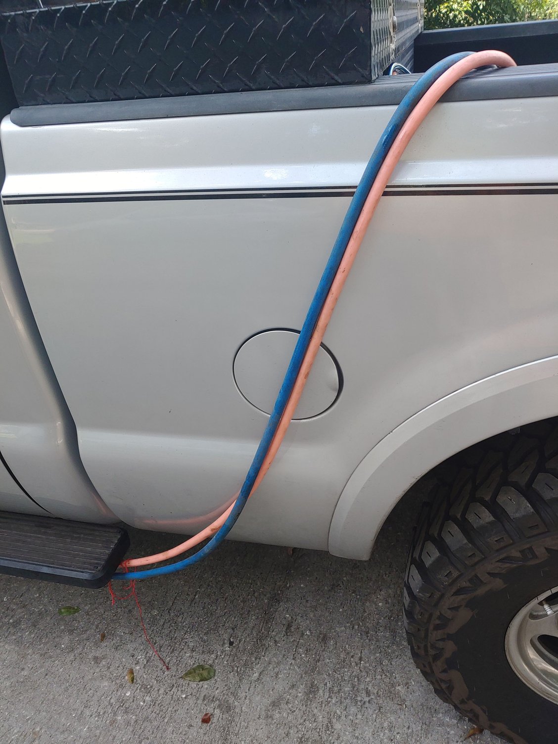

Both lines run to can. I went out and fpsiphon all the fuel out. 1/2 tank = 17 gallons. Took a while but tank is empty. Today I will drop it and take a look at the sending unit. I have a friend coming by to help. I am looking at a herko unit for $75, if I need it. The sending unit part of it seems to be fine, it's the pic up that is giving me the trouble. I'll take a corner or accelerate real fast and my pressure drops like panties at a Motley Crew concert. So I'm thinking the pic up foot is just about clogged. We'll see hopefully today.
Good thing is, I can drive the truck if need be with my can rig.

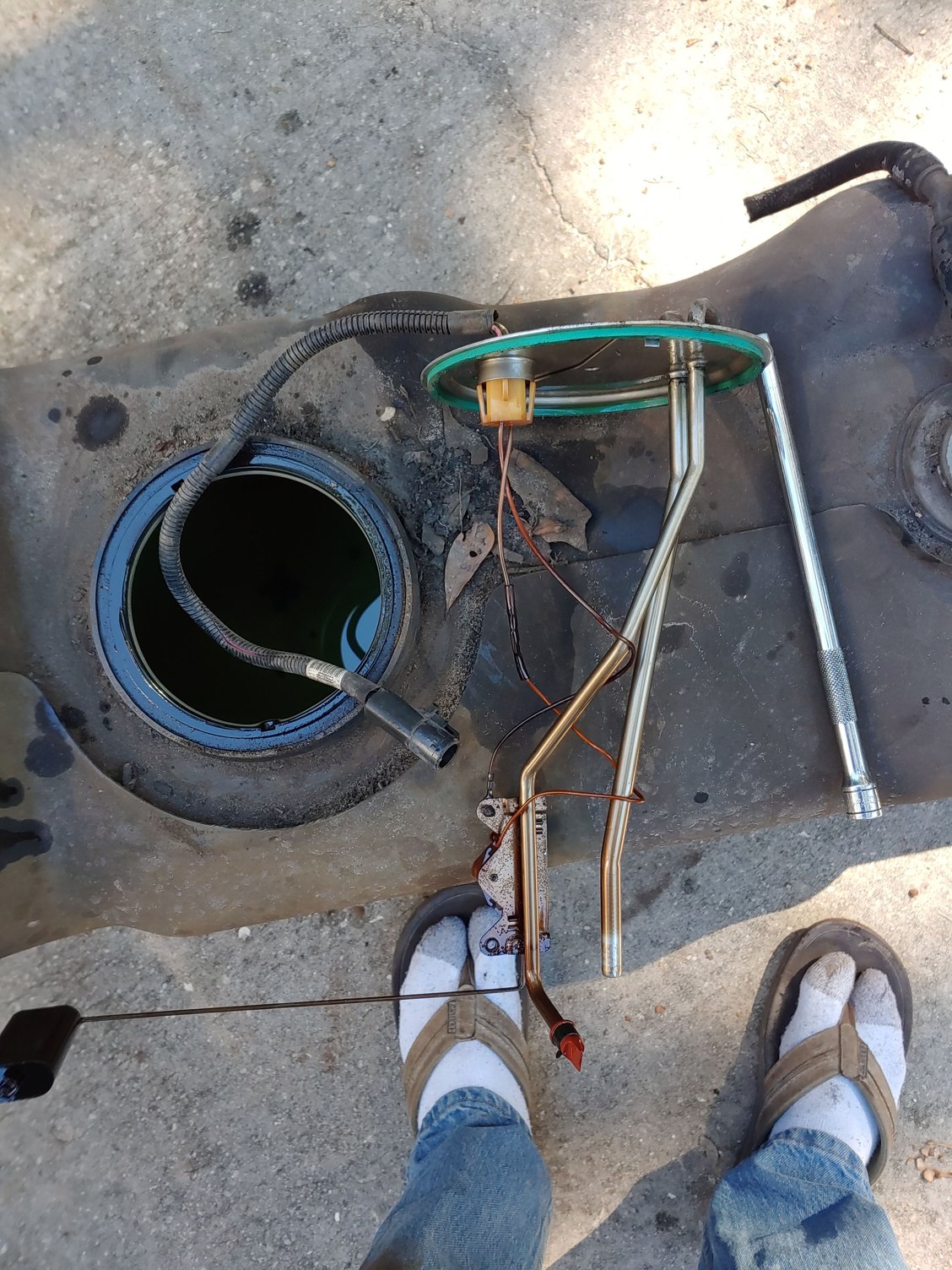

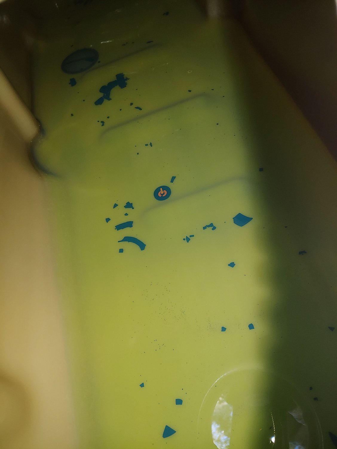

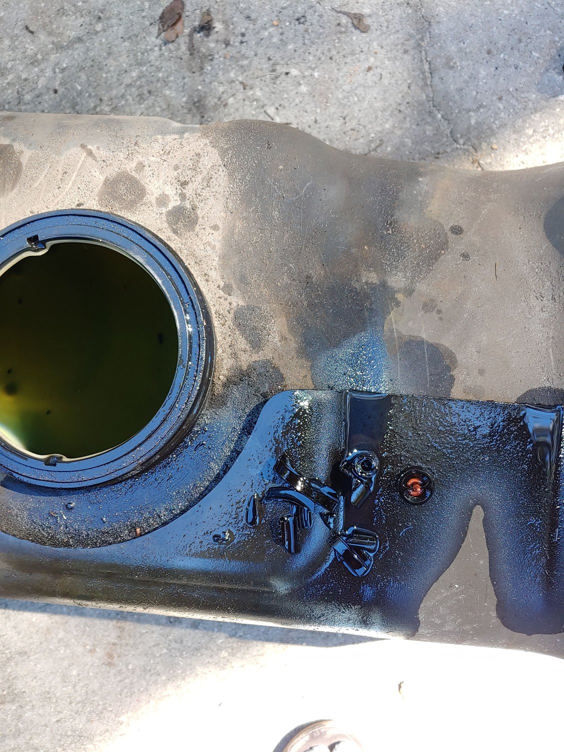

Well had a day off and time to pull tank. Not bad, but what an adventure. Did by myself. To all looking to do a tank removal. Be prepared to fight the two fill hoses. I think I spent more time on that than all the rest of the job. I got the 3" off after about 20 minutes of prying with a screwdriver to loosen. 1"1/2 hose, not so lucky. Cut it and will replace.
The problem, as we all guessed was the foot disinagrated and is in pieces in the tank. It will take some cleaning and a new foot. I might just buy a new unit altogether.
took some pics.
One good thing is there was very little, little water in tank.
You can see filter screen in back of tank.

Would have been a lot easier if you had disconnected the top of the filler neck from the bed, although the hoses probably needed replacing anyway.
While it's apart you should blow out the lines from the HFCM end to make sure you didn't get any pieces of the foot in there.
Also, it will make assembly easier if you were to replace the balance tube with a fuel hose.
