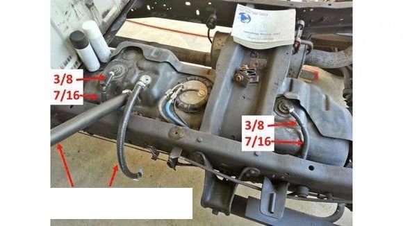

Unless its in my "Fuel Pressure" thread I can't verify the sizes of the hoses I used. Maybe David can provide that info when he gets there..

38" and 3" piece of 7/16" fuel line. I reused old vent, had trouble find something to match. Waiting on my foot.

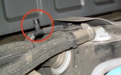

Not sure it makes a difference, but the vent was at the front barb and it was upright on mine.

I think your Wright. Not sure if it does matter? I'LL probably switch it though. If not, it'll drive me nuts thinking about it. Or worse blame future problems on it. Good catch Thanks.

They always face up.

See on that pic it's on the fill side of tank. Does it really mater witch side the valve is on? I'll check to make sure valve is pointing up.
