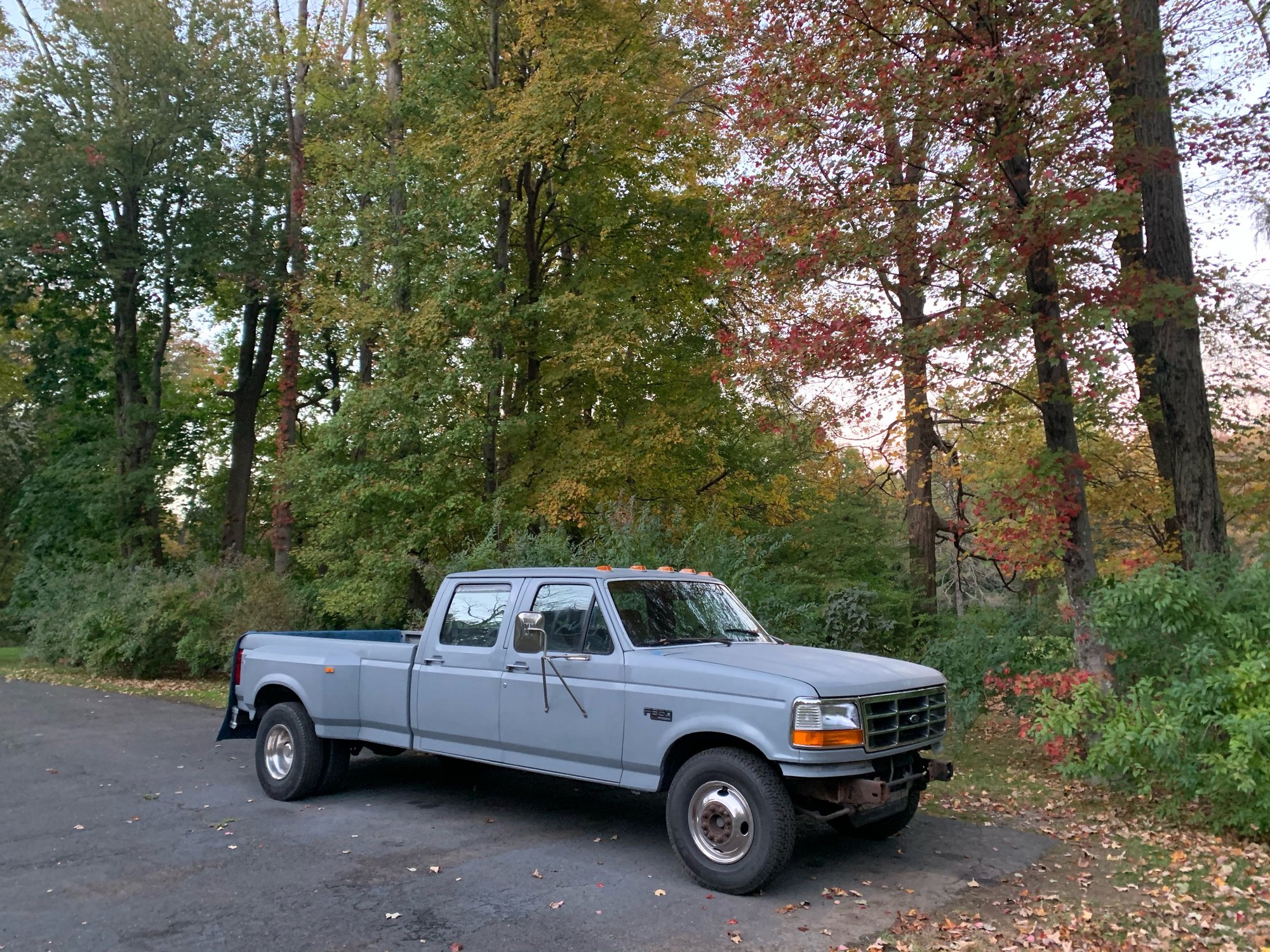

Having a strange problem with the cooling system on my 94.5 7.3L. This is a project truck... gets started up every once in a while, but hasn't made any real long drives in the last couple of years... mostly just around town. On short drives, my temps stay low - but on a recent dump run, temps started to creep up towards "L" on the gauge and I quickly turned it off to let the truck cool off. Last year this truck had a leak from the water pump, so that was replaced along with the up pipe. When i opened the hood after running hot, i noticed the upper radiator hose was kind of hot, the lower radiator hose was kind of hot, the water pump area was hot, but the radiator was ice cold. Opened the radiator cap and the coolant in the radiator was cold. The only warm area of the radiator was where it meets the upper radiator hose. The coolant system had pressure this whole time, coolant is clean and green, and there are no coolant leaks from the truck.
At first i thought i had air in the system, and i was able to purge out so bubbles by squeezing the radiator hose... but this hasn't solved the problem. I'm leaning towards the radiator being clogged up... but could it be that the new water pump that was installed is faulty? Any advice would be appreciated, and a picture of my truck is below.
