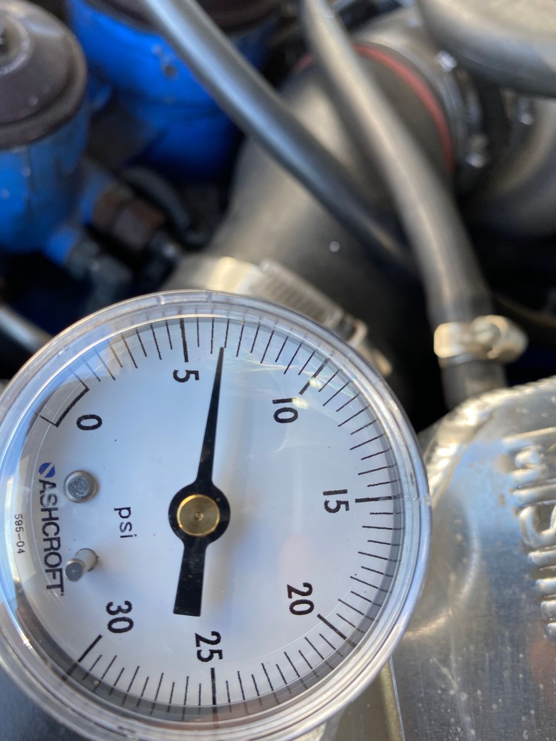

Just a quick thought while im out playing on the truck atm. Would stuck thermostat do the same thing?? When i squeeze the upper hose despite being filled to the full mark it sounds completely empty through the tank. I know itd cause over heat issues bit never saw temps get over 230 pulling that trailer since the fan kicked up to 3krpm then with the trailer. Way back it never went over 198. But with it idling right now to warm up that hose doesnt sound like its filling.

Waterpump was replaced in the spring with a bpd pump. but last time i changed the tstat was when i first got the truck in 2013. (Cant believe its been that long).
Just got back from running down the street and highway.
first 2 are from when i was empty. Temp 192-94
Only thing i had weight wise was the trailer. Hooked it up and took it for a run down the highway. Coolant temp went up a lil 196-203 was the highest i saw it get. And highway here are 70mph i was doing 75.
Trip back i romped on it a few times. Spun the duallys one of the times.

Was the close to 15 after the romps?
not right after. But close to them. I romped on it couple times going out. When i took the one one showing 9psi. Stopped let the pressure bleed off. Coming back i did a few more. Last romp was a couple miles before reaching the house. When i took the last pic showing close to 15

Over the last 2 hrs sitting there cooling off its dropped to 5 psi.

Check the pressure under load, install the gauge in the cabin.
Mine:

I’ll just say it may not be as conclusive as you hope if the leak is occurring only under normal temp with a load.
