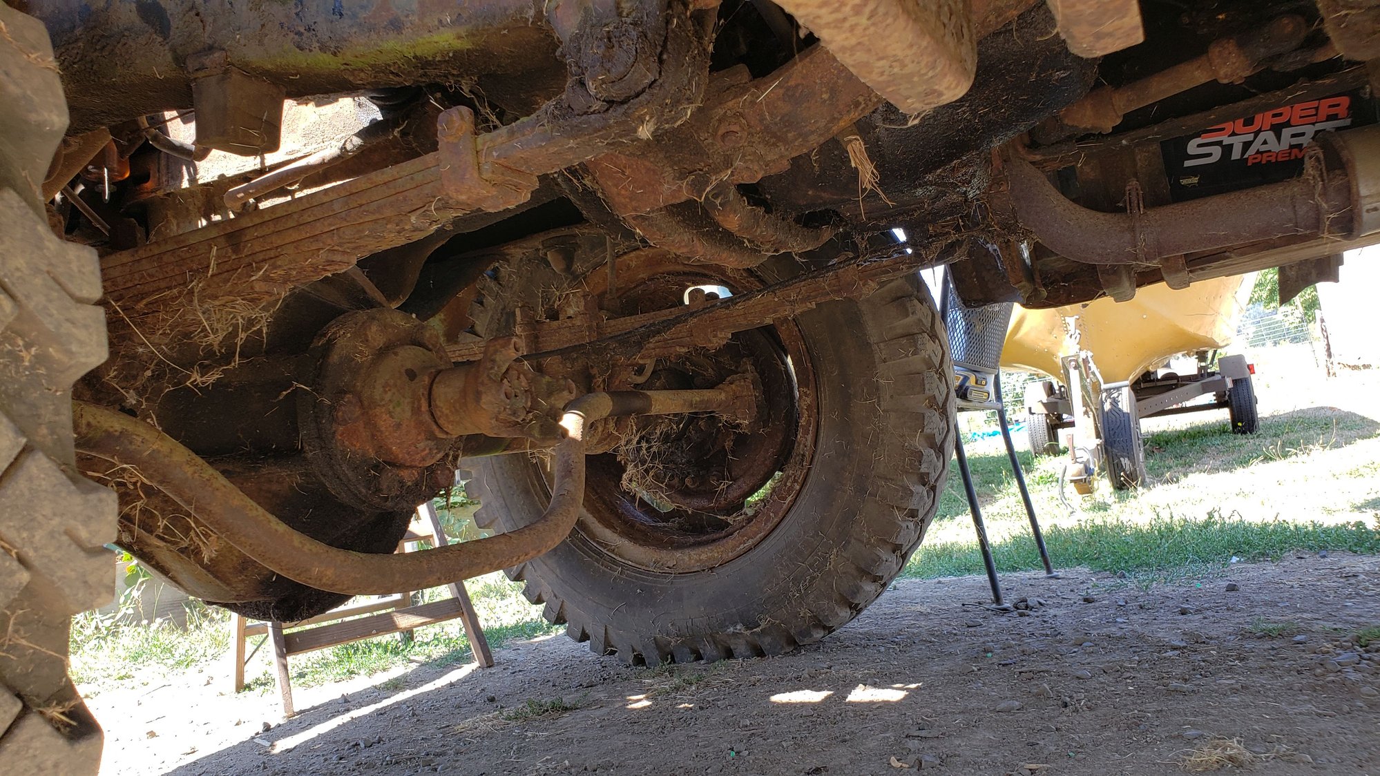

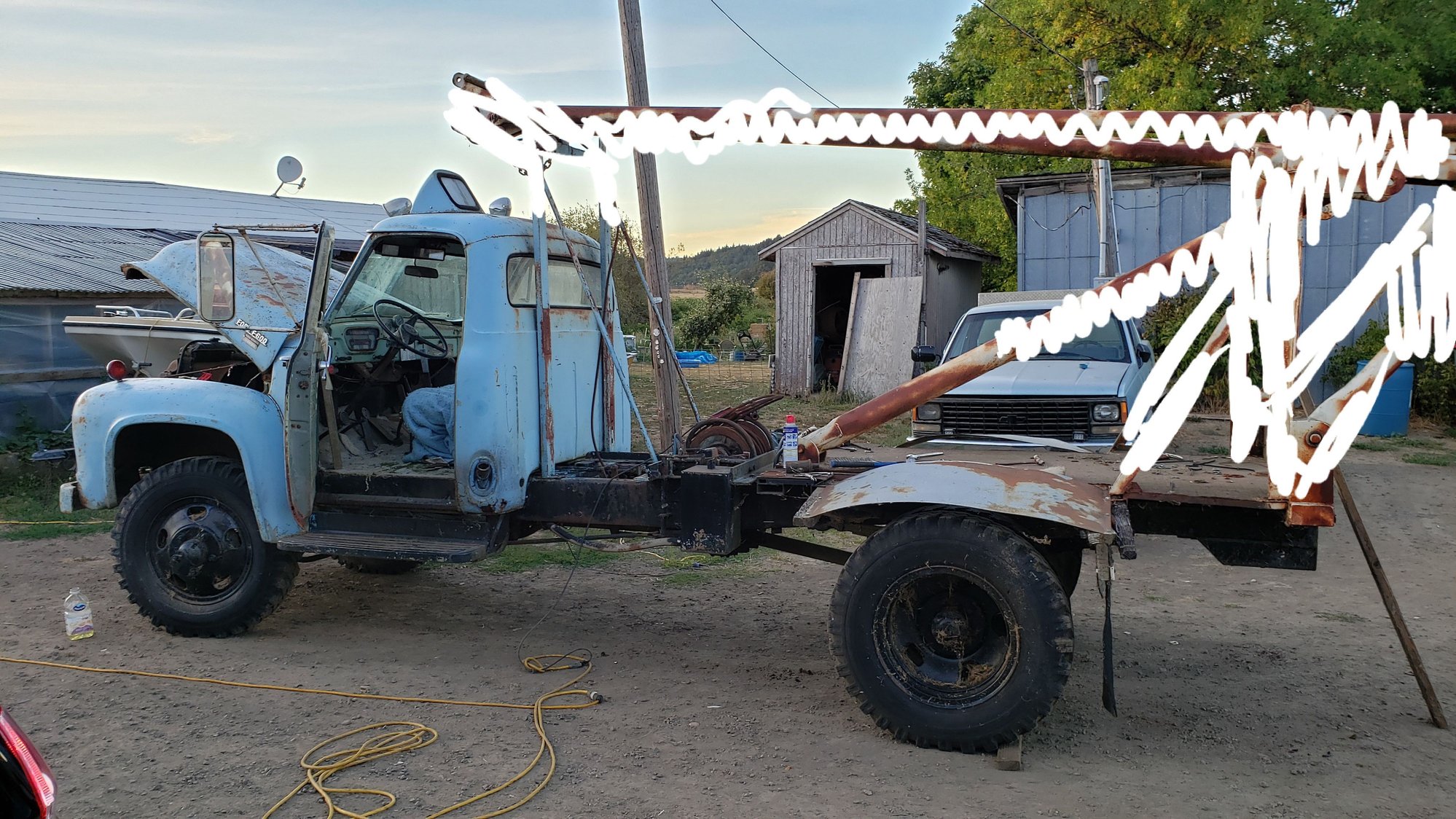

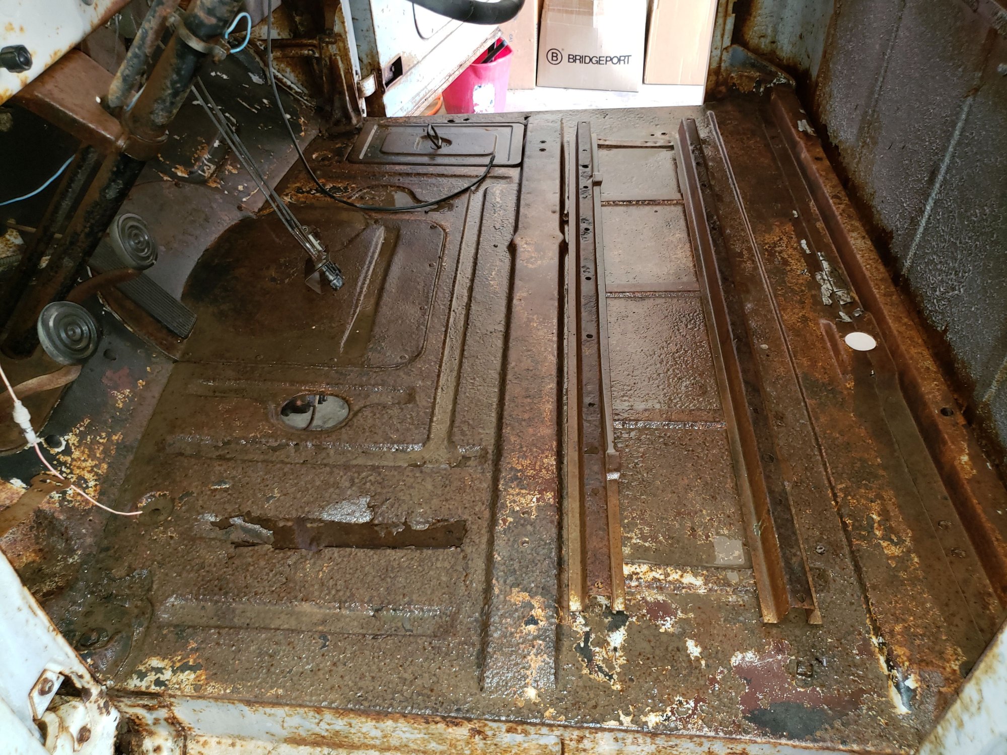

I own a 1954 F600 Marmon Herrington. Bought it last month. I also own 2 1956 F100. 1 is original. Other is modified. All of them are not road ready yet.
Need help on the F600. Just bought a 1990 D350 with a decent 12 valve Cummins. My F600 is manual transmission. The 12v is automatic. I want to keep the F600 MH parts on the truck. Can I use the F600 transmission on the Cummins?
I want to keep it as close to original as possible.

Attachment 277521

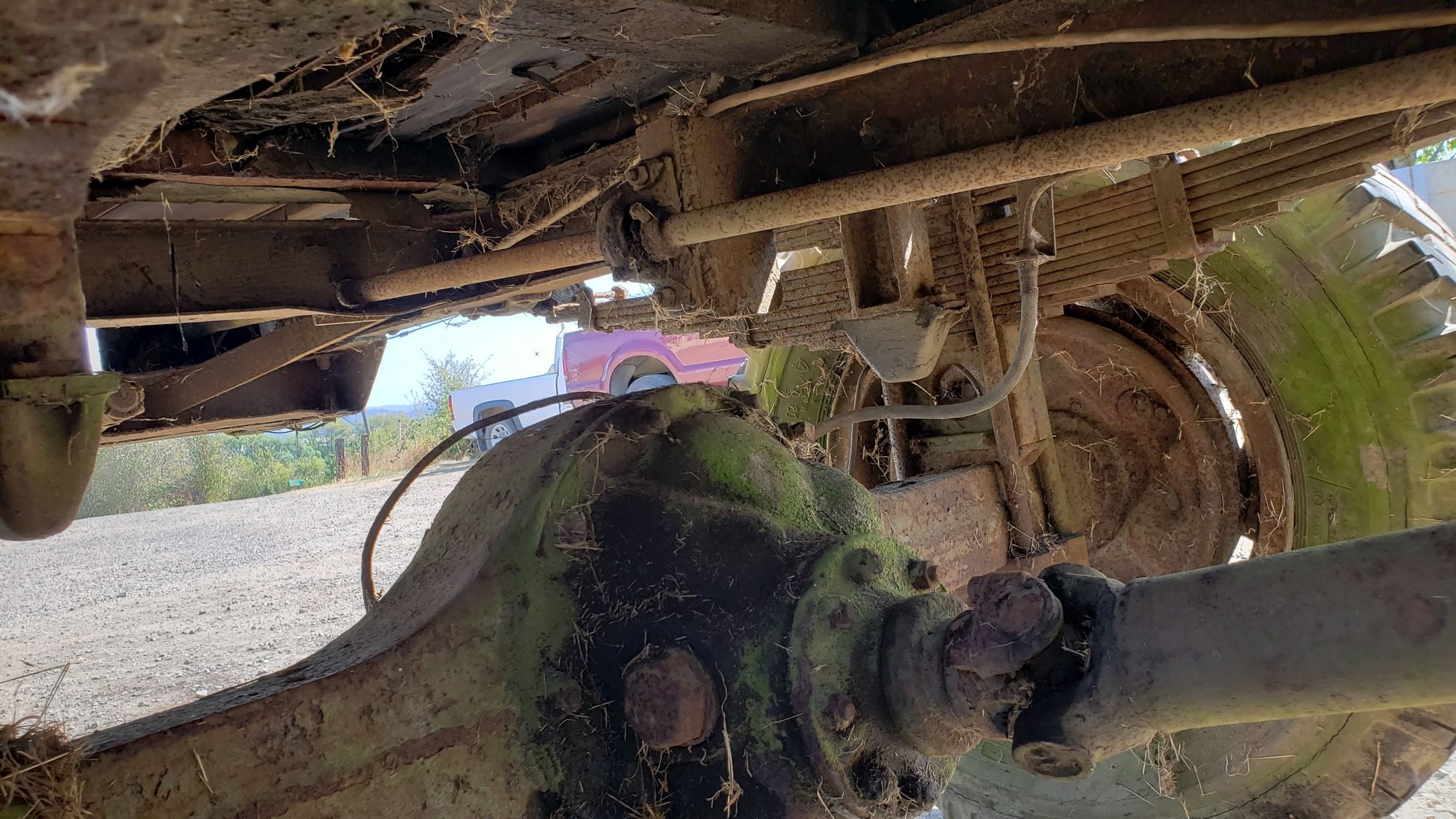

I say find a good Y block. Put it back like it suppose to be. What you want to do I think
you will be sorry because of the Marmon low axle ratios. These trucks were not for
highway speeds they were for off road. Diesels operate in a lower RPM range than a
gas job. With a diesel it will be maxed out at 40 mph or there abouts. There are no
high speed ring & pinions I know of for these Chucks truck will know. There is a way
out either a Yblock or a 302 with automatic over drive, or a 5 speed overdrive tranny.
Even a light duty OD tranny don't forget these have Underdrive it will still pull stumps.

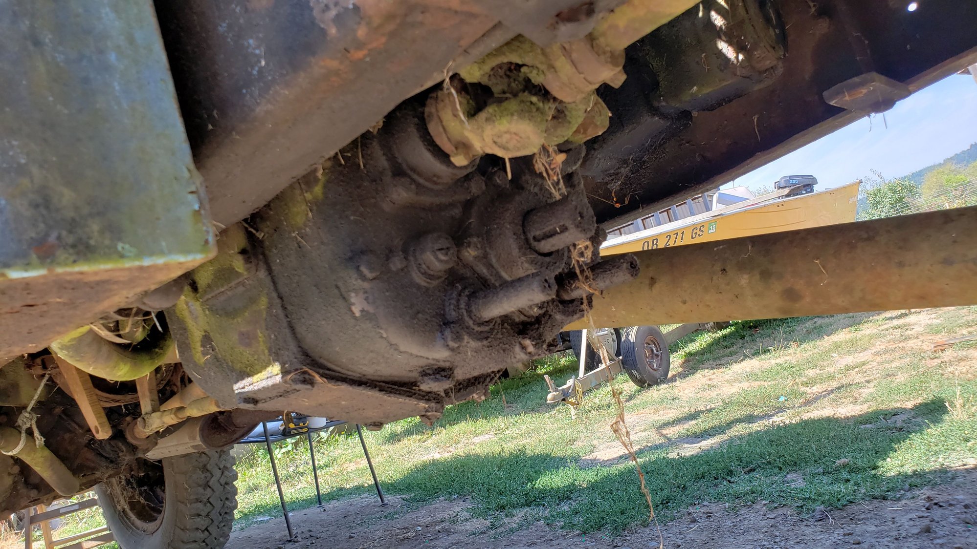

Then rebuild the 312. ( I highly doubt it is a 312) it is probably a 272 or 292. I’d like to know where all the t- birds are without engines are?
you pit the Cummins in there and you’ll find out that the transfer case with straight cut gears is the weakest link
I vote for keeping the y block even if it’s a 312. It is period correct

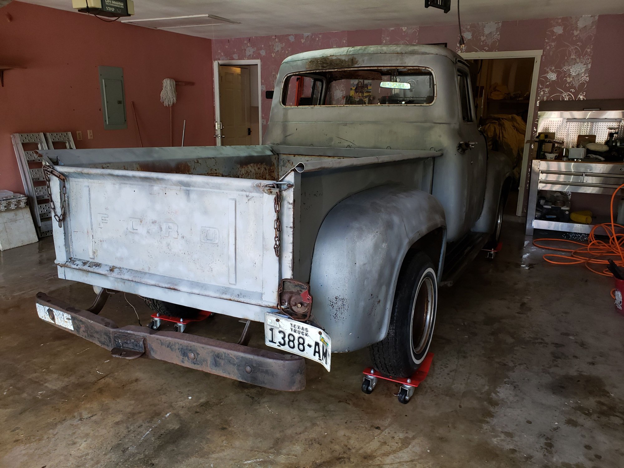

New question. Can I take all the Marmon Herrington 4x4 parts and put them on my F100, since I own an original 1956 F100 with a stock v8 and 3 on the tree.
FYI, I love these trucks and would not sell, but, I am an investment manager by profession so it is always part of my decision process.
I can't find an original MH from 1956 so, this is why I wanted to convert initially.
