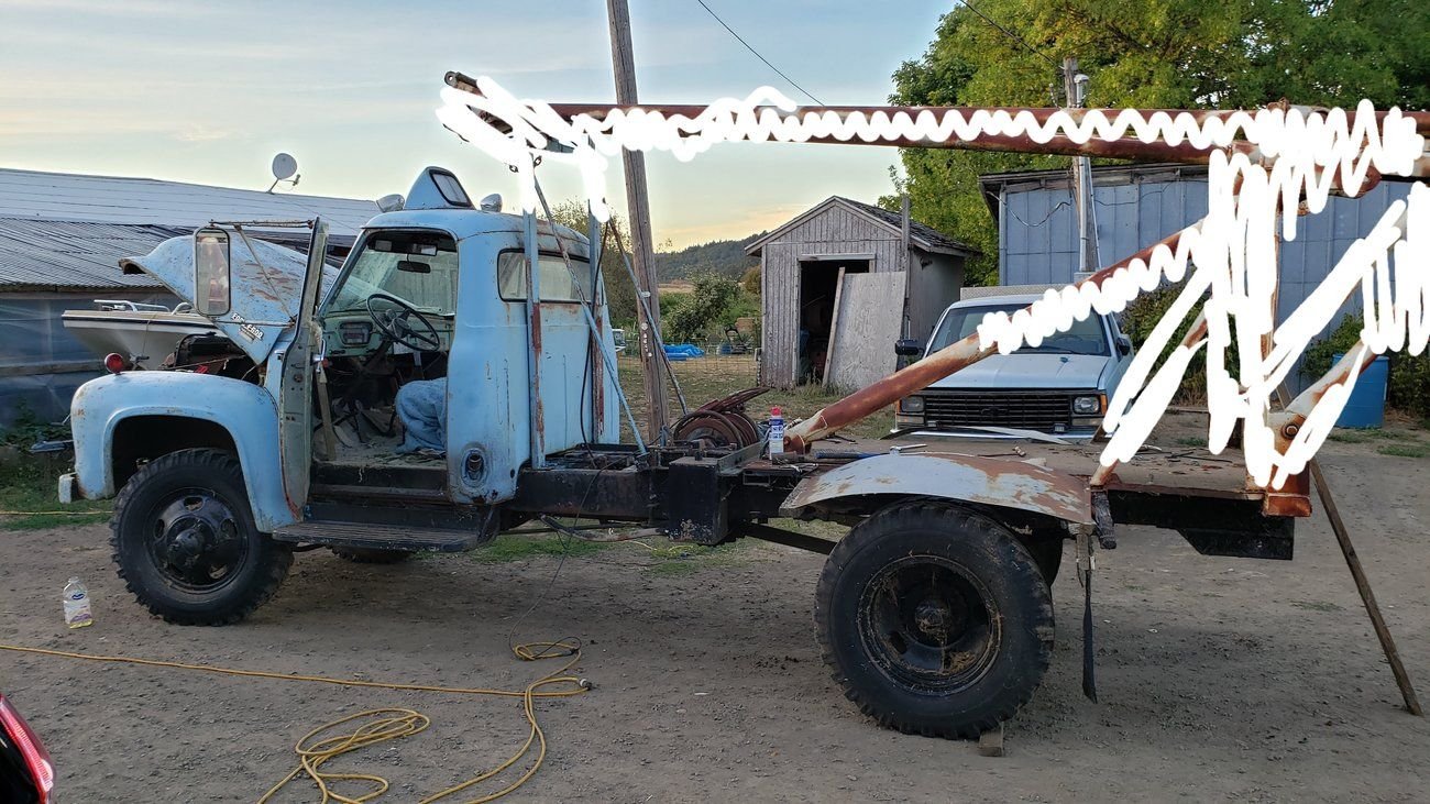

Now, what do I do with the bed? Specifically, the section over the dually wheels? Any suggestions are greatly appreciated.
Old Oct 11, 2020 | 11:48 PM
abe's Avatar
abe
Joined: Dec 2000
Posts: 25,376
Likes: 5,386
From: Central PA
Here's a picture of your truck showing the bed.
My recommendation is to take the boom off and put on a period correct flatbed.

There is a flatbed on the truck currently. Also, there is a gap area between the back of the cab and the PTO wench system.
The truck was built specifically with the boom, and the bubble on the hood (it has a mirror in the bubble to observe the boom). From what I was told, this farm was the first and only place the truck was operated from and it was special ordered from MH to use as a log cabin builder.

We have already removed the boom, brackets, and hydraulic piston...
Currently, it runs and drives pretty well. It is a stick shift and it operates. The front half shaft was removed but the original part is in the truck and I can have them put it back on and test the front drive. I'm told it all should work. Breaks are leaking but do operate. Overall there is not much it needs to get it fully operational.
As for the PTO systems, I do not know if they operate or how to operate them. But, I can get them oiled up and tested.
Please let me know if I should put money into this truck or sell it as is?

Yes, by all means put money into the truck! LOL... its not my money so go ahead.
You could sell the winch if you aren't using it.
Or you could have a set up like Don's:
