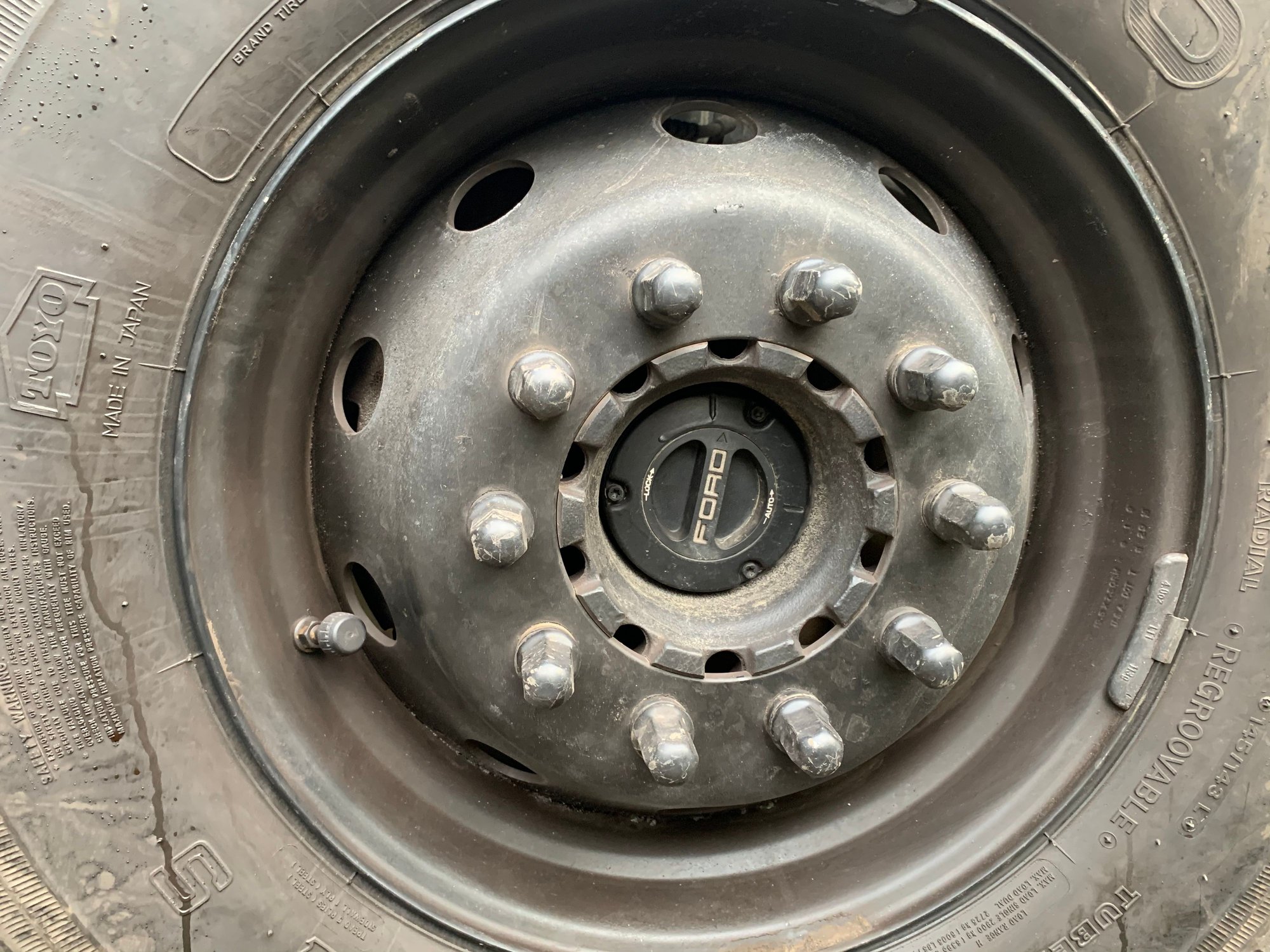

Unless your truck is a show queen, I advise not to over think it. I just snapped this pic of mine. 50,000 miles and 3.5 years ago I used a rattle can of rust oleum satin black on the hub. Used blue tape on the selector **** and an xacto to cut the tape along the seam. Didn’t even remove it from the hub, just taped the center and sprayed in place 3-4 light coats. Haven’t touched it since, other than the occasional pressure washer high power spray down. (Btw-what looks like a run in the paint is dirt - haven’t washed the truck for a while). Just spray it and be done.
