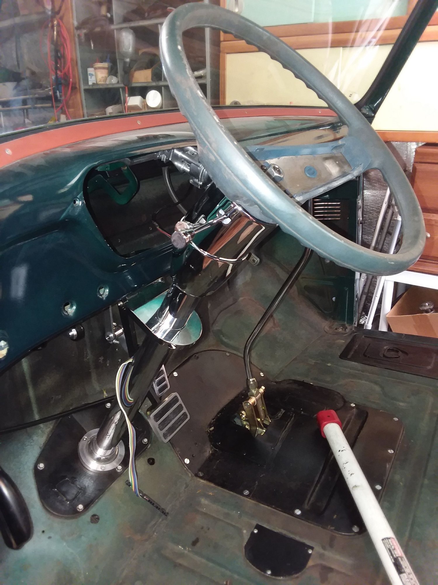

Steering drop
I always use a 32" column tilt wheel and floor shift --stock seat -- I use a 4" drop-- here is one I am building now showing column--
