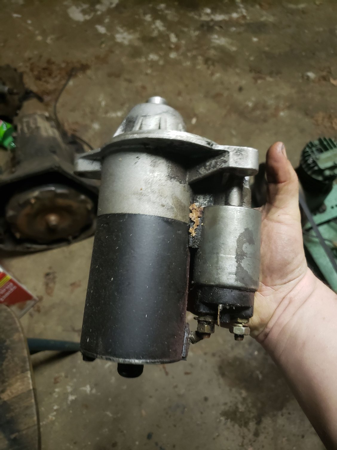

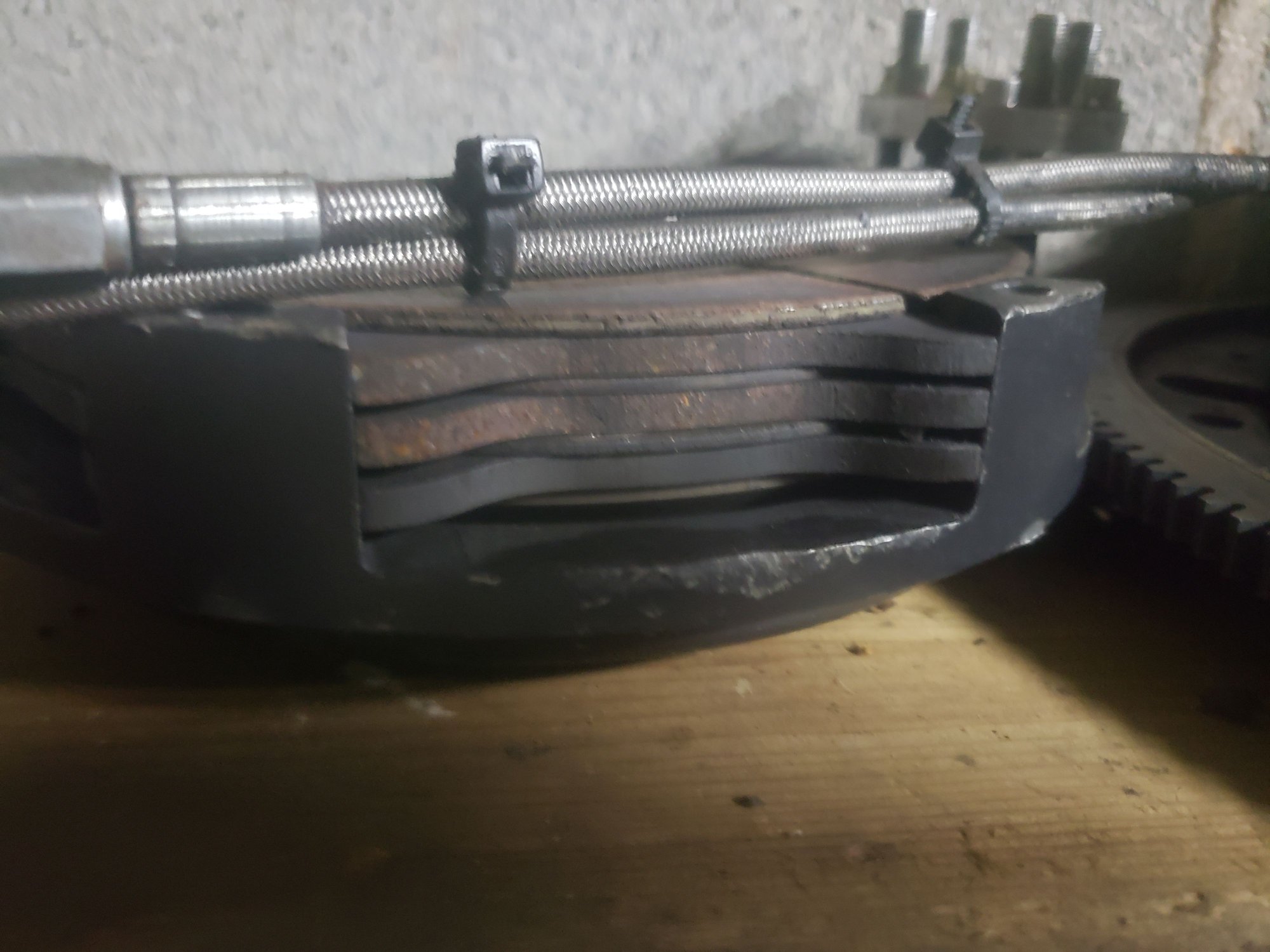

When i bought the motor the race team was running a triple disc clutch. The flywheeel is alot smaller than a regular flywheel and bolts to a automatic flywheel. So it had two flywheels in the bellhousing. The starter they used was a mini high tourque starter but it fits automatic flywheel. I am using a stock manual transmission and stock manual flywheel.

This is the starter that came with motor fits auto flywheel
Triple disk clutch and mini flywheel bolted to auto flywheel
Triple disc clutch
