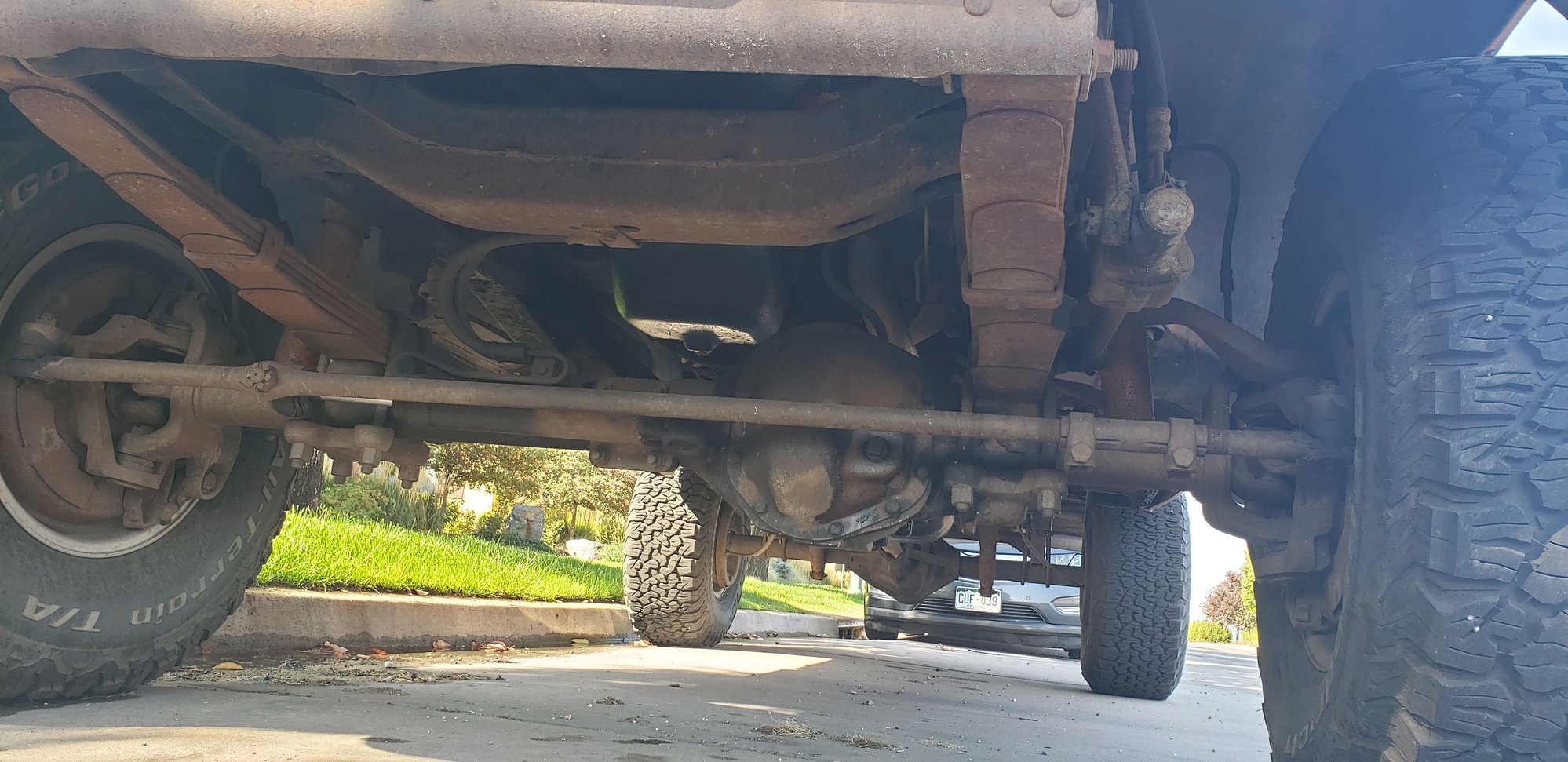

From the pics it looks like you rebuilt the front end. Are the knuckle bearings good and shimmed correctly on each side?
Old Oct 9, 2020 | 08:49 AM
Casey Hope's Avatar
Casey Hope
Joined: Sep 2017
Posts: 200
You are correct the front axle is rebuilt and all berings are brand new and shimmed.
