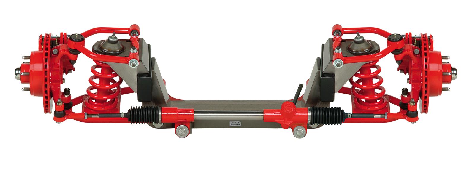

What do the lower control arms look like? They should be level with the ground. I'd like to see pictures of this, as well. The spring should be a long way away from the ball joint. Are you sure the spring is seated correctly? Pictured is a Heidt's setup, and should be what you want to see.

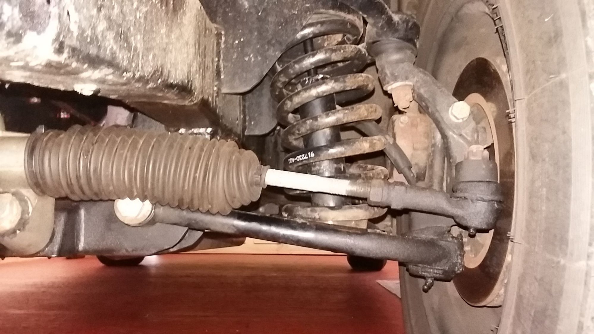

Good morning and thanks for both your replies. I have been here before..I posted some pics a year or so ago before I installed stock springs. To clarify.. ..it is the distance between the top A arm ball joint mount and the coil spring and tower. I have attached a couple of photos I took this morning. The Speedway kit was fitted by a pro builder over here, before I purchased the truck. My set up looks way different than the Heidst photo. I should add that I am no engineer or pro mechanic.

Are these current pics? or before the spring change pics? The lower control arms are way slanted and that will never work. The lower control arms need to be level with the weight on the truck. If these are current and all the weight is on the suspension, your springs are still too stiff.

What I meant was exactly what you're looking at. The geometry is all wrong. The suspension cannot work as intended all jacked around like it is. You have no way to dial in the correct wheel alignment. And just because the ride is less harsh than it was doesn't mean it's good or right, or that ride and handling won't be improved if set up properly.
