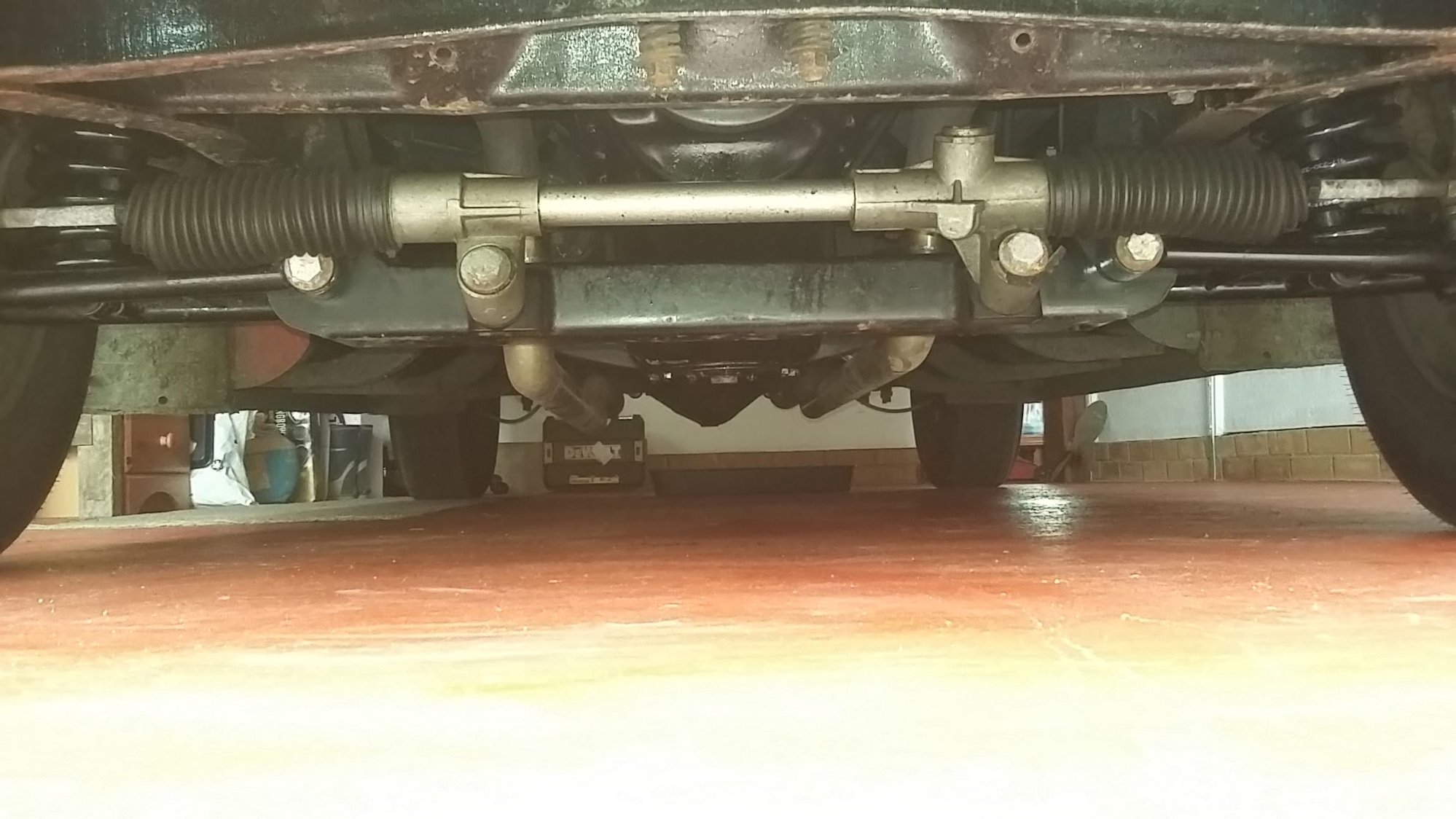

Old Mar 8, 2021 | 09:57 AM
Suffolkman's Avatar
Suffolkman
Joined: Mar 2018
Posts: 248
From: Lindsey Suffolk England
Hello again from the UK. Just thought I would update the is post, after all the help from members on this problem. I started seeking advice on which spring rate to use, and getting wildly different suggestions from several companies. I of course realized that nobody was going to guarantee their answer was going to do the job perfectly. Finally I found the Old Ford Store in Tuscon. They have been fitting M2 kits for years. After chatting for a good while with them they suggested 325Lb springs would be what they would go with. Long story short...I have just fitted a pair and they are pretty much spot on. (See photo) The lower control arms are still pointing slightly down, but I am hoping over the next few months they will settle a bit more and be spot on. Thank you again to all members who posted comments to me.

Old Mar 8, 2021 | 10:01 AM
56panelford's Avatar
56panelford
Posts: 283,683
Likes: 8,269
From: northwestern Ontario
Looks dead on in that picture, glad you got it all sorted out and able to enjoy the ride..
Old Mar 8, 2021 | 10:38 AM
52 Merc's Avatar
52 Merc
Joined: Oct 2009
Posts: 16,173
Likes: 4,780
From: Burbank, WA
I agree that looks excellent. New springs will settle about an inch or so, so I'd say you're right on the money. Give it 500 miles and keep an eye on it. The bigger question is, how does it drive now?
Old Mar 8, 2021 | 12:17 PM
Suffolkman's Avatar
Suffolkman
Joined: Mar 2018
Posts: 248
Thanks for the response. I have only driven around ten miles or so at the moment. But already it is much smoother over bad dips in the road. So fgar I am very pleased with the result.
