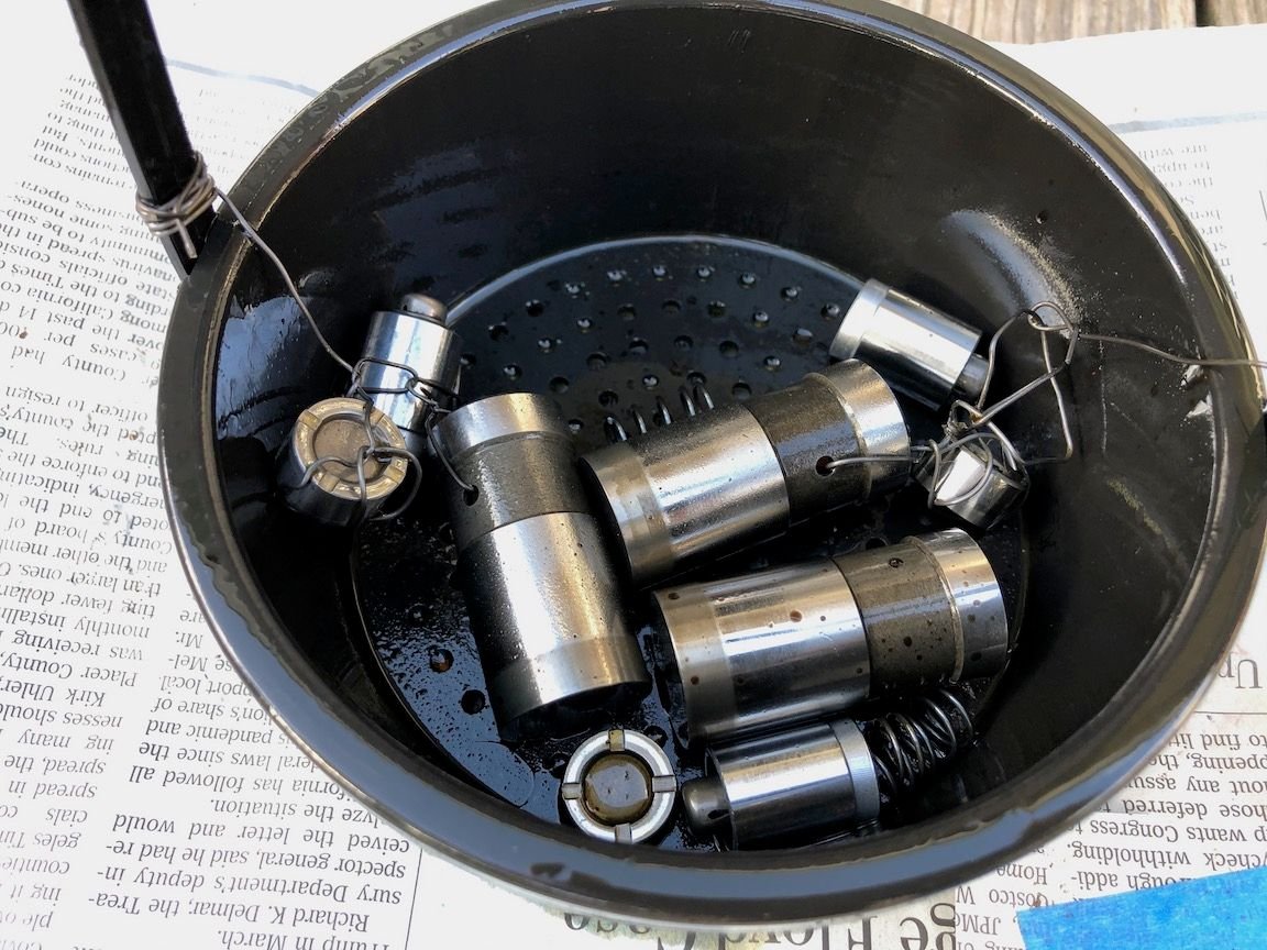

Great info! - I pulled all lifters and shining a flashlight behind a steel ruler clearly shows some concave profile, very small I would say no more than 1/2 mil. I also pulled out the timing chain cover and found lots of play on the chain. The truck appears unmolested. I've found FoMoCo stamped seals and gaskets. The cam sprocket is actually plastic and had a broken dent, so the timing was perfect and already replacing it. Both sprockets had their index marks pointing up, I was expecting facing each-other as some youtube videos suggest.
I would love to change the cam and lifters but I'm not comfortable with that as I don't know the head's air flow specs to select a cam and don't know what are the cam's OE specs to find a replacement. Its not my daily so I think that the way the lifters are I can probably get 10K miles before I need to rebuild the engine which means 1 - 2 years and I'm probably good with that.
If you happen to know the OE cam specs I'll be interested.
The second picture shows the results with Chem-Dip a lot easier and more effective than gasoline and Seafoam engine treatment solutions.
Thanks

With lifters that worn the cam will be beyond the point of putting new lifters in. You have no choice but to do the cam and lifters. Just throw an RV grind cam at it, and you will be fine.

Those lifters are shot. which means your cam is shot . which basically means you need a rebuild.
But you're probably right it should hold together a while longer. if you're not going to fix it right why waste money on parts you're going to be pulling back out before long would be my thought.
