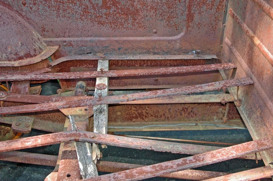

Based on what I could determine from my truck as it came to me, I finished the bed floor in clear spar varnish with stainless steel skid strips (which are what is available). I had only one small piece of the flooring about 2 feet long that showed no signs of paint or color anywhere. The steel skid strips which were all badly rusted also showed no signs of paint or having been protected in any way. Just for information, I am attaching a couple of pictures of what my truck's original parts looked like.

Try contacting James Wagner and asking him. He is the Commercial vehicle restoration advisor for the Early Ford V8 Club. The club publication, the V8 Times, prints questions and answers in the back of each issue that may be interesting to other club members. Searching through the index I found a couple answers from Wagner that may help. Apparently Ford changed the stated wood used in beds from "hardwood" to "seasoned wood" between 1935 and 1936. It appears that Ford was using inexpensive wood in bed construction, not more expensive and pretty hardwoods. The furniture like finish of many truck beds and stake side is simply inaccurate.
One of the references I found, July-August V8 Times pages 65 & 66, was regarding the bed for a 1941 3/4 ton stake truck. Wagner stated that all of the bed parts, metal, hardware, and wood, were painted body color. This matches my memory of the very few original wood bed floor trucks I have seen with any paint left visible, both stake and early 122 wheelbase pickups. Again, best to contact Wagner directly for verification (join the V8 Club and ask questions!).
