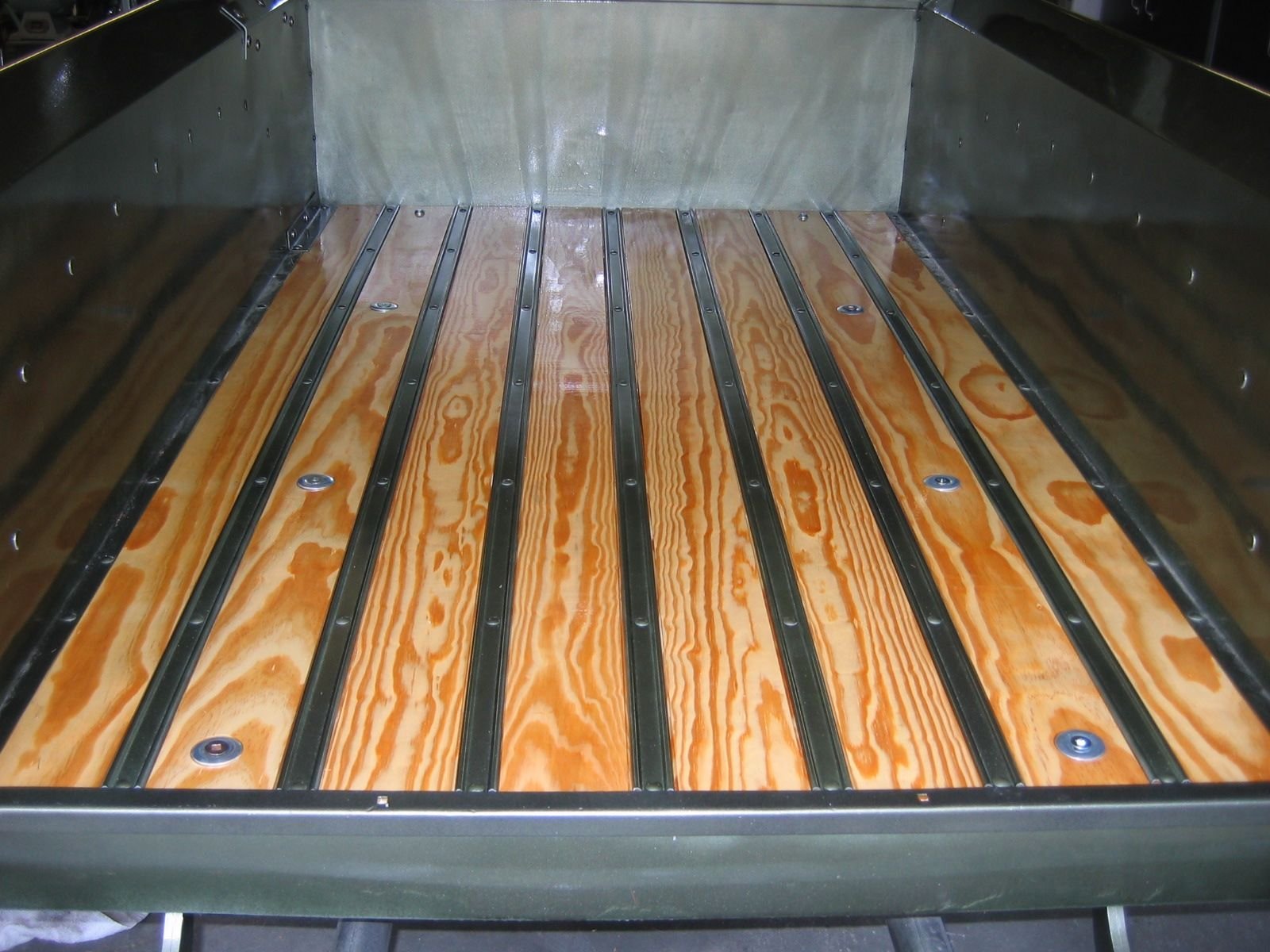

There are gaps between the boards that allow the bolts to pass thru. The strips sit in a dado'd groove. Go to Mar K website and you will see good diagrams of the floor. This one is Southern Yellow Pine, made by me.

P38 your bed is typical of what most people have and similar to what I currently have. Its my understanding that in 64 Ford did not use the metal strips. I would like to see a pic of a 64 bed as it came from the factory.

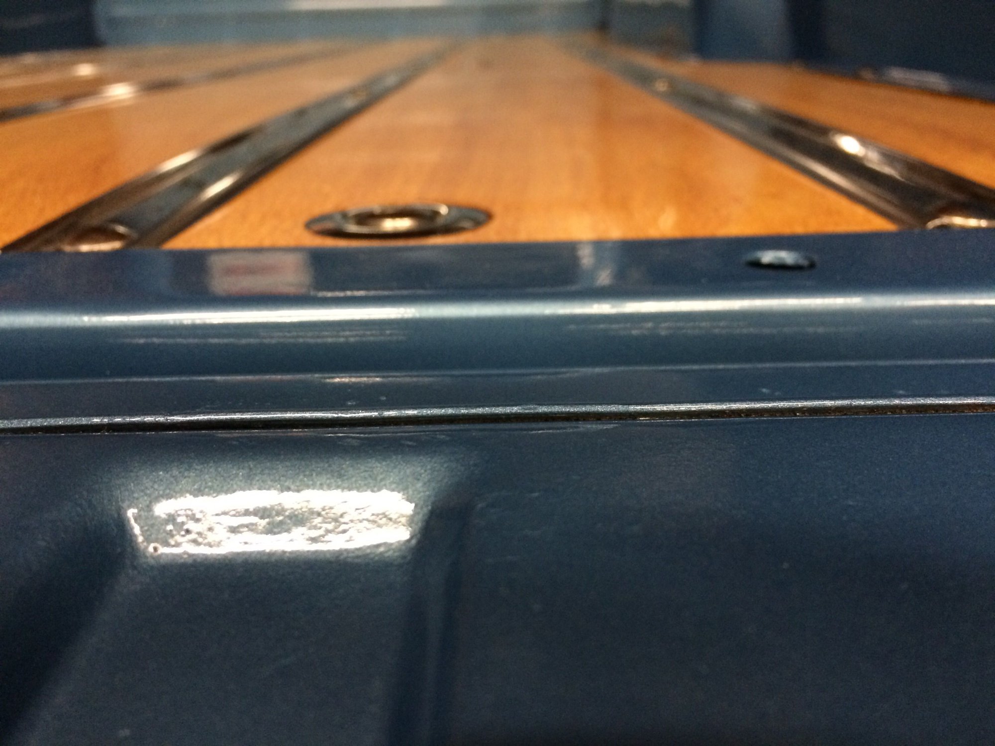

Here is mine from a year ago. I had to leave the truck outside for about 3 months. Now the wood is dry and has some minor cracking and the finish is in poor condition.
I can repair and refinish the wood, but its a lot of work.
Im even considering a tuck and roll cover to go on top of whats there now.
Since I don't haul anything, I can pretty much do whatever I want to the bed floor.

Looking at my bed picture, I have 6 large bolts that hold the bed floor to the frame.
4 of the bolts have washers, the 2 front bolts do not. Is that correct?
Should the washers be countersunk in the wood? Mine are not.
Those funky square drive bolts are a PITA to remove. I had to grid down a 3/8 extension to get it to fit in the square hole. One of the bolts isn't coming out, I will have to cut the nut off the bottom of it. I have never seen stainless steel bolts that are so hard to remove and I used SS for years in a marine environment.

That's how my dividers are installed. The bolts go between the planks and into the cross braces.
I also have 6 bolts that go through the wood into the frame rails. Those bolts go through a 1 3/4in washer.
My question is if the washer is countersunk into the wood or if it lays on top of the wood.
If you look at the pic of my bed in post #4, you will see the bolts I am referring to.

My washers are about flush with the wood

Yes, they were countersunk. One of the bed companies, I think it's Mar K, sells all the bolts and countersunk washers and even the drill bits I think.
http://www.mar-k.com/Catalog/PDF/Ins...es_1-2_ctr.pdf
If you search on their website, I'm pretty sure you'll find what you're looking for. I am redoing the bed on my '65 and opted to eliminate the 6 bolts that go through the wood.
Also yes, your '64 came with pine slats and steel strips and they were all painted the color of your truck. On mine, the green paint was on the top and bottom of the original boards. The stainless steel strips are an aftermarket invention as far as I know - but I think they usually look good. As for the wood, I'm using hickory and soaking it with tung oil.
