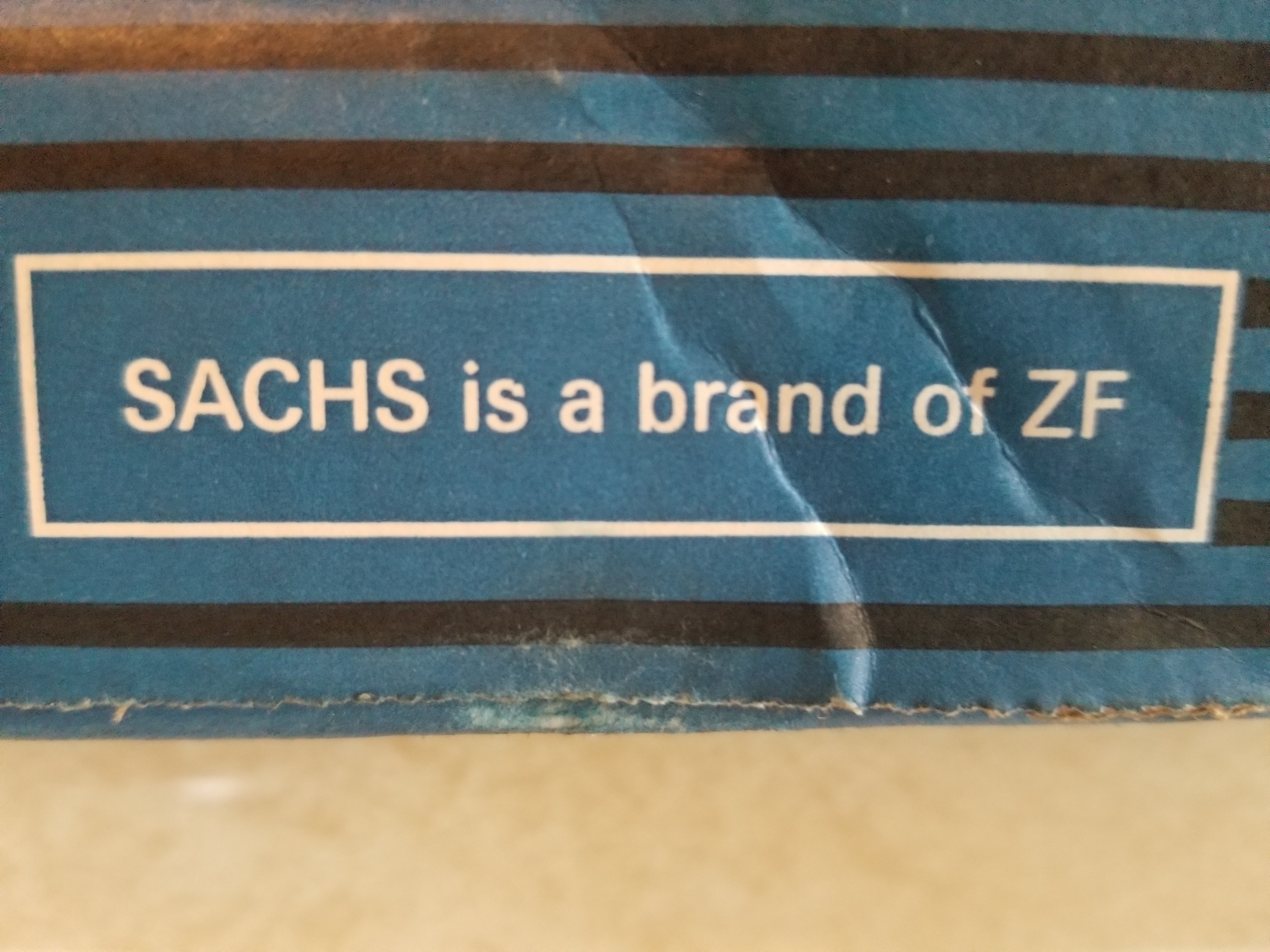

Hey there. The throw out bearing on the zf is a slave cylinder and the t.o. bearing rides on top of that and is always in contact with the prongs of the p.plate. My first reaction was that that was where the noise was coming from, but I can't tell anything with it together. There is some confusion at Summit with this Ram clutch as to whether it is for a 5.0 and a 5.8 only. So I've purchased a new clutch and will soon be installing a new p.shaft bearing, and slave/t.o.bearing combo. I noticed on RockAuto that there are two diameter t.o. bearings, so I want to eliminate guess work and get the two that are made to be together.
I didn't know that SACHS and ZF were the same company. But, it says so right on the box. Thanks.
