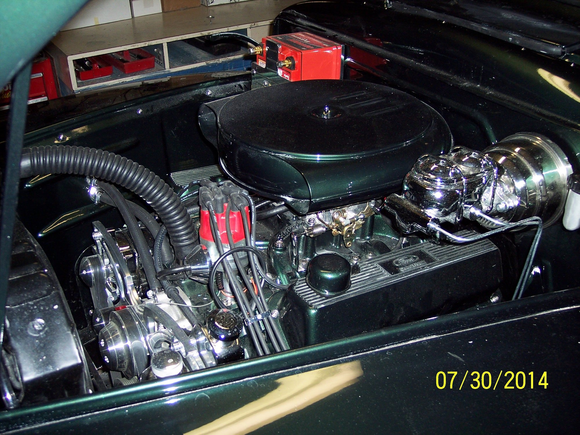

I also installed a 302 w/ AOD in my 49 F1. Used round mount, inexpensive, worked fine and was easy to install. I had to cut a corner off old mounts for clearance. They also offer similar tranny mount. I found a radiator perfect for conversion that fits without modifications. Fit in and retained upper air dam. Had to use a pusher fan, hardly ever runs. Can find supplier if you need it.
302 ready to go
Good luck

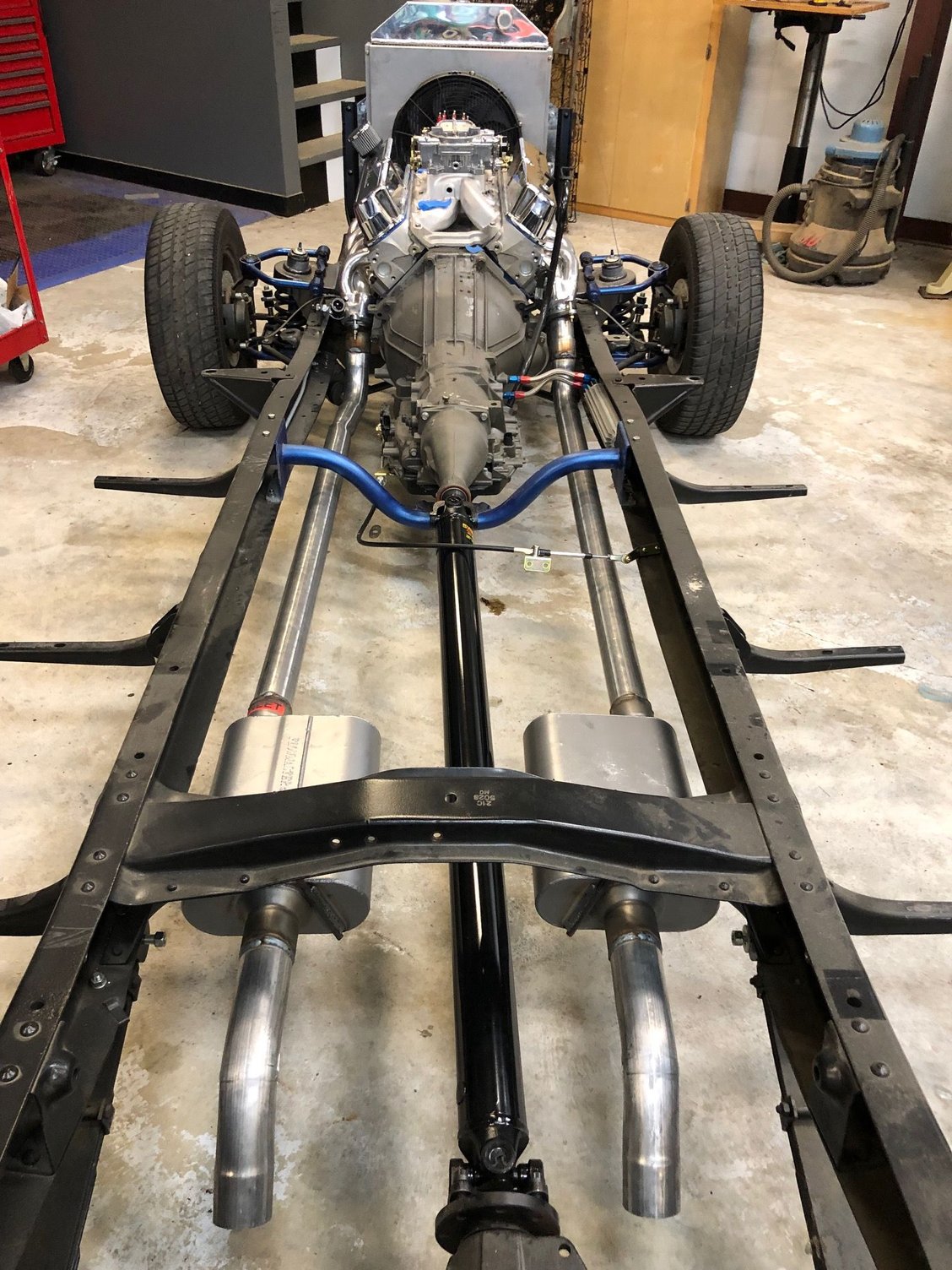

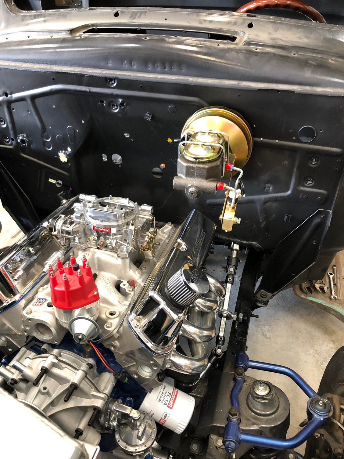

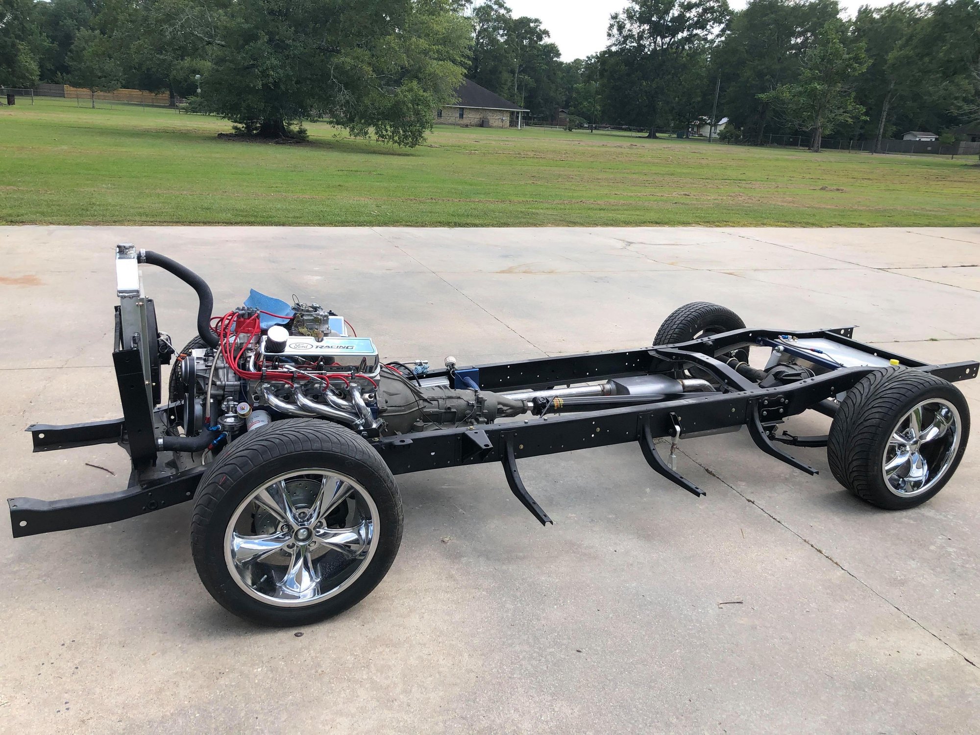

Mine is a 302 with 4r70w, mustang II, and 8.8. I had to do some floor modification to fit the trans as well as move the engine forward slightly. It’s kind of funny as mine is a 51 but I used a 48-50 cab because I like the smaller back window look better. Here are some pictures if it helps.

Great pictures! The chassis looks very nice. I think they will be very helpful. Where did you purchase your firewall mounted brake booster? Have you installed the pedal and sled for it. If so, what vehicle did you use as a donor? Any issues I should be aware of?
Old Oct 4, 2020 | 10:14 PM
tigerfan79's Avatar
tigerfan79
Joined: Jun 2012
Posts: 247
Likes: 12
From: Walker, LA
https://www.performanceonline.com/19...e-Booster-Kit/
The above link is what I used and at a good price. Hold out some money for the stand alone controller for the transmission. After everything was added it was around $700 from US Shift.
