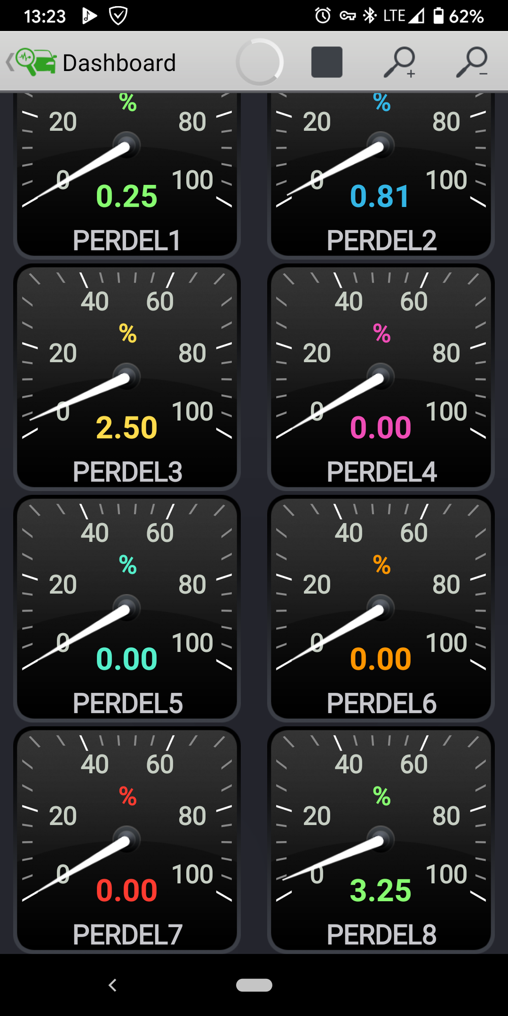

Here's another wrench in the works:

I think you are ok on the PERDEL readings - those are normal for the grey CPS, from what I've seen. Good to know your injectors are newer, and alliant brand, so the O-rings on them should be good quality as well.
