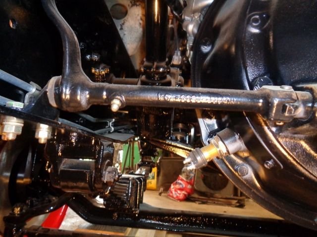

Steve, The '52 and earlier clutch linkage is totally different that the '56. here is a photo of mine.
The arm that is upright is connected to the pedal by an adjustable rod.
Thanks, Mark
