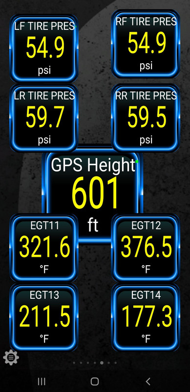

2016 F250 6.7L
275/65R20 E Rated Toyo AT2
Currently have 46k on the tires with most of the miles with 55 in all 4 corners and they are wearing fairly evenly across the tread width.
I pull a 6500 lbs landscape trailer around that has a 1000 lbs tongue weight 95% of the time. My front axle is 5k and the rear is 4k with the trailer connected. Only reason the rear is currently at 60 is for hauling mulch in the bed of the truck.

Originally Posted by dirthawg
2016 F250 6.7L
That is good to know that they are wearing evenly and you use the truck for hauling. With your tires at 55 psi, they have a load rating of about 2850 each. Your tires can effectively carry 11,400 lbs, well over the 10k GVWR on your truck. Right on!
One question I do have, do you notice a big difference while towing between 55 and 60 psi?
I don't notice any difference while towing the landscape trailer at either of those psi. 60 psi does make towing the 8k camper feel more solid.
I installed air bags earlier this year and even with 5psi in the bags the ride is slightly harsher unloaded than before the bags.
