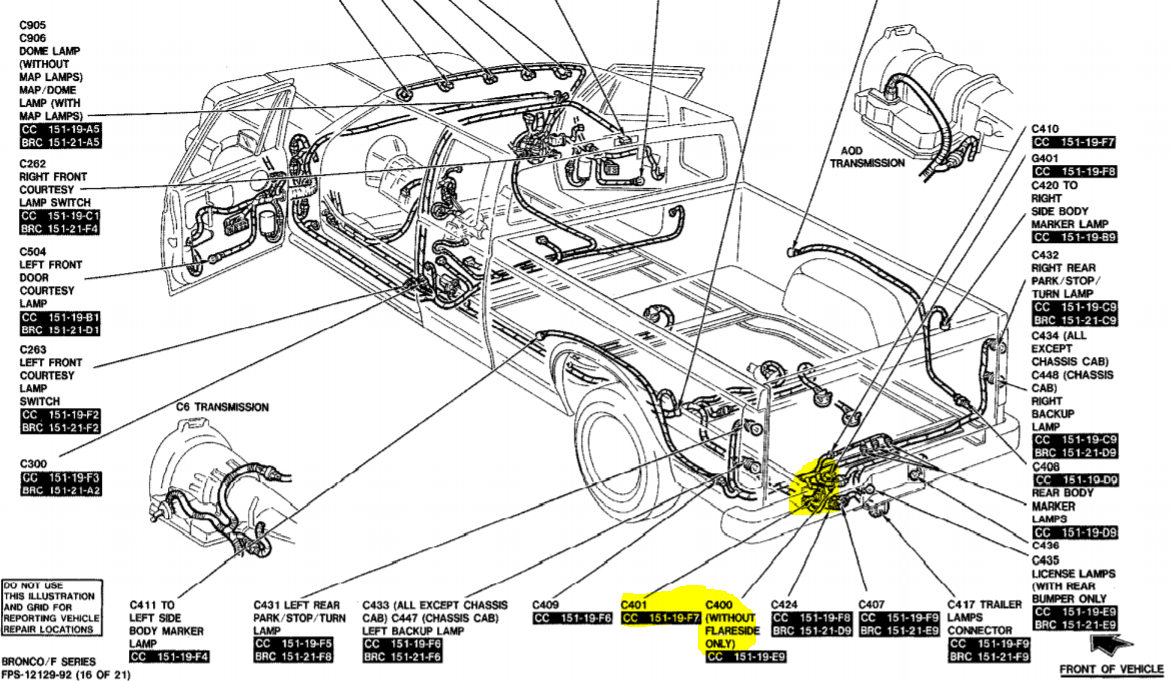

Looking over the wiring diagrams I would look for this splice S404, all the rear lights use this splice to provide a ground.
I would remove the taillight bulb and check for resistance between the black wire and a good ground, battery terminal if needed.
There is not a location diagram for splices but it says its near to C401 or C400 depending on bed style, I highlighted the location of these connectors.
