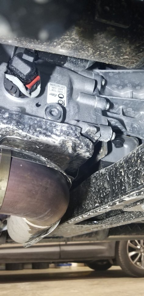

it is ULV ultra low viscosity transmission fluid. Use the part number that’s listed and get it through the dealer or a parts supplier.

Here is the fill port for 10r140 stating ULV.
