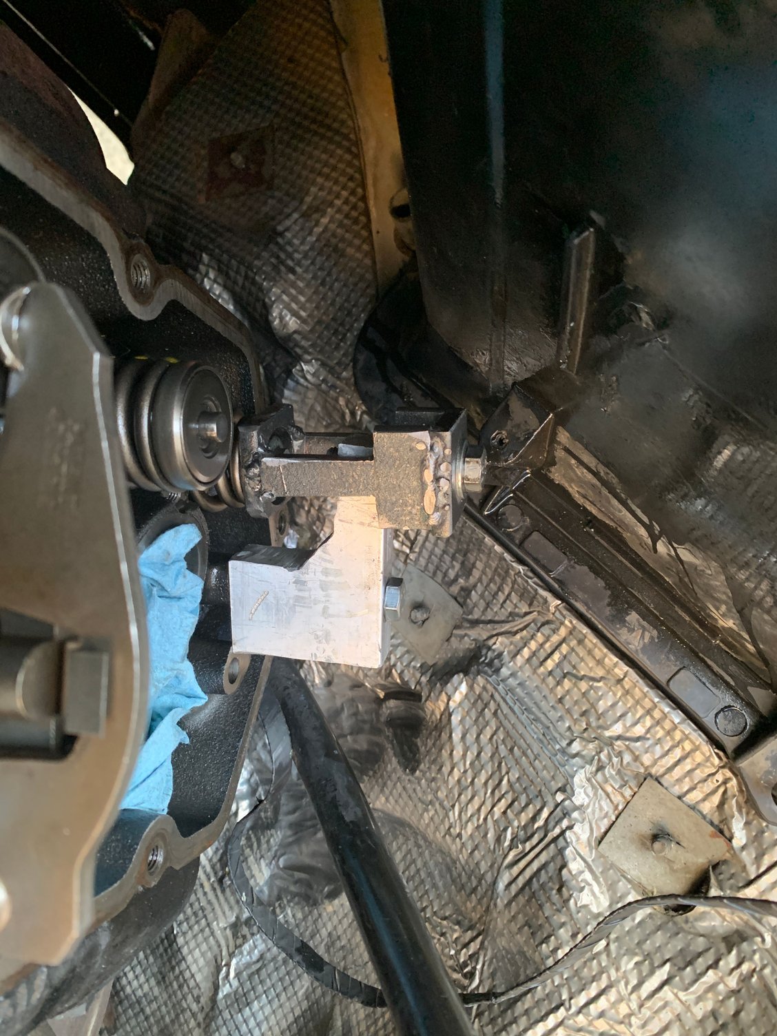

Forgot to get one tonight but here’s a picture of the completed tool, will be doing the other head tomorrow

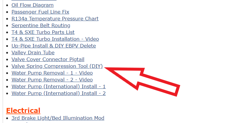

Well done sir! I have added this this to the 7.3L PSD Tech Folder.

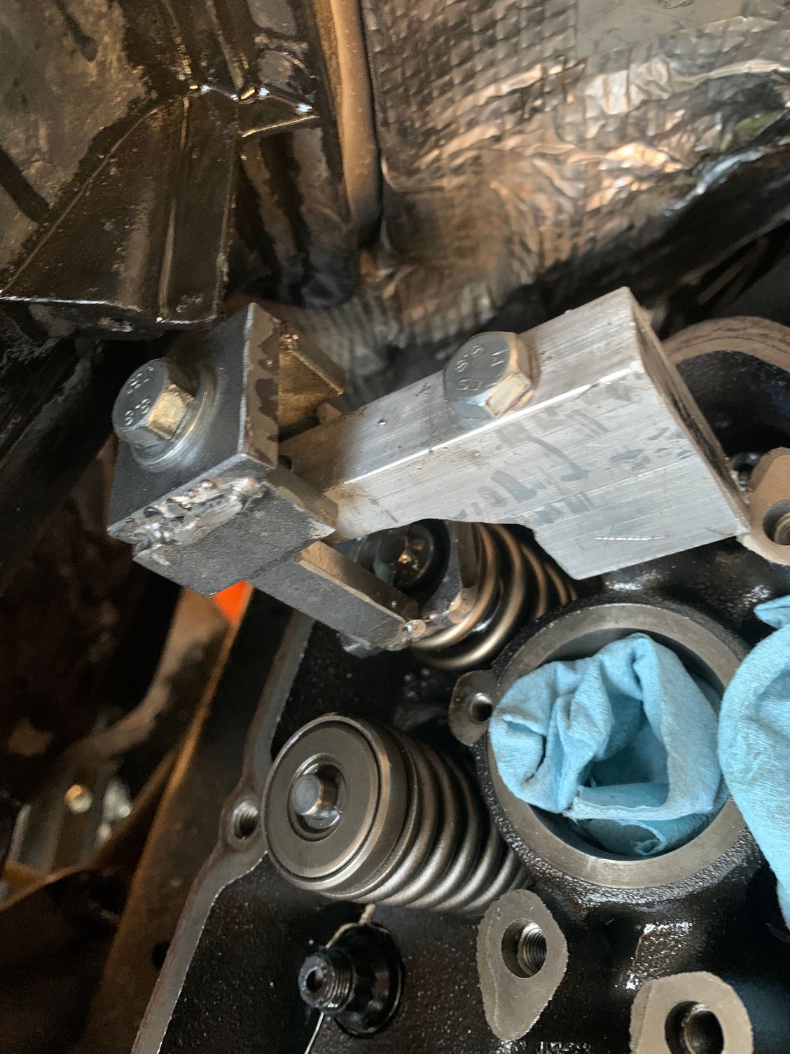

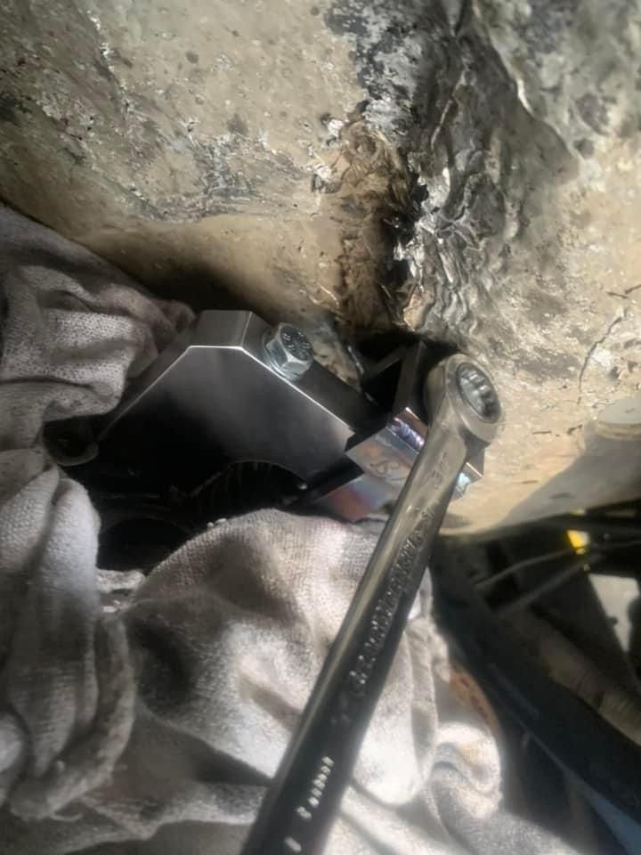

Here are some pics of it in action.

Nice work! Was that pic taken with the cylinder head still on the block?
Yes it was, you'll have to unbolt the motor mounts and jack up on the side you are working on for the rear cylinders.

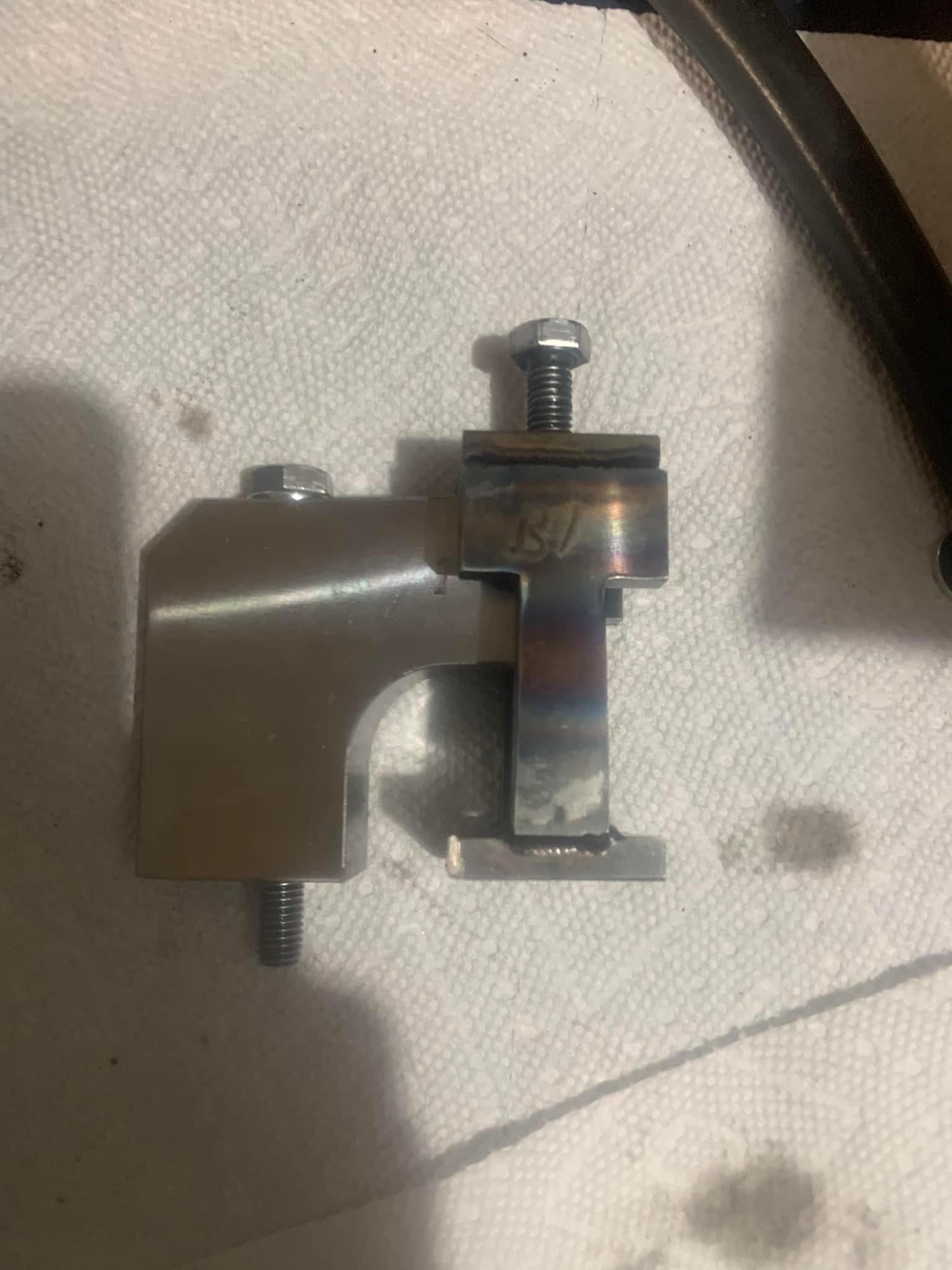

Here is a legit version of the tool
I can either rent out these or sell them if people are interested.
