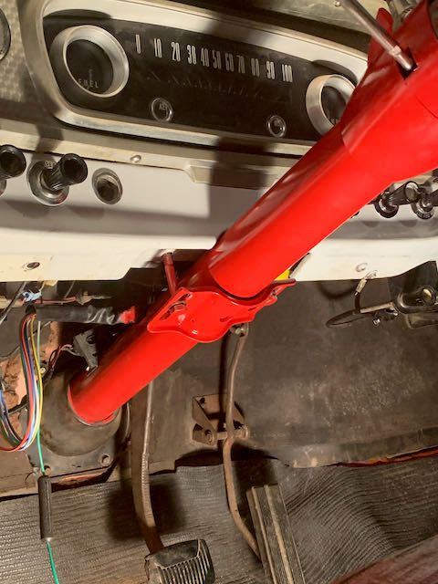

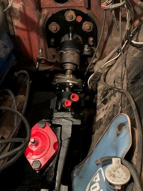

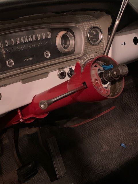

I will answer my own question. It fits pretty well as you can see from the pictures. I purchased the steering column from eBay. It had been refurbished. I had to sand it, prime it and then paint it. I think that it turned out pretty good. No cutting required. The bracket that bolts the steering column to the dash is different, so I had to purchase longer bolts that I painted as well. I am sure that there is way to remove the brackets and exchange them, but they are spot welded on and I didn't want to ruin the columns. After I posted this I looked closer at the Fortification.com article and it actually shows a steering column from a 1970 F100 from a truck with an automatic and power steering.

It looks good. I am more impressed you posted a question 5 months ago, got zero input, and figured it out anyway- kudos.
As you have found out the column itself is the same except for the saddle that bolts to the dash. You can buy aluminum spacers in just about any size - that would it make it look cleaner and more stable, but your solution should be safe and functional.
