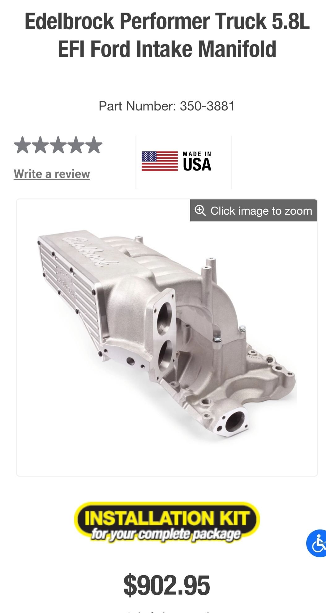

Ok got ya. I will look into what kind of intake to put on. You know of any good ones?
I think the only intake for the fuel injected 351 is the edelbrock truck intake part number 3881 but it is like 900 bucks.

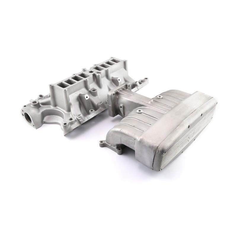

No it's not the only one by far, Trickflow has a bunch, Holley, and even Edelbrock has the Performer and Victor models, and then there is this one... https://www.ebay.com/itm/Speedmaster...EAAOSwXeteMwma
