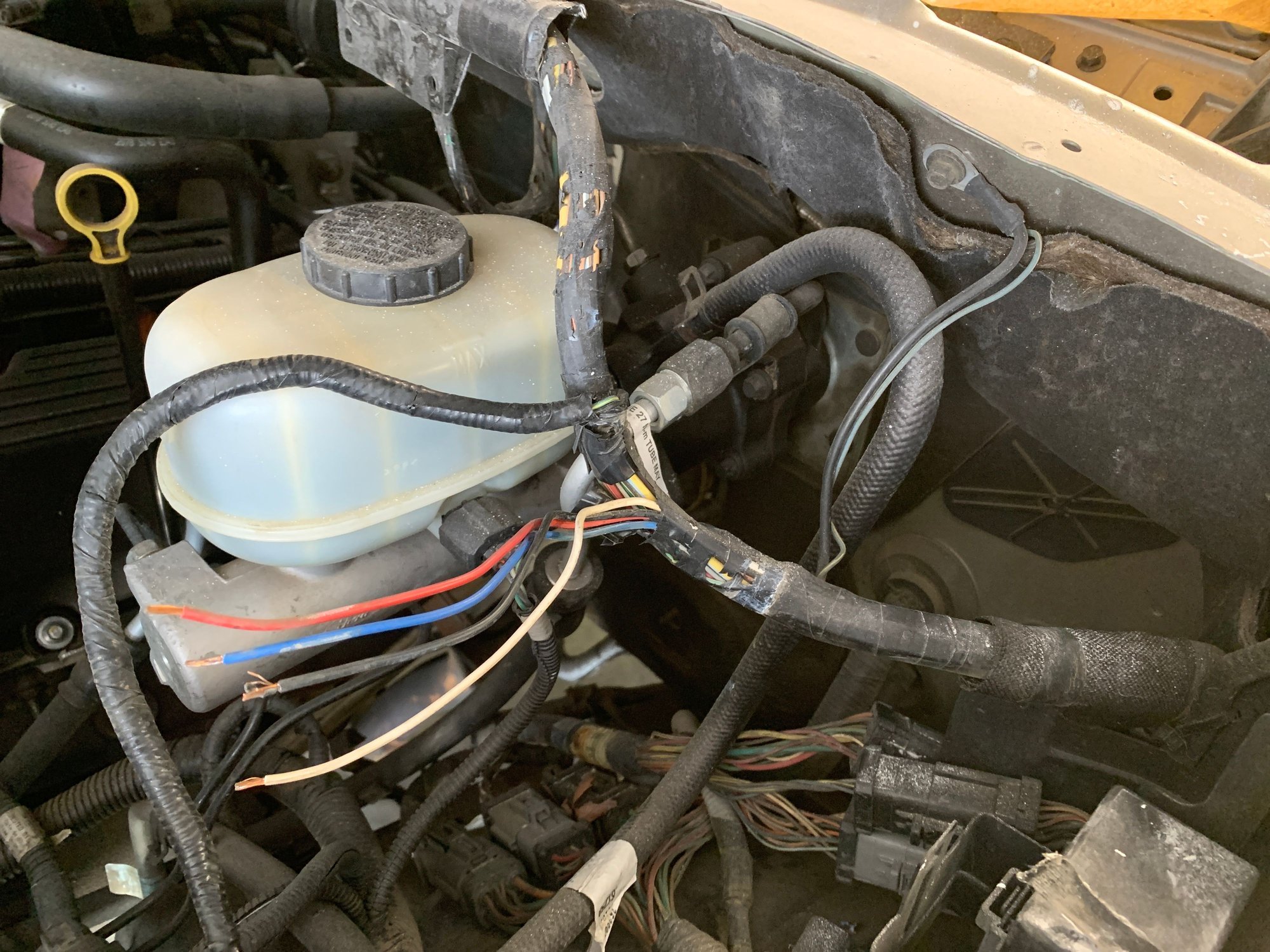

Can anyone tell me what these wires may have went to or if they were added or factory they are coming out of the harness in the left upper corner drivers side. No power to any of them with key on or lights on. No continuity to ground on any as well. 2002 f450 v10 4x4 with auto this truck is new to me and I am trying to clean it up thx
Red blue black and white

do you have upfitter switches? if so, they may be the pass thru wires, but usually they are not bundled with other wires like that, are shorter, and the ends are taped
look under your dash to see if there are the same four cut off wires inside.

Those are factory installed customer convienence wires, four wires pre-run through the firewall for you to use for any aftermarket accessories you want to install. Look around under the dash for the other ends of them.

Thanks there re 4 more under the dash continuity through each one problem solved
